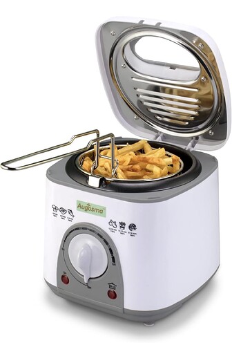

Hey everyone, I’m finally also getting started with waxing and came across a used mini deep fryer. It has a capacity of 1l and can be set to temp which I find convenient. Also if the chain would fit in the basket would be really cool. Does anyone have any concerns with this setup?
