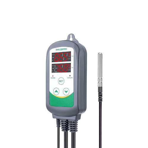

One can buy temperature controllers that work with cheap slow cookers and will prevent overheating. I’ve been happy with this one but I’m sure there are others that would work.
