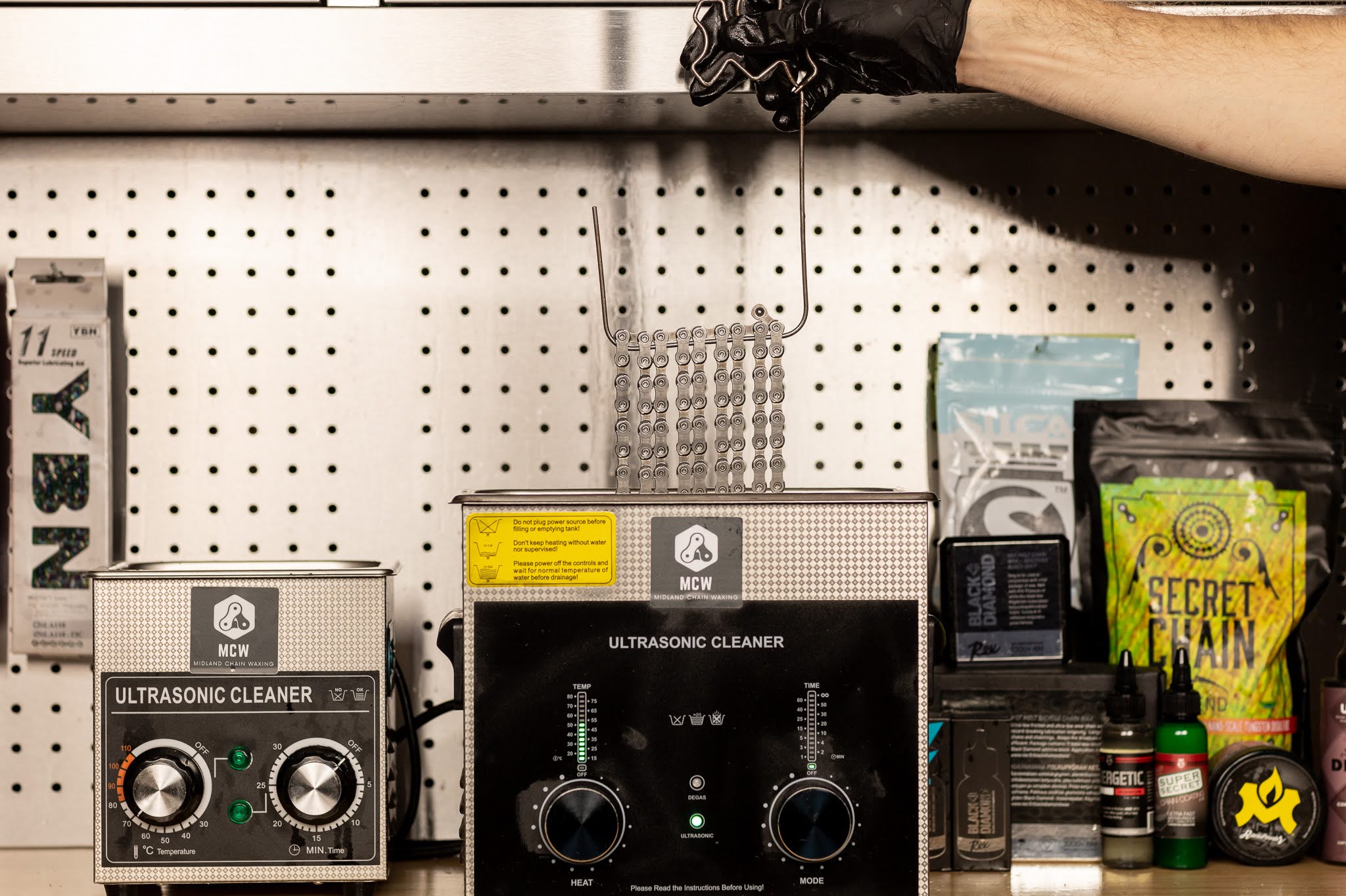

Ultrasonic
Molten Speed Wax maintains an excellent guide on cleaning chains with ultrasonic cleaners, and is recommended for step-by-step directions.
Ultrasonic cleaners have the benefits of speed and the use of less expensive and less noxious water-based solutions. Because it is not recommended to use flammable solvents in ultrasonic cleaners, they may not be nearly as efficient at removing factory grease as the turpentine/methylated spirit method. Because of this, best practice is to use the turp/spirit method for factory grease removal, and the ultrasonic cleaner for subsequent cleaning (though cleaning is often rarely required for a waxed chain ridden in relatively clean conditions). That said, the ultrasonic cleaner will remove factory grease reasonably well if having perfect wax performance for the first wax cycle is not critically important.
Care should be taken in the selection of water-based cleaning solutions. Some, such as standard (non-HD) Simple Green and many citrus-based chain cleaners are quite acidic. The acidity - when combined with the cavitation from an ultrasonic cleaner - can increase risk of hydrogen embrittlement. Alkaline degreasers, such as most household dish soaps, should be safe when diluted according to the label. Still, it is a best practice for all degreasers to rinse thoroughly after cleaning.
