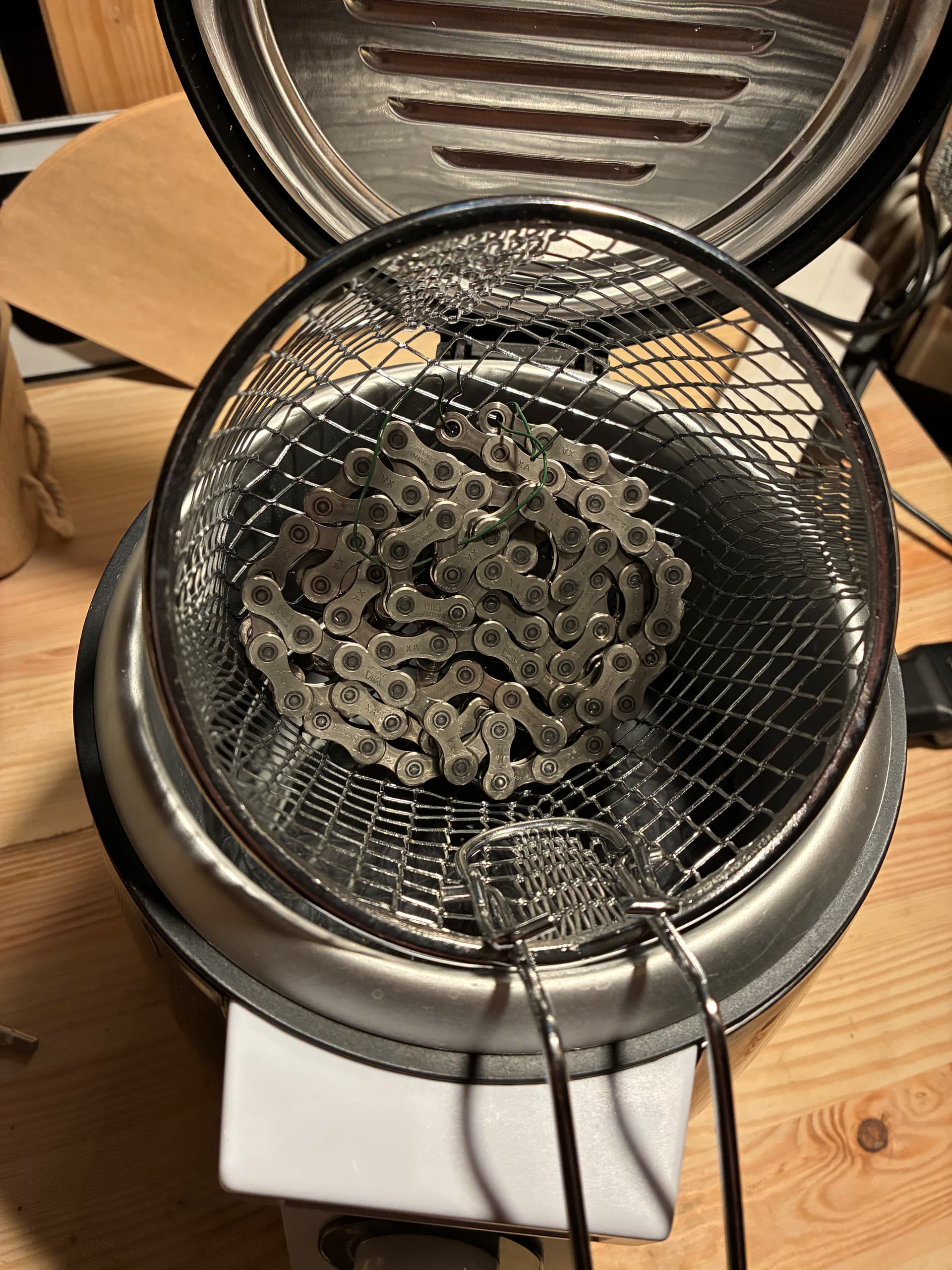

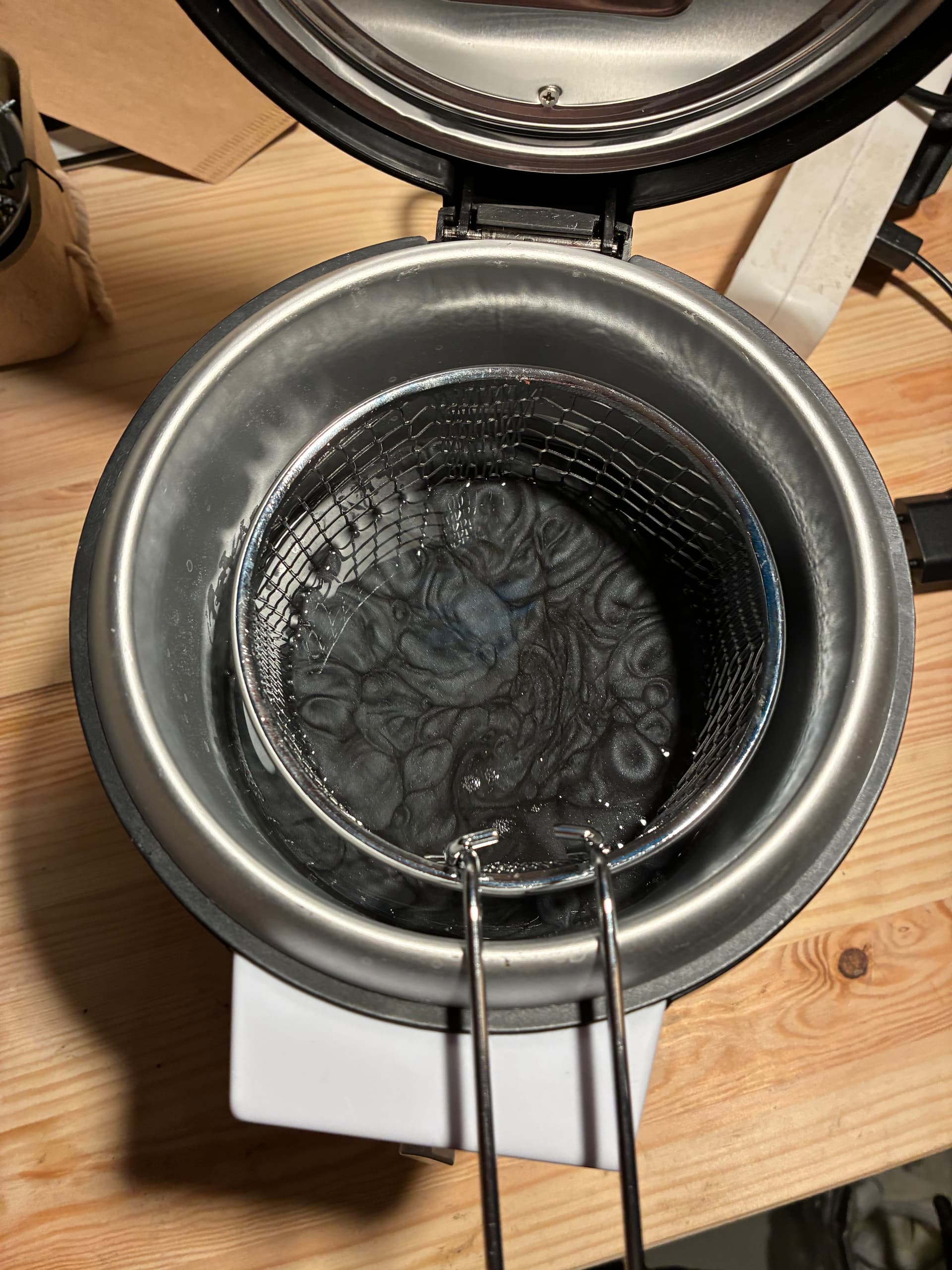

Soooooo, I guess I‘m frying chains now. The wax melter I bought was shit quality so I went and got another mini fryer. Actually works a charm. It melts the wax to around 90 C in 5ish minutes and seems to keep the temperature quite steadily. Having the chain in the basket was quite useful aswell.

Nice one. How’d you shake it then? Do you use some kind of poker?
You can just lift and shake the basket itself, no extra tools needed. (I don’t understand the whole swisher religion either, I just tilt my double boiler can by lifting one side a little bit a couple of times to shake things around.)
Swishing is all about making sure that any air bubbles between surfaces in contact are displaced so that the melted wax covers all of the surfaces in contact. I’d say it works given the air bubbles coming to the surface of the melted wax as I swish each chain. I think the swishing also helps to displace any grit still on the chain.
I’ve not measured the energy I’ve expended by “worshipping" the gods of swishing in a swishing session, but there’s no doubt the energy required is right up there with lifting a can of pop or beer a couple of times to drink the contents or maybe rolling over in bed once or twice while sleeping. In the worst case scenario, that energy needed to swish a chain in a wax pot might skyrocket to the level of the energy required to hold a phone and play a game of sudoku.
As @yoanna_yo said, I just use the basket to shake it. I see plenty of bubbles doing this so I guess it works. I threaded the chain onto some thread to be able to hang the chain to free up the basket for more chains. Maybe next time I’ll just put multiple chains in at once…
