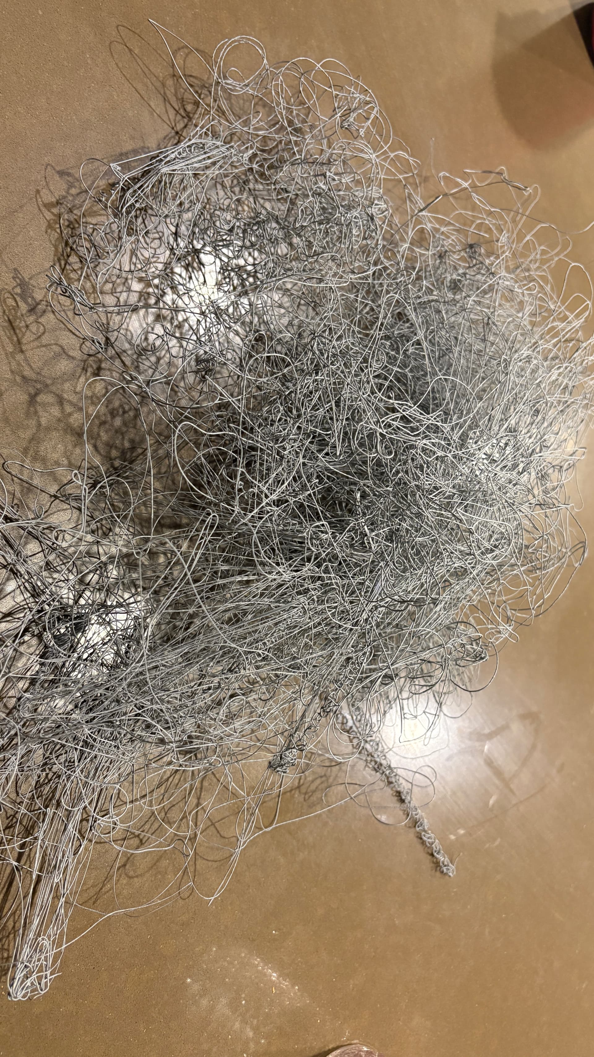

Note to self: Don’t move the printer without recalibrating.
It thinks this is a dummy fork steerer:
Ahhh, learning curves…
Turns out that bird’s nest ^^ was actually just a poor decision on my part with regard to print orientation! Dummy fork reprint - in a way more logical orientation - was successful :ok_hand:

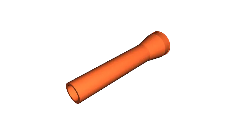

I chose to print this one, in part because it was quicker and more simple, but also because most others just seem to be way over-engineered. This one will hold a 1.5” bearing when inserted from beneath the headset using the stem clamp to hold it in place:

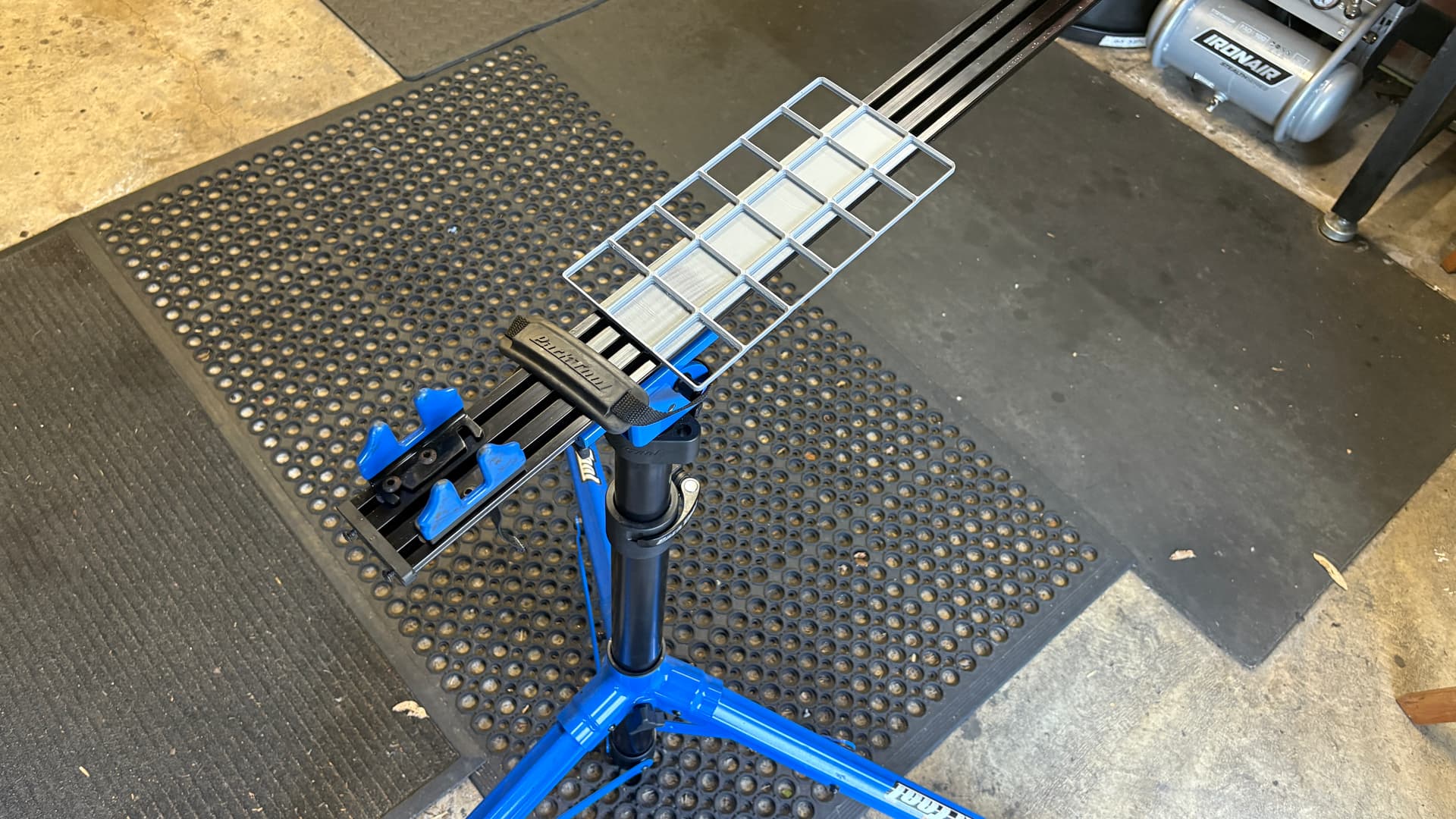

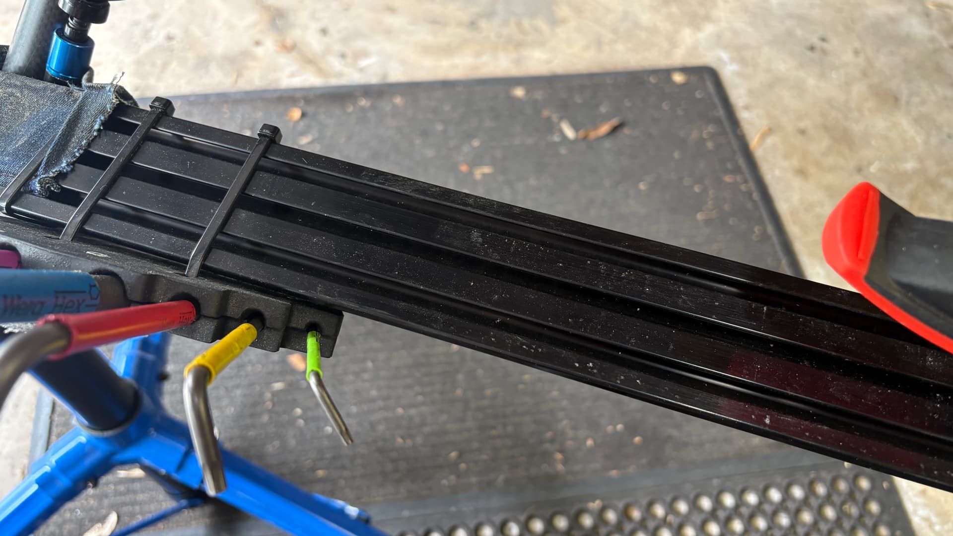

Whilst I’m waiting for the print to finish on a parts tray & tool holder for my bench mount stand, I’m looking for help and/or advice on how to find or create two other tools for my Park PRS 22.2 stand.
Firstly, I would like to mount my Wera L-keys in something like @Chris_Heerschap’s Wera hex key tray, but with T-shaped tags on the back of it that will hook into the grooves on the Park stand (see pic below) when laid flat to allow me to slide it along and to prevent it slipping off.
Secondly, I’d like a parts tray (perhaps like this) with the same T-shaped tags to follow the same thinking.
How would I go about adding those tags to the back of these items to make this work?

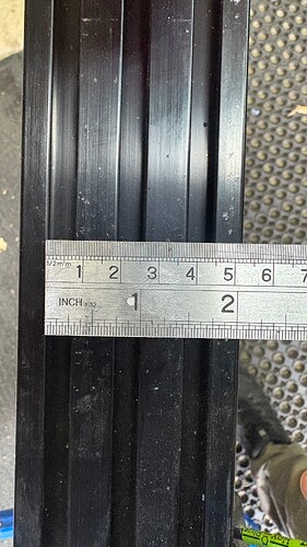

Can you measure the spacing for the rails?
  • 60mm overall width
  • 45mm from the outer edge of the channel on one side to the outer edge of the channel on the other side (as per pic below)
  • ~37.5mm from the centre of the channel on one side to the centre of the channel on the other side

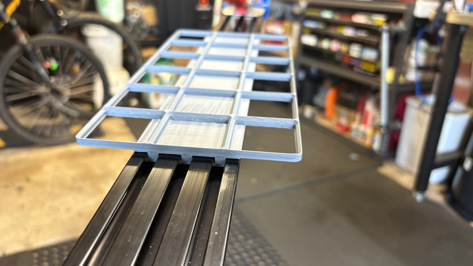

can you test print this: https://drive.google.com/file/d/19aAUY_ZHEcaN0nmjTYN_S9dxwrfdrDbE/view?usp=sharing should be quick
Almost too perfect - I’d call that an interference fit! Exactly the right dimensions, but unable to slide once installed (almost had to pry it out).
0.25mm off of either side (if that), plus a little protrusion on either side of each rail to retain it in the channels and that would be spot-on, though.
Don’t have any more time to faff with it today, don’t quite understand what needs to change though
All good - not expecting to get a solution - although if I do get one that would be amazing, and I’d gladly pay for the time!

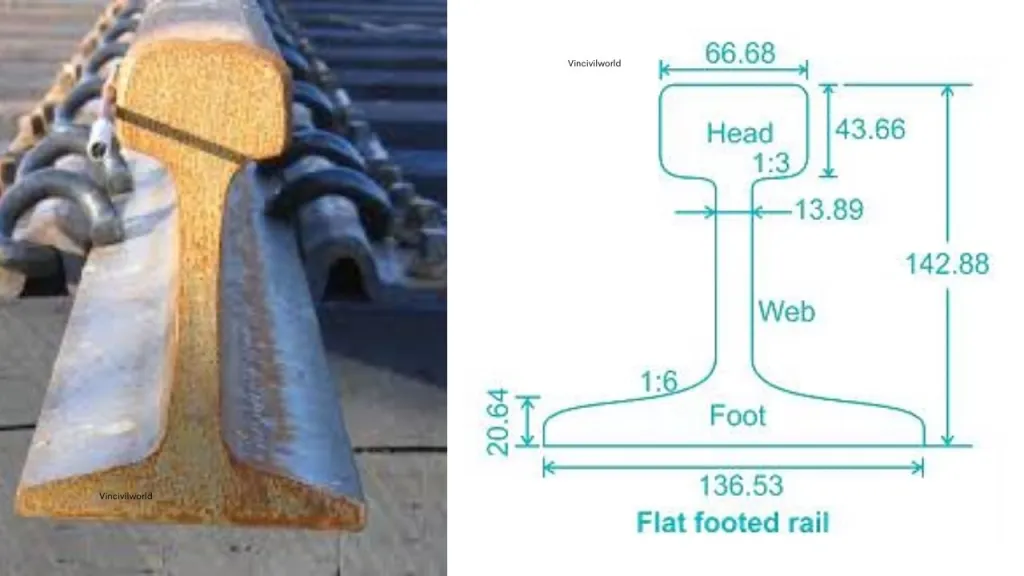

Taking this train rail image & drawing as a reference, my thinking is that the underside of the Wera hex key tray and the small parts tray would have a rail (or 2) on the bottom of them, such that the ‘head’ would be the hex tray / parts tray and the ‘foot’ would slot into the workstand rail from the end:
I don’t necessarily need either item to be immediately removable (in fact I’d prefer they’re not immediately removable), but I do want both of them to be able to slide along the rails of the stand.
Yeah, but I don’t quite understand what is fouling as it is now, plus I don’t know what the dimensions are of the slots underneath to make it slide in and stay retained

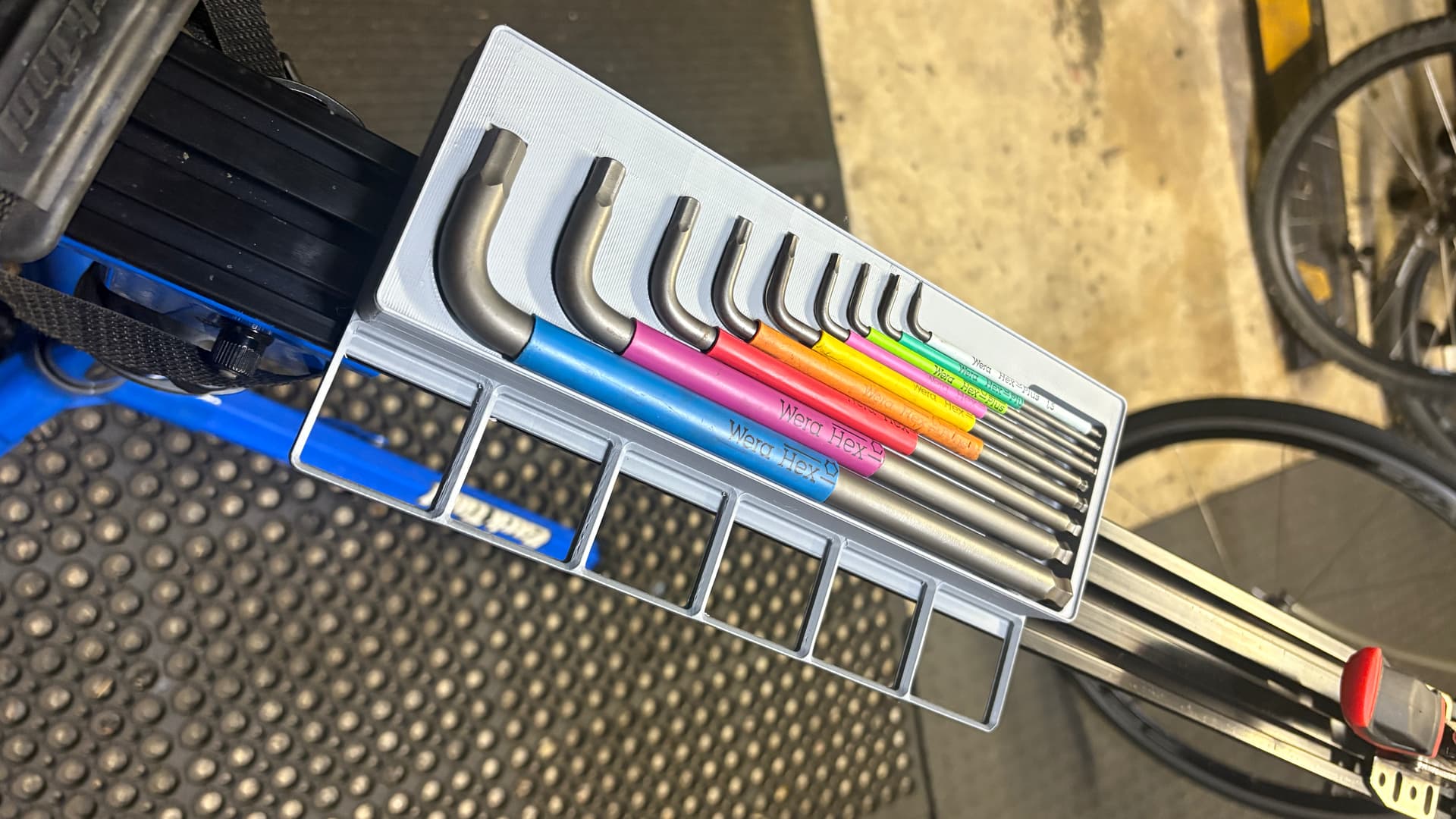

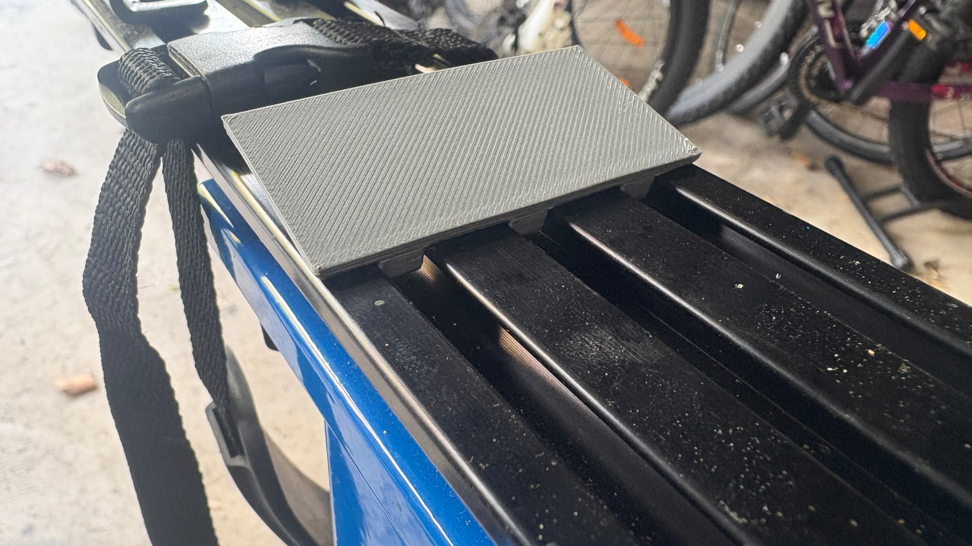

In the meantime, here’s what @OffbondageFanboy produced for me, and a second pic with a Gridfinity Wera hex key holder sat on it (I’m printing two 1x3 Gridfinity trays tomorrow to take up the other slots and fulfil my parts bin needs):

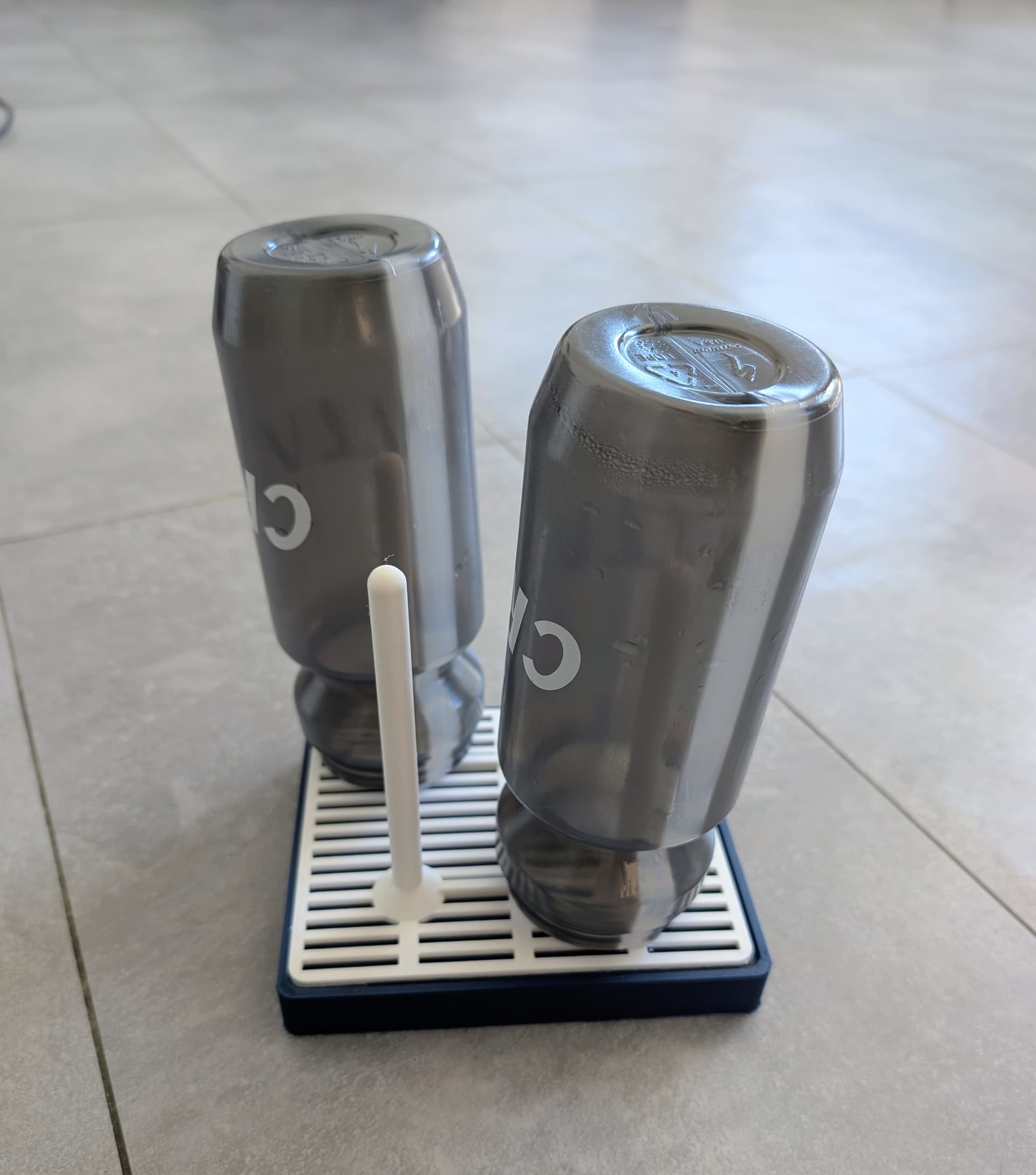

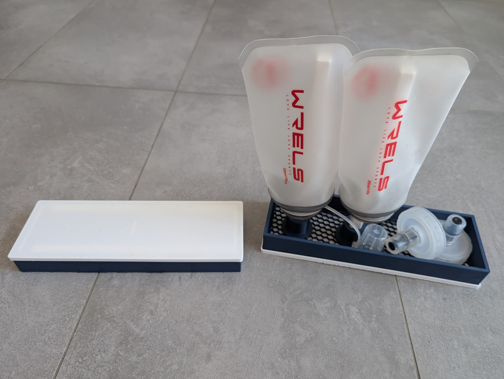

My latest cycling related prints, flask and bottle drying racks
Here is a bladder drying rack I made that works well for fold-top bladders . Hydration Bladder drying rack by BJKeane3 | Download free STL model | Printables.com
