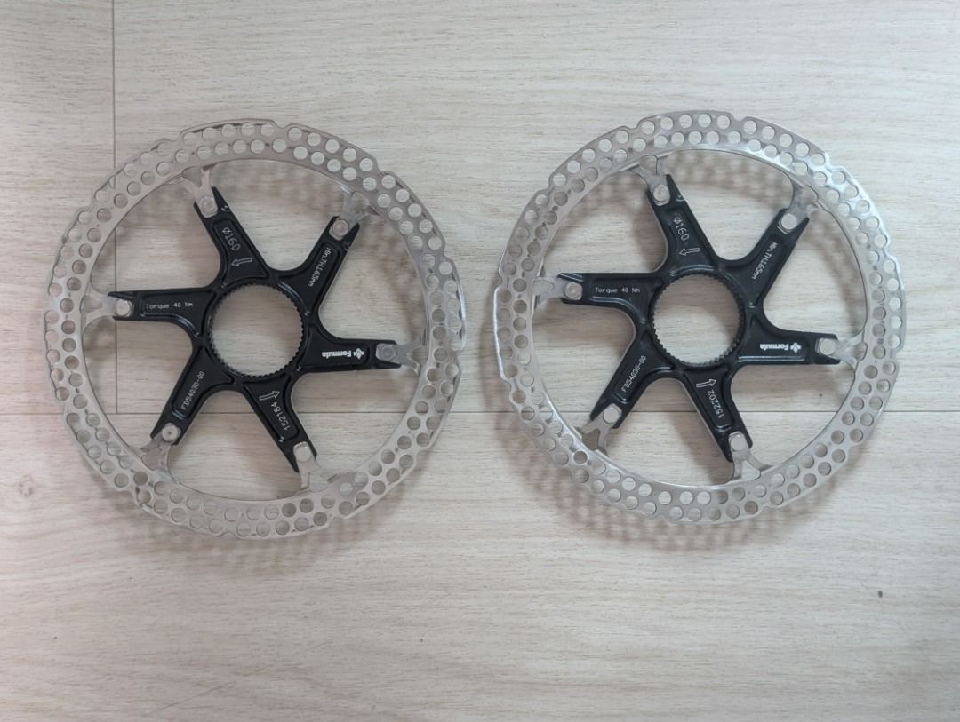

They look pretty cool and apparently stop faster, but at double the cost.
Otherwise I’d just go for the Shimano, I usually just get the Ultegra tier - the Dura Ace have a black coating that mostly looks cool and may dissipate heat faster, and then there’s the 105 tier without the cooling fins. They should weigh mostly the same.
Having quickly read the article, I don’t think that’s strictly correct. I’d say for the same amount of lever pressure they generate more braking power. The reason that this difference matters is that in the case of a bike your braking is usually grip limited and not braking power limited. This means that you’ll lock up your tires long before the peak braking power becomes relevant. For someone who struggles (for whatever reason) to generate adequate pressure at the lever more braking power can definitely be relevant, but thankfully that’s not the case for me.
Plus as you said, the price tag is a bit of a turn off.
It is a very interesting approach though of making sure that the amount of material is consistent across the circumferences of the rotor to avoid hot spots. Seems like it makes sense intuitively.
