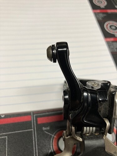

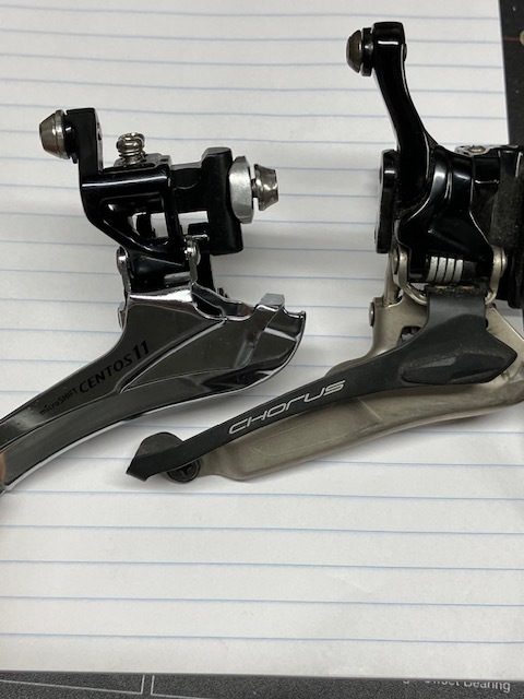

In case u haven’t considered this - be attentive to the F Der to tire or fender clearance when the F der is in the big ring. Campy 12s F der has a fairly long lever arm to which the cable anchors. If it’s an issue some workarounds are to use a Sram Wide f der clamp, modified with some filing to accept the campy der, which set the der a bit further outbound (I haven’t tried that one). The thinking being that the chain line stays the same but in the big ring the cage won’t have to go as far outbound vis a vis the der body and therefore the lever arm gets less close to the tire. or Microshifft makes some f ders that have short lever arms. I use one. It’s not as good as the campy but it works. It depends I suppose on how particular u are about the trim function.

It’s also worth remembering that Campy 12s FDs, at least the mech FDs, have two different positions for anchoring the cable. That’s specifically to address possible interference with the rear tire.

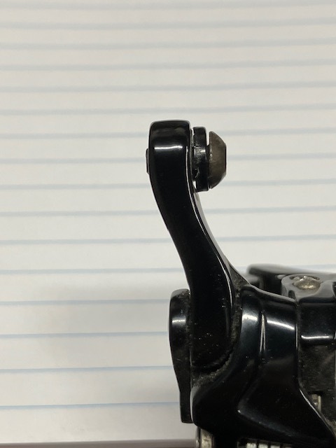

Oh yes. I forgot about that! For those who are interested - the Campy cable anchor bolt is a bit on the beefy side. If you just need a hair extra clearance (say the derailleur is just pressing up against your fender, a button head will do, or as mentioned you can move the cable anchor point forward. Both depicted below. For comparison, also a pic of the microshift derailleur I mentioned.

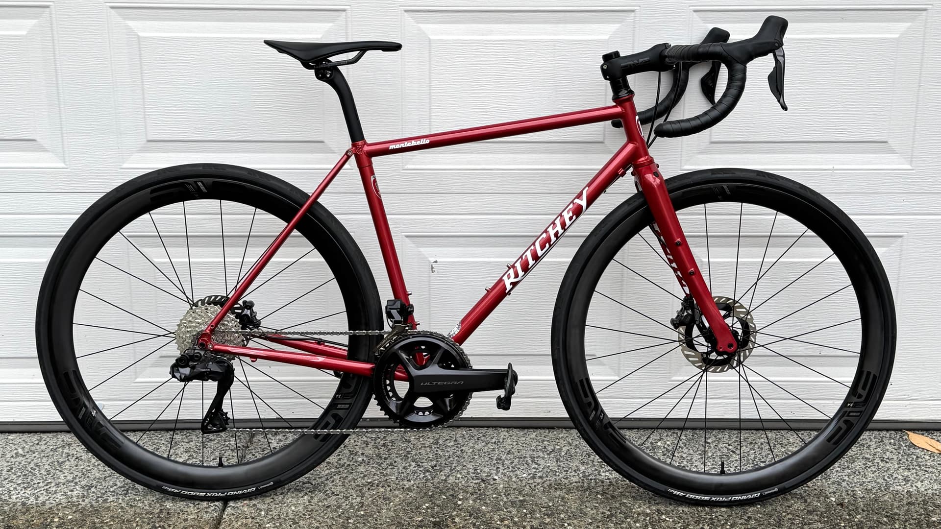

Last month I built up a Montebello with Ultegra 12sp wireless. It’s a joy to ride and is everything I hoped a Ritchey steel frame endurance bike would be.
I’ve only owned one other steel bike (All-City Space Horse built up with Ultegra 11sp hydro). The Ritchey is head and shoulders (and knees and toes) above the Space Horse in terms of ride quality, handling, and overall fun.

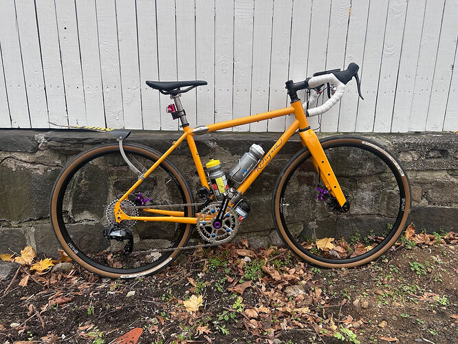

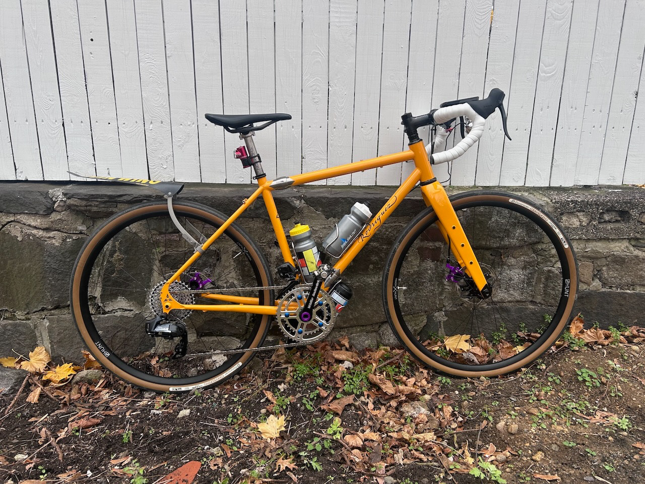

So many options…like endless options. I just built up this Rodriguez, a customized “Phinney Ridge” model. The tubing is their in-house steel which is kind of a version of True Temper OS2 from what I understand, TIG-welded. S&S couplers. I am using SRAM eTap here, with Paul Clampers mechanical disc brakes, but it can also be built with any mechanical drivetrain. I designed my with a high-ish bottom bracket ( BB drop of 58mm) so I can run it with 28 or 30mm 650b tires and not have my cranks hit the pavement
