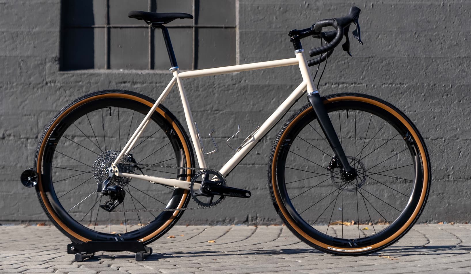

I’d be happy to offer a 20% Escape Member Discount on one of my US Made Pine Rasa Framesets if you’re interested. In my very biased opinion, It’s one of the best lightweight steel endurance/allroad frames available. Frame weight for the 54cm is 1712g (painted, without bolts, axle, and inserts) which i am incredibly happy with. The Allied fork I use is also much lighter than most at 320g (uncut) bringing the frameset weight to 2023g
