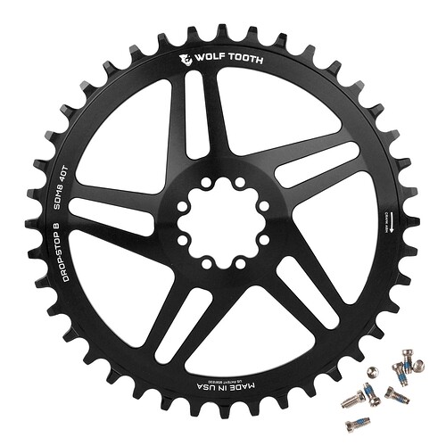

Now that I have swapped my chainring from 40 to 38T, https://community.escapecollective.com/t/sram-xplr-chainring-replacement/5519
I find myself wanting a smaller chainring still, at least a 36T for when I’m touring with panniers and big hills.
As far as I can see, SRAM don’t seem to make an 8 bolt direct mount, road/gravel 1x chainring smaller than the 38T I now have??
I’m hoping someone can point me at the smaller ones I’ve missed, or else give me some logical reason why this is the case. They make smaller spider-mounted chainrings, but not direct mount???
WTF??
Check out the Wolftooth offerings.
Yep - they are on my options list. I’ve used their (spider-mount) rings on my previous bike.
I’m just dumbstruck that SRAM make 36T spider-mount rings, but don’t make direct mount smaller than 38T, especially since direct mount virtually eliminates any physical restriction on ring size.
It just seems bizarre - to the point that I wonder if I’m missing something! :man_shrugging:
Alugear make 8 bolt rings with various offsets from 26T up. SRAM and Shimano don’t seem to think anyone should be able to have low gears on anything except MTBs…
I’m actually torn between replacing the direct mount ring with a spider so I can then have a 36T and a 40T and easily swap them without needing a 54Nm (and more when undoing it) torque wrench!
I’m just annoyed that that will cost ~$450 for the 3 components v’s ~$110 for one more direct mount ring.
Humph.
Maybe I’ll wait and get a Garbaruk 10-52T cassette instead.
