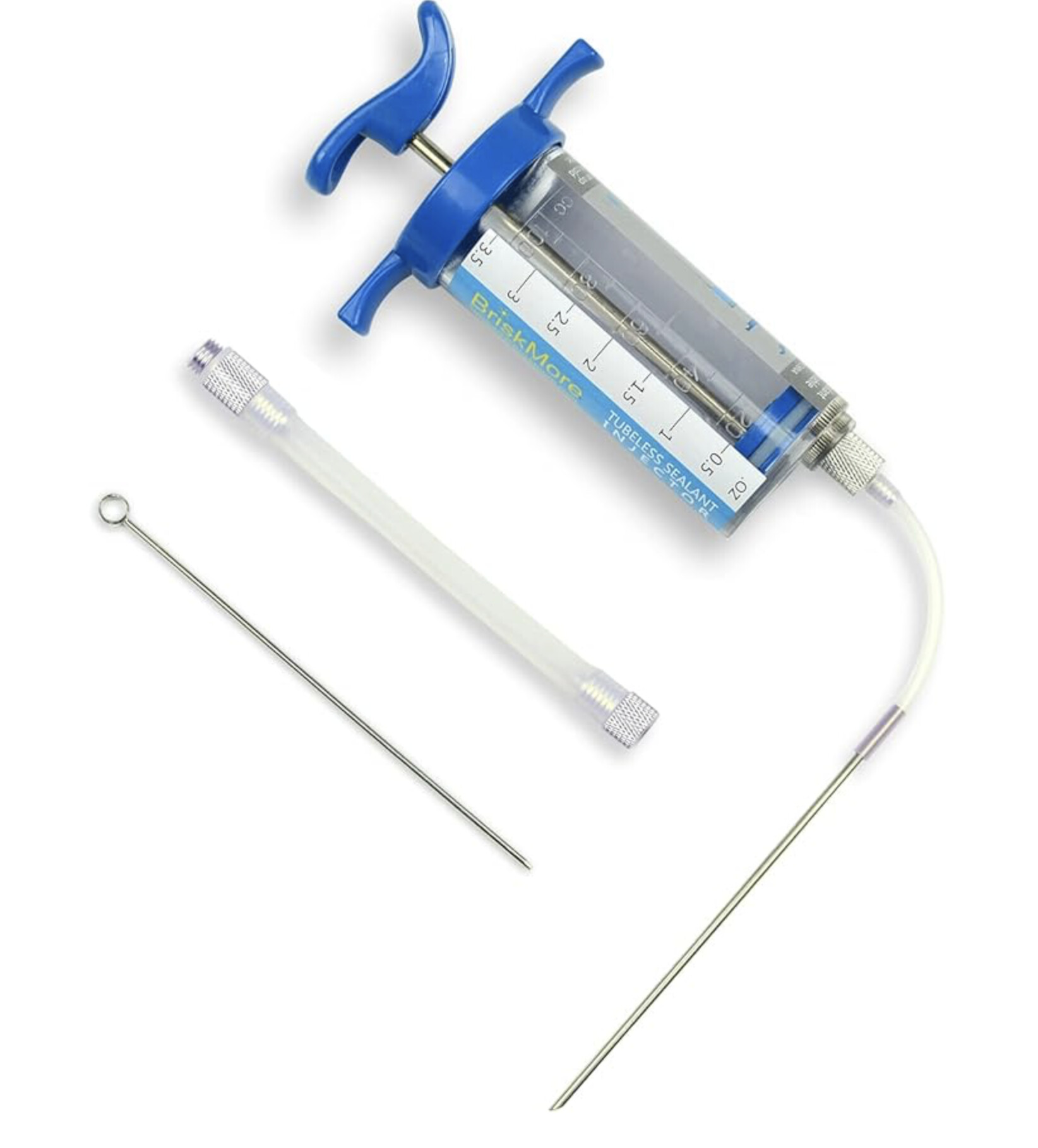

I bought this on Amazon. There are a lot of versions of this on Amazon. I use the clear tube–one intend attached to the injector, the other screwed on to the valve stem–to put sealant in my tires. I use Fillmore valve stems, so I’m not really worried about clogging issues. It works well and doesn’t make a mess.

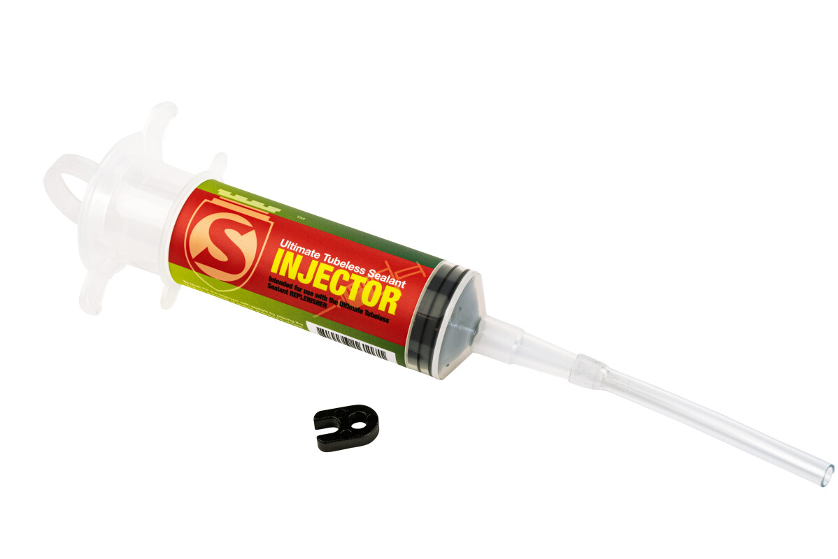

I have the old Silca sealant injector and other than the plastic hose coming loose from the syringe in the beginning, I haven’t had any issue injecting sealant with the Fillmore valves.

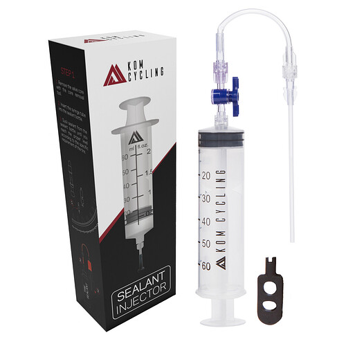

On my other bikes with removable valve core, I use a KOM cycling tubeless injector.

I use a KOM Cycling injector or the Orange Seal tube applicator.

Hmmm - that looks very much like the Park injector, except that the Amazon one in the picture has steel bits. I wonder if those are also compatible with Park (the plastic tube of mine has failed).
