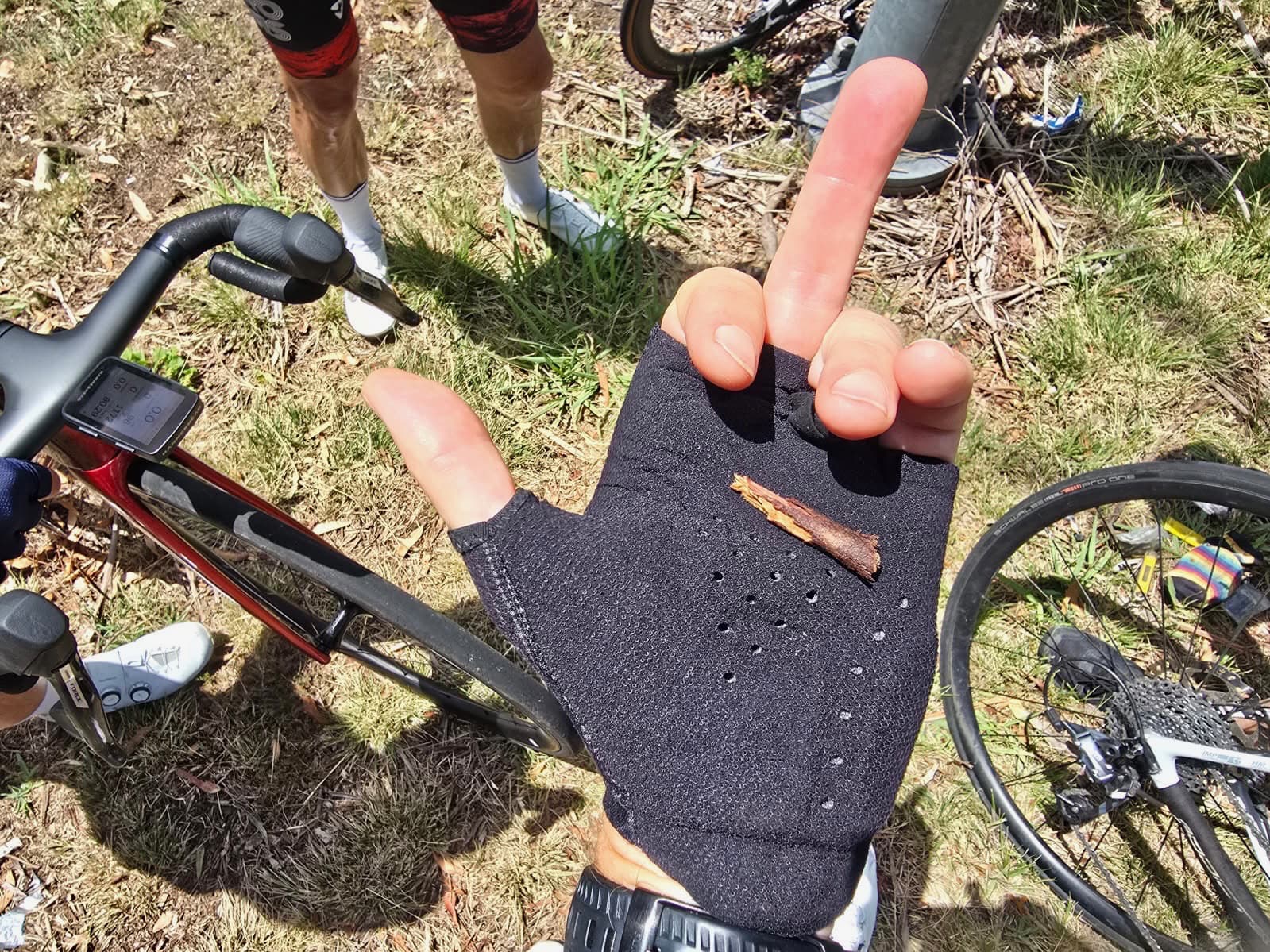

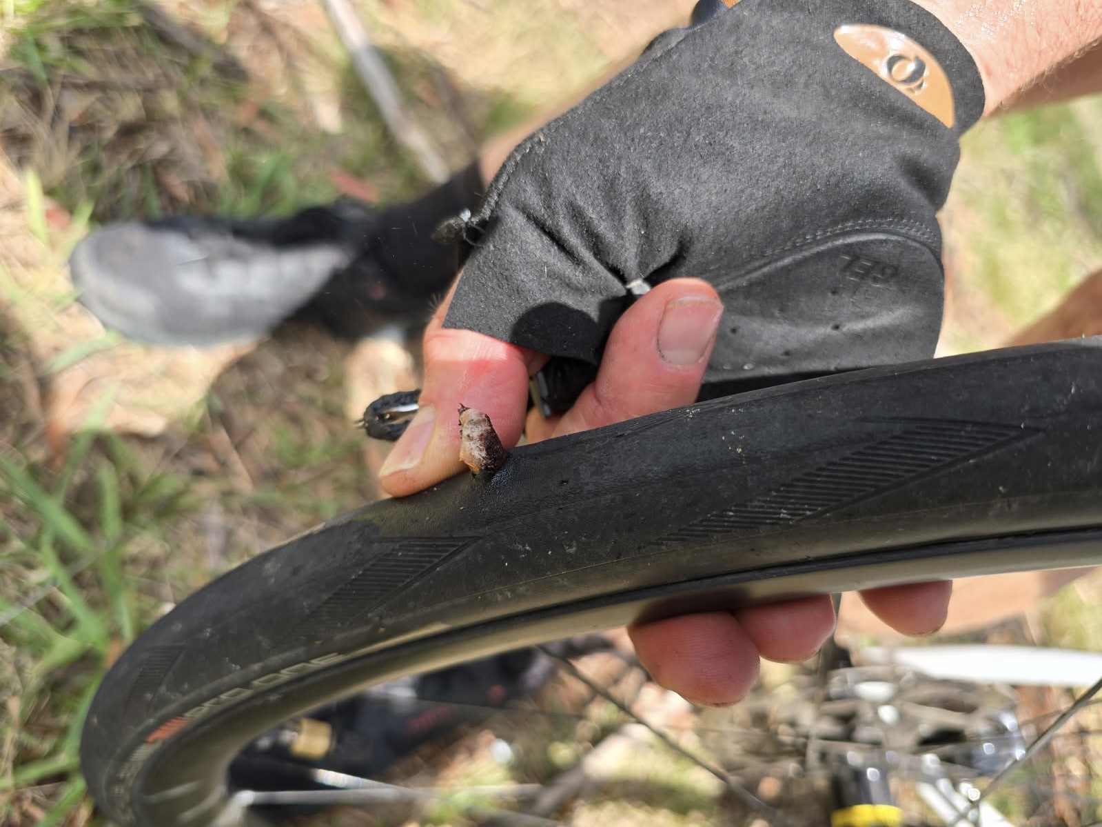

Pfft! I see your small nail and raise you. :wink:
I did post this on discord at the time.The stick was so long i was worried it had pierced the rim tape.
Admittedly this took two plugs to seal, but I still made it ~15kms home after this, including stopping for lunch.

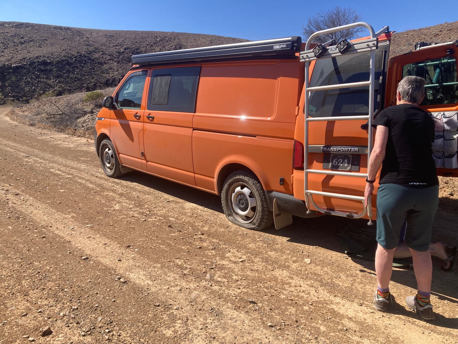

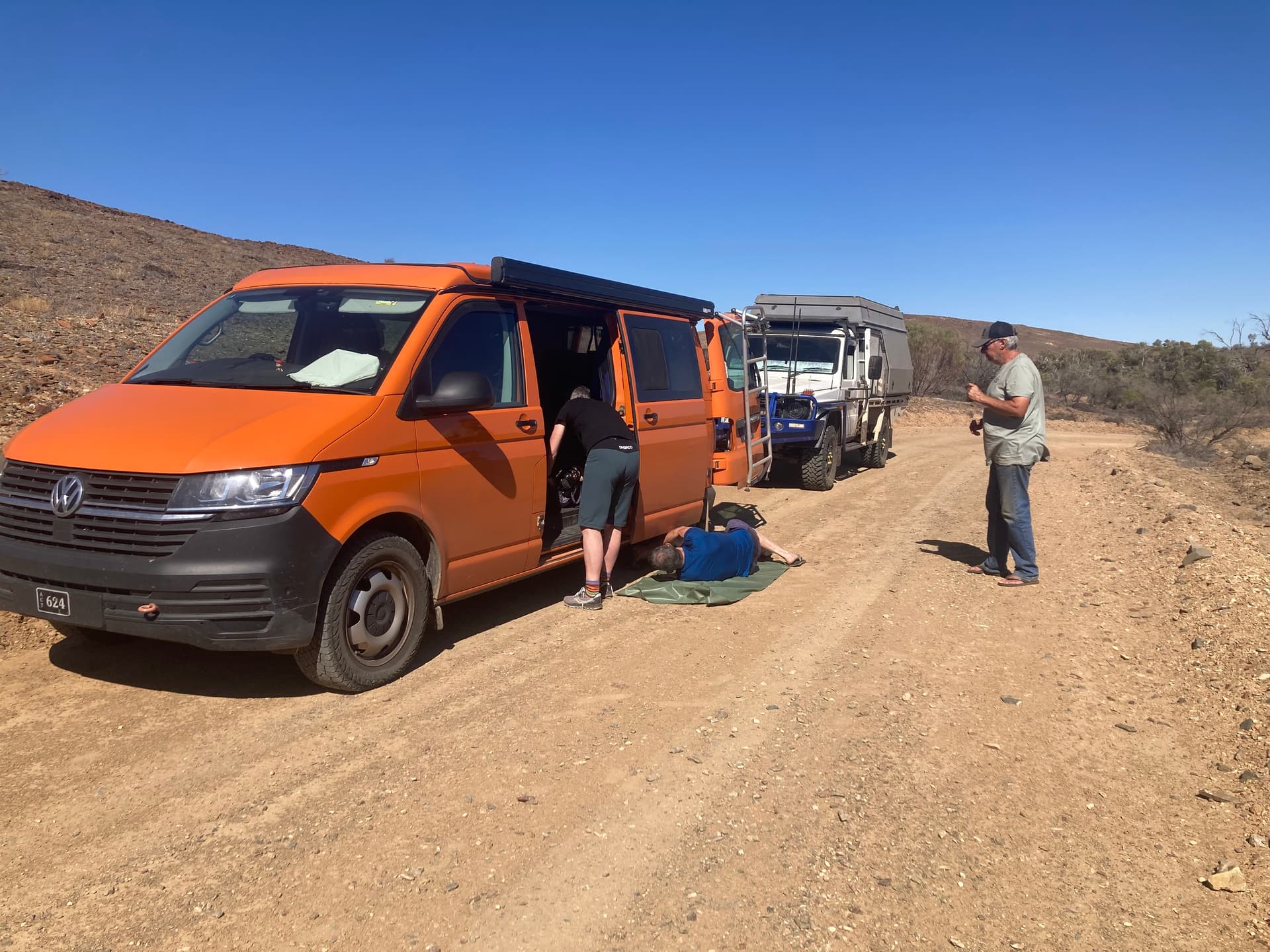

We run tubeless in our van too. I got to use our tyre plugger today out on a remote road near the Flinders Rangers. For a while I was kicking myself for not having followed the rule of familiarising oneself with repair tools before one needs them, as has been discussed recently here or in Discord. I bought a much better tyre plugger in 2021 but haven’t looked at it since then - it’s not just a basic bacon strip skewer. So it took about as long to read the instructions and work out how to use this plugger as it took to use it - imagine my delight when it worked and the tyre is still up now after ~200kms of very rough roads. :crossed_fingers:
