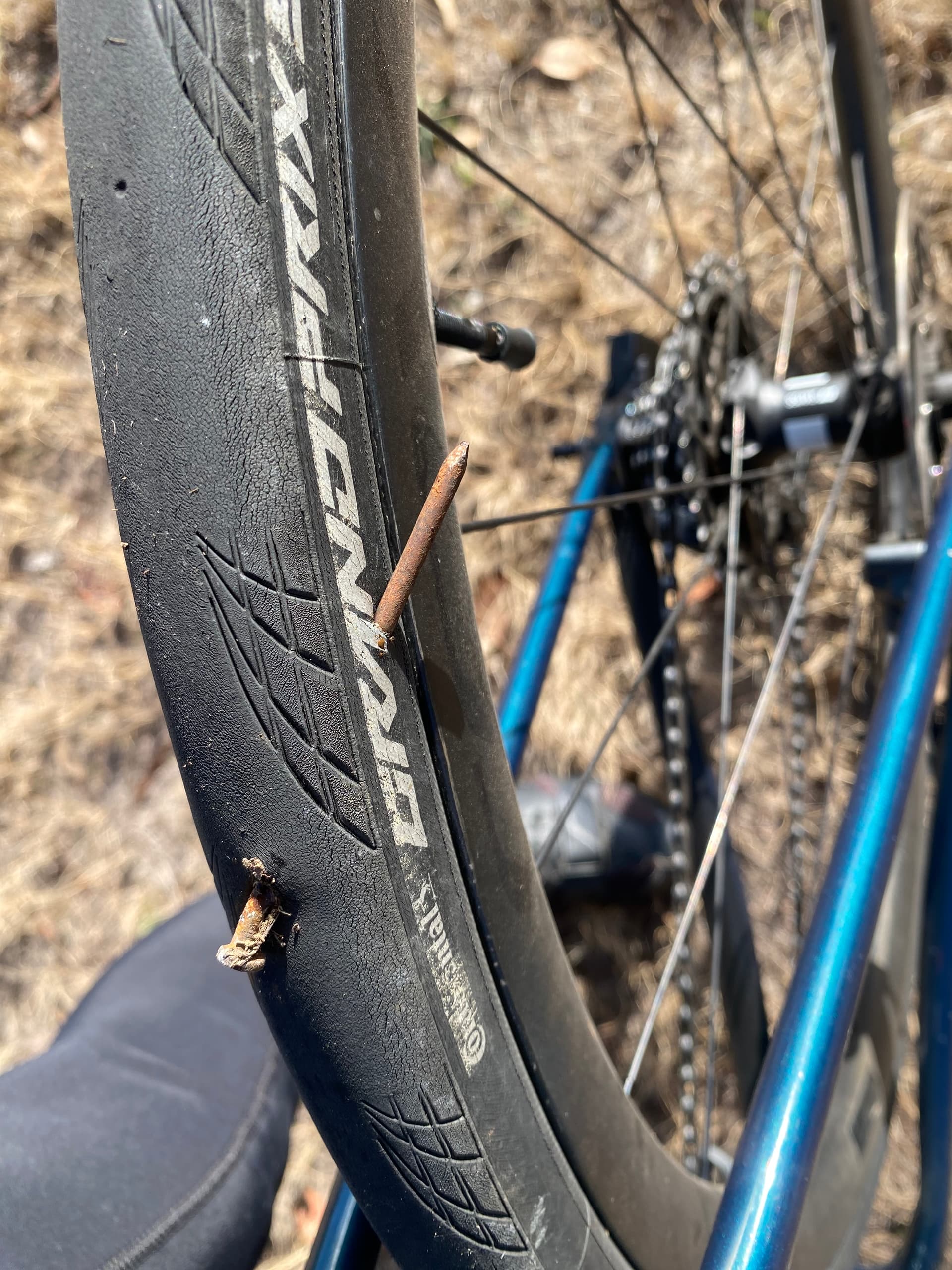

This happened to me today! I have tubeless on this bike (and others). Once I had removed the nail…I pumped some air into it and the sealant sealed one hole very well and the other one on the sidewall well enough so I could put enough air in to get me home (a bit soft but quite rideable). Put in plugs into each hole once I was home, pumped it up and now is fine!

Holy moly! That’s one heck of a puncture. Glad the bike was unscathed and you made it home okay :+1:
Holy cow. What are you using for sealant???
Orange Seal. (Luckily my mechanic @McCookie topped it up recently :grin:)
