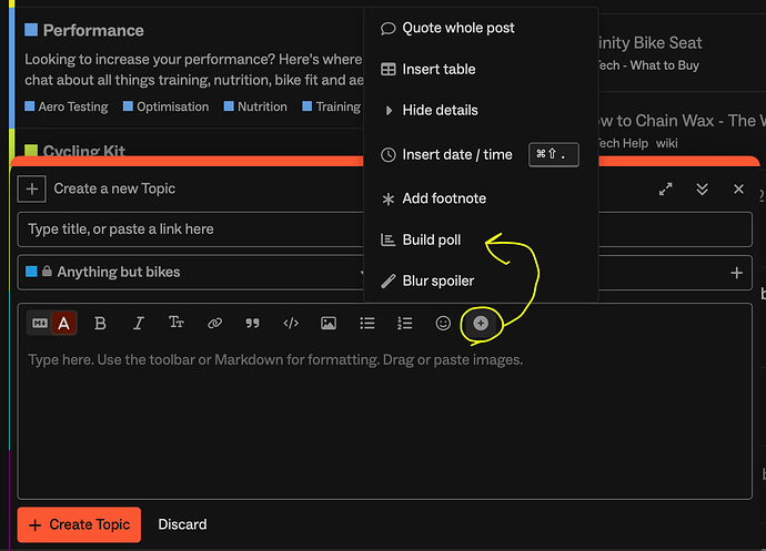

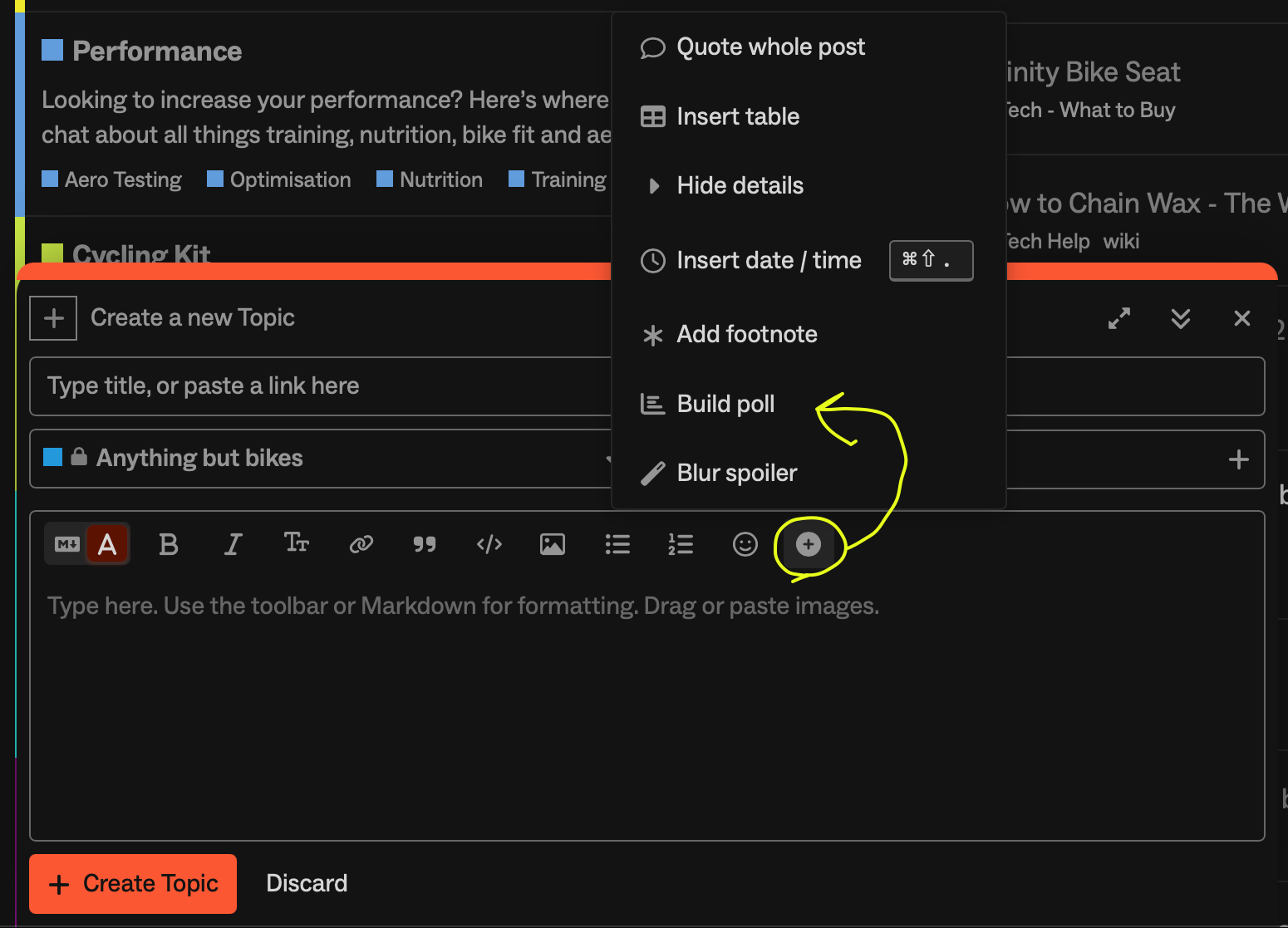

You have the option to create a poll if you’d like. Just click the “New Topic” button, then in the toolbar, click the “+” button and select “Build poll” in the in the drop down list that pops. You also add a poll in a topic that already exists. I think you’d get more responses, though, if the poll was in its own topic.
