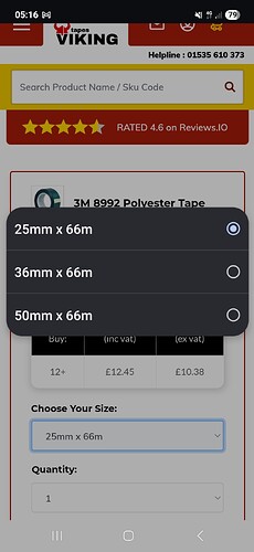

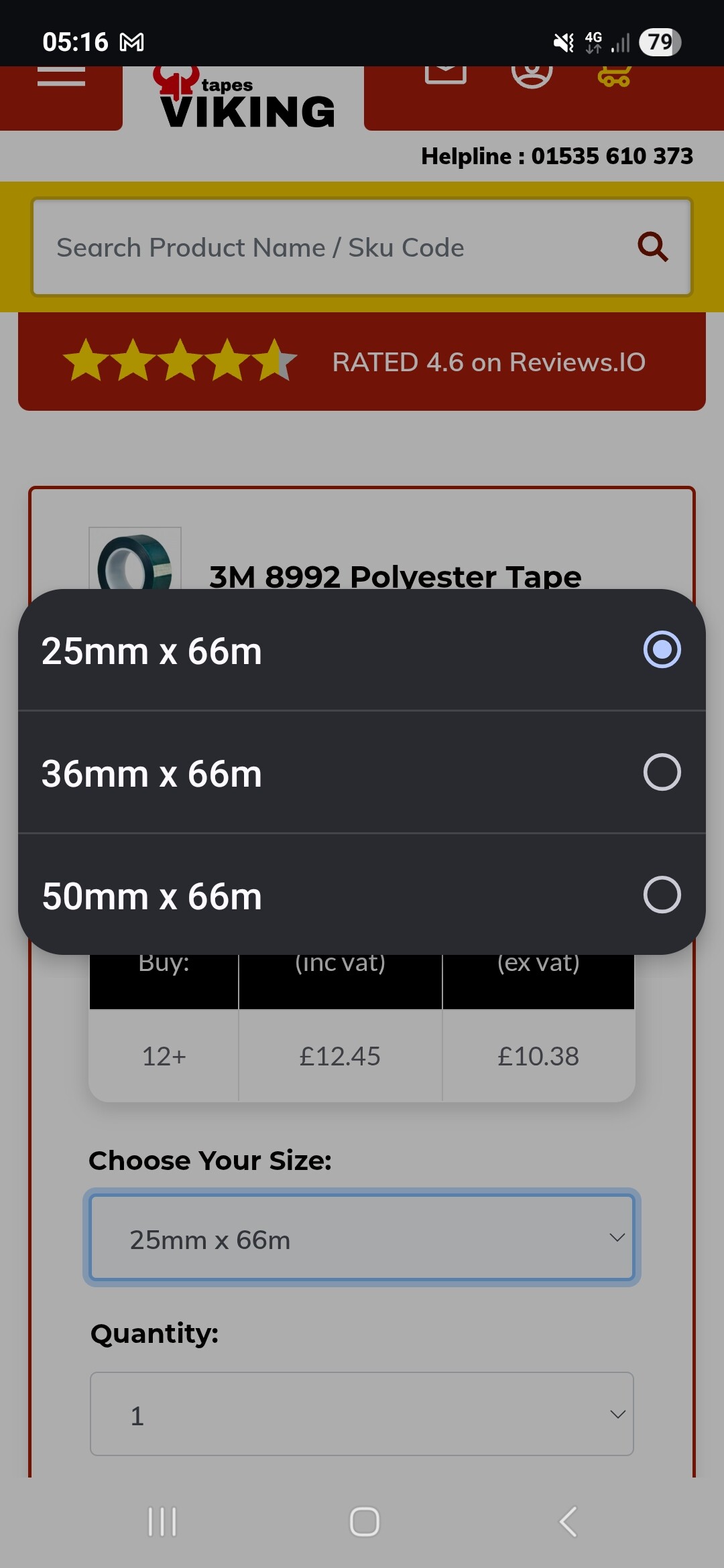

Where do you get it? Having trouble finding it in the right width
I’m in the UK and get it from Viking tapes

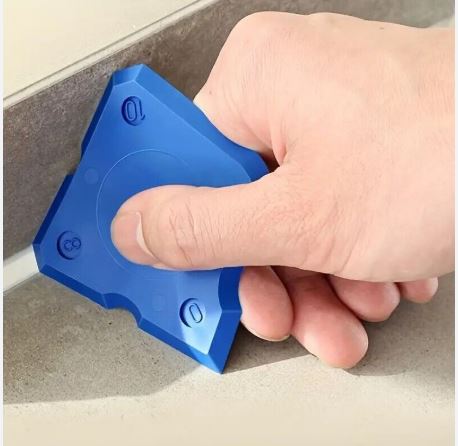

The best thing I’ve found for pushing down the edge of the rim tape is a silicone sealant/caulk spreading tool. They are nice and flexible, have a good/firm enough edge to push the tape in place, and no worry about scratching or damaging the rim bed.
