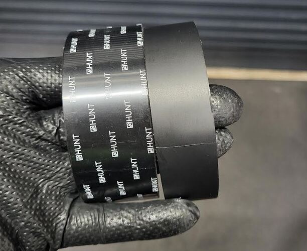

Hunt seam to have changed their rim tape as the last few pairs I’ve received have been fitted with a black, no-logo, tape. Looks ok on the rim, I’d often see wrinkles and crinkles with their old tape at the end of the wrap.

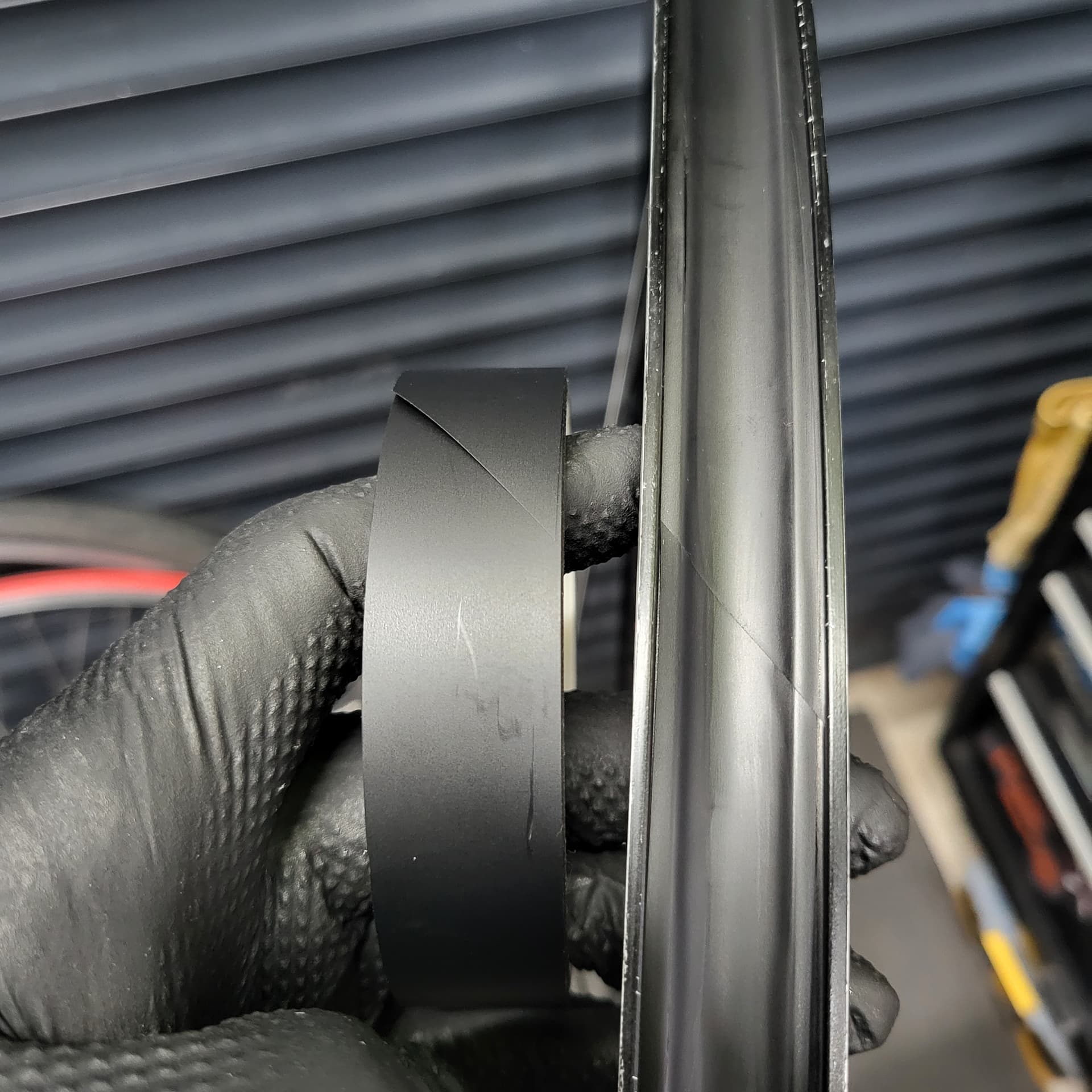

Tape is called ā€˜BlackShield’ and I’ve a couple of rolls in to test. Have a wheel to tape so will report back on how it compares to the 3M, Tesa and Hunts previous tapes.
First impressions of the new Hunt tape are positive.
Goes onto the rim nicely and sticks well at the end/overlap.
edit - I did, notice this small part was not stuck. I pushed it down, it stuck nicely, and stayed that way when I dry tested, i.e. inflate and seat the tyre with no sealant, the tyre fitted nicely with the rim.

Hi Alex, I see there’s two versions of the Hunt tape. With and without printing. I’ll assume you’re using the later but any idea how they differ?

Hi Paul, I have both Hunt tapes. They feel quite different. The new, non-branded, tape feels a bit thicker and has a little more stretch to it. It also, as mentioned before, sticks to itself really well.
I’ve received new wheels from Hunt with the both types of tapes and the new one is finished much better, e.g. no crinkles or wrinkles (which Hunt said was due to shipping temperatures and humidity). They also don’t use the small piece of tape to cover the end/overlap with the new tape.
I’ll be ordering the new tape from now on, but Hunt in the UK only has limited stocks right now.
