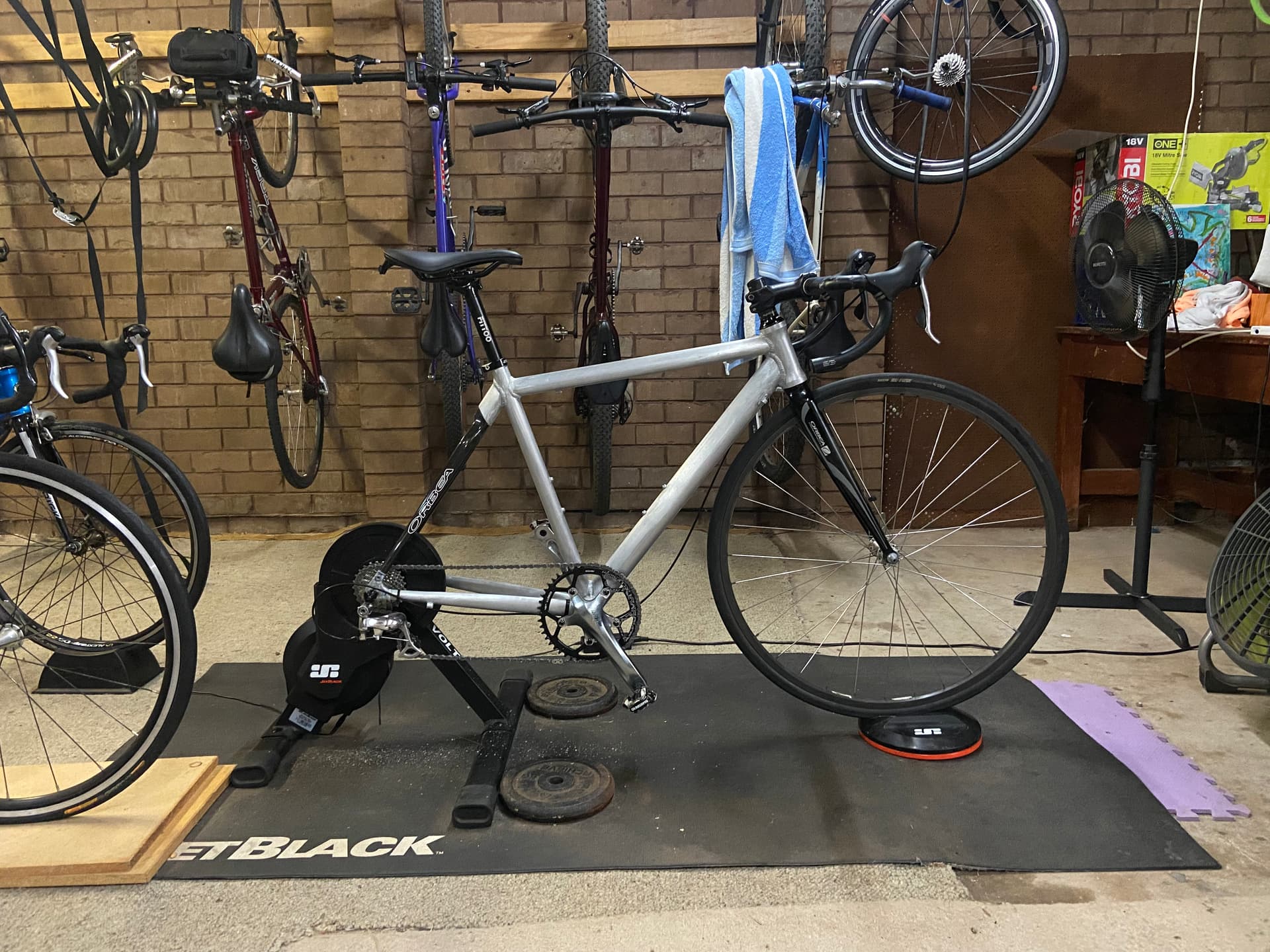

I’m currently having some issues with my trainer but I’ve had an old bike that’s indoors-only for a few years. I recently stripped it back to make it as durable and simple as possible. Stripped paint, full length housing, 1x.

That background is highly distracting. It reminds me of space I do not have to hang bikes that I do not yet own…

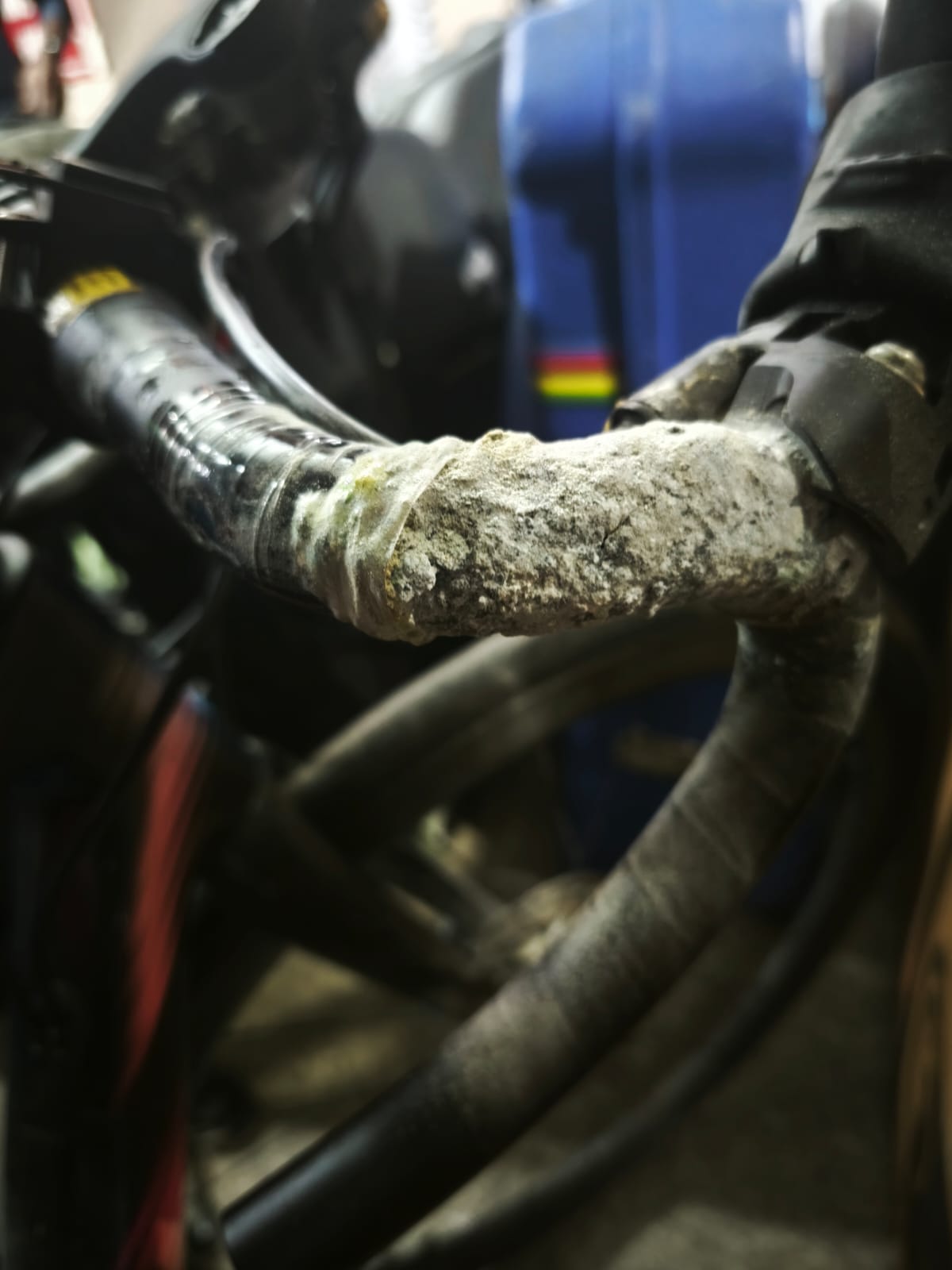

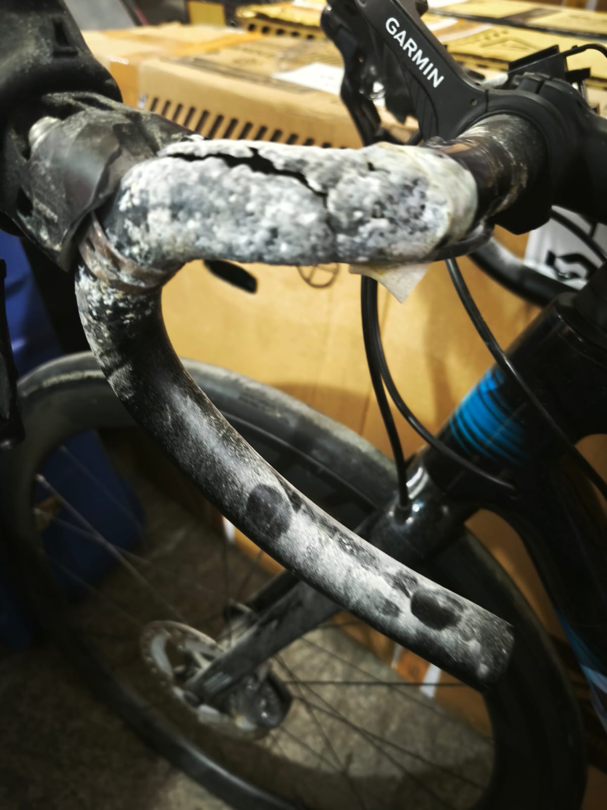

Just so everyone in here is fully informed, aluminium won’t corrode as much as steel, but it does corrode. The paint on my bike in the picture above was bubbling in certain spots due to sweat/corrosion; I stripped the paint to the bare aluminium so I can just give it a wipe over and not worry about hidden issues. The same story with the bars: they have some large chunks eaten out of them from sweat that I discovered on removing the bar tape after listening to a Ronan warning on one of the podcasts. No more bar tape on the indoor bike.
Excellent correction.
Trainer bikes are subjected to a lot of sweat and hence corrosion regardless of material. I take mine apart once a year to try and mitigate this and keep the seatpost, stem, and headset becoming permanently “integrated” with the frame.
Corrosion on aluminium bars? This always haunts me…
As long as you ride bare handed, always check your alloy bars…
Haha that’s amazing. Mine weren’t that bad, thankfully.
Don’t think about how many people in your local bunch could be riding around on bars like this without knowing…
