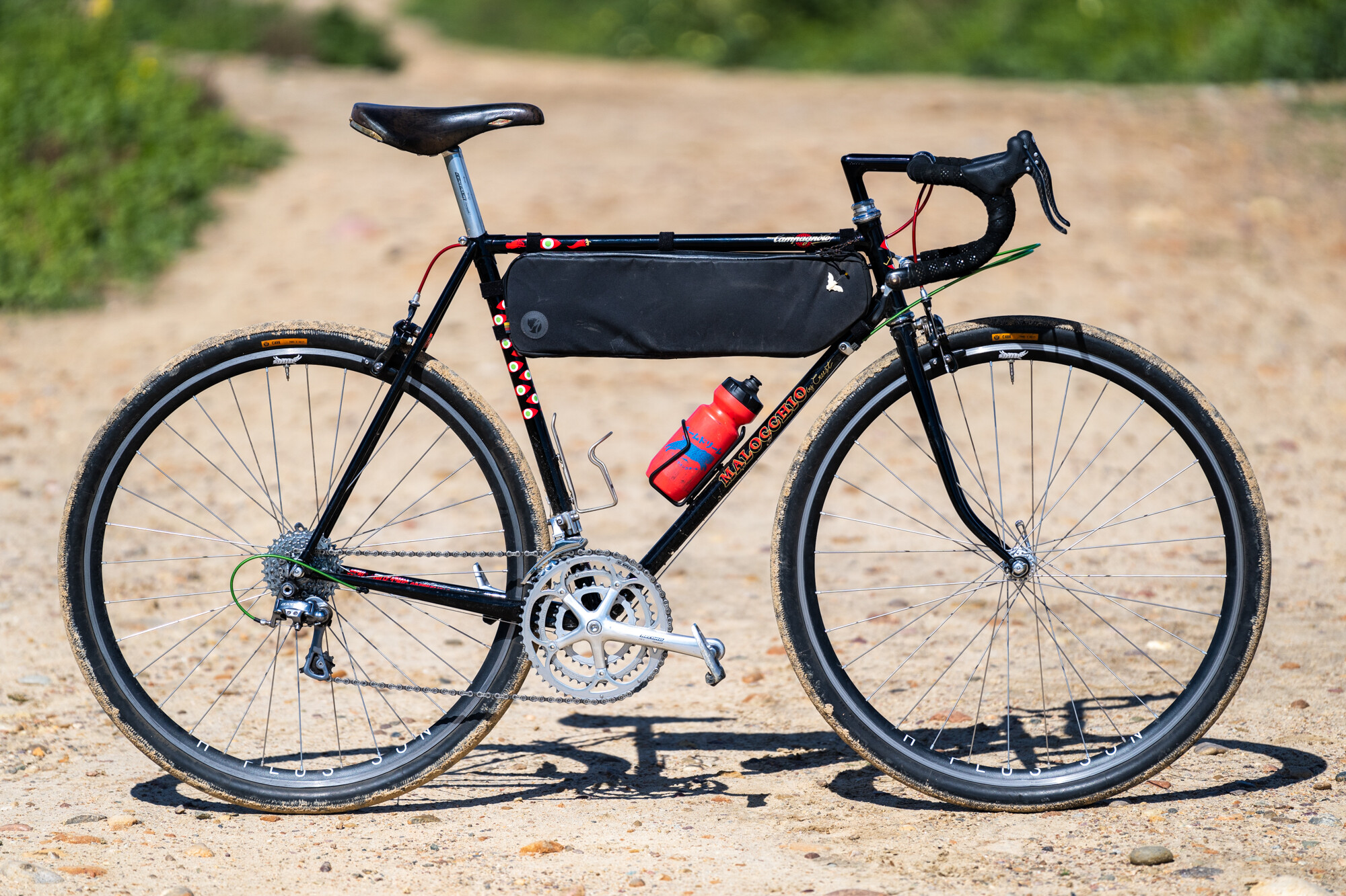

I immediately had to think about this beautiful build here – and just realized that you wrote that article :grinning_face:

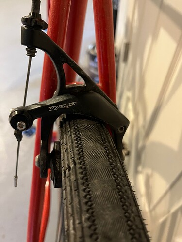

I don’t know if they are still available, but the TRP RG957 are working like a charm on my steel groad bike. They take a gravelking SS 35mm that balloons to 37mm with a bit of space left.

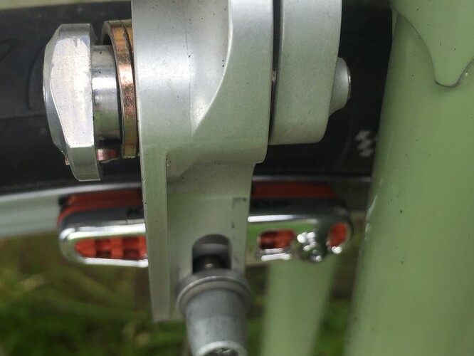

I have some vintage Shimano dual pivots (20 years old). Don’t even have a name on them beyond Shimano and they clear 38s and work so great. They are my “bad road” bike and are strong enough for all the underbiking I have ever been able to throw at them.
I think those are the 6600 (?) Ultegra level, that has the most clearance based on Mike Varley’s blog from ~2012.
