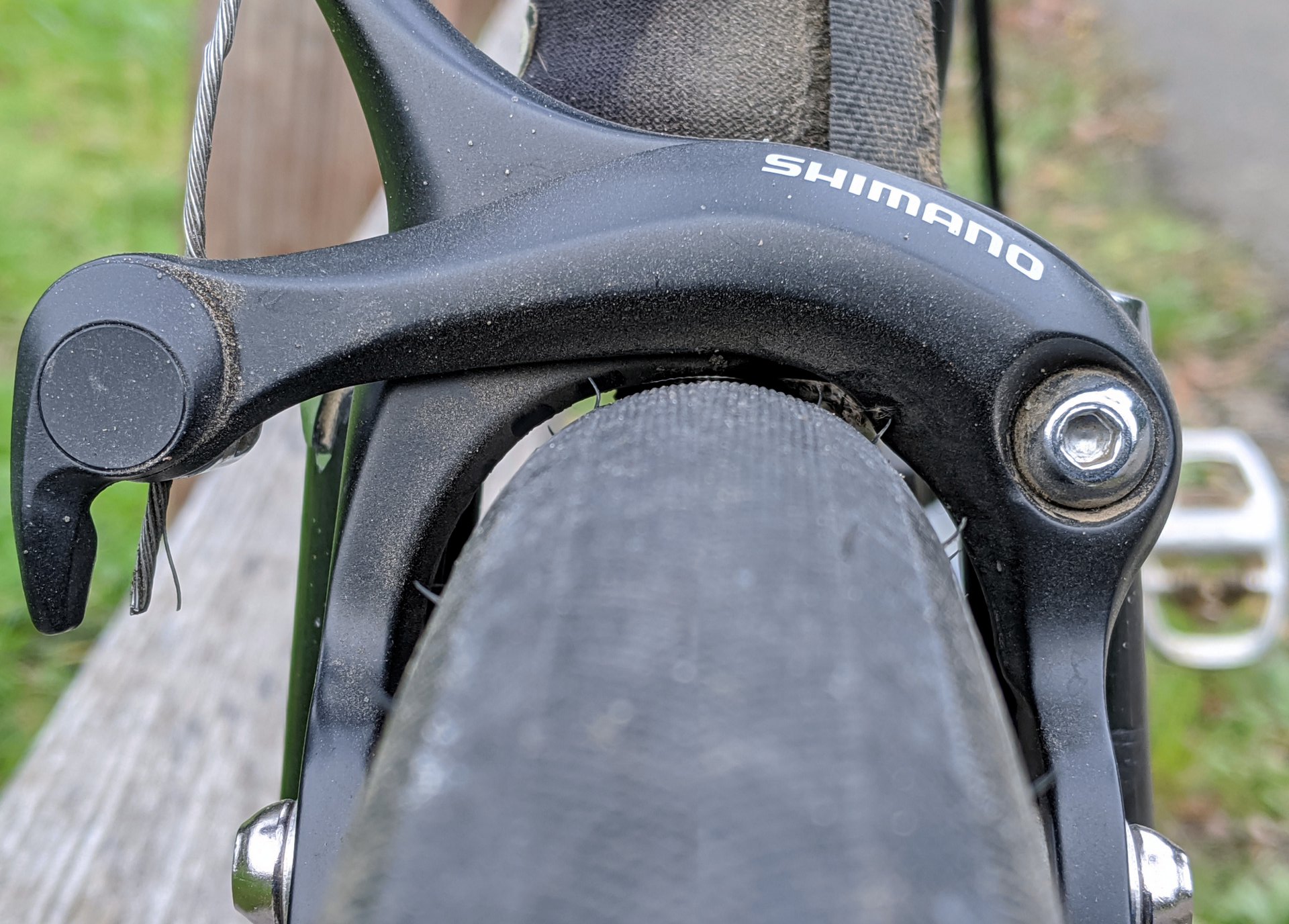

These no-thrills shimanos work well and clear a Barlow Pass 38 mm (YMMV on real world sizes) .
Works really good with short-pull flat bar levers and now with the Weinman levers on Woodchippers.

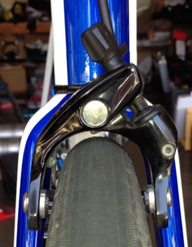

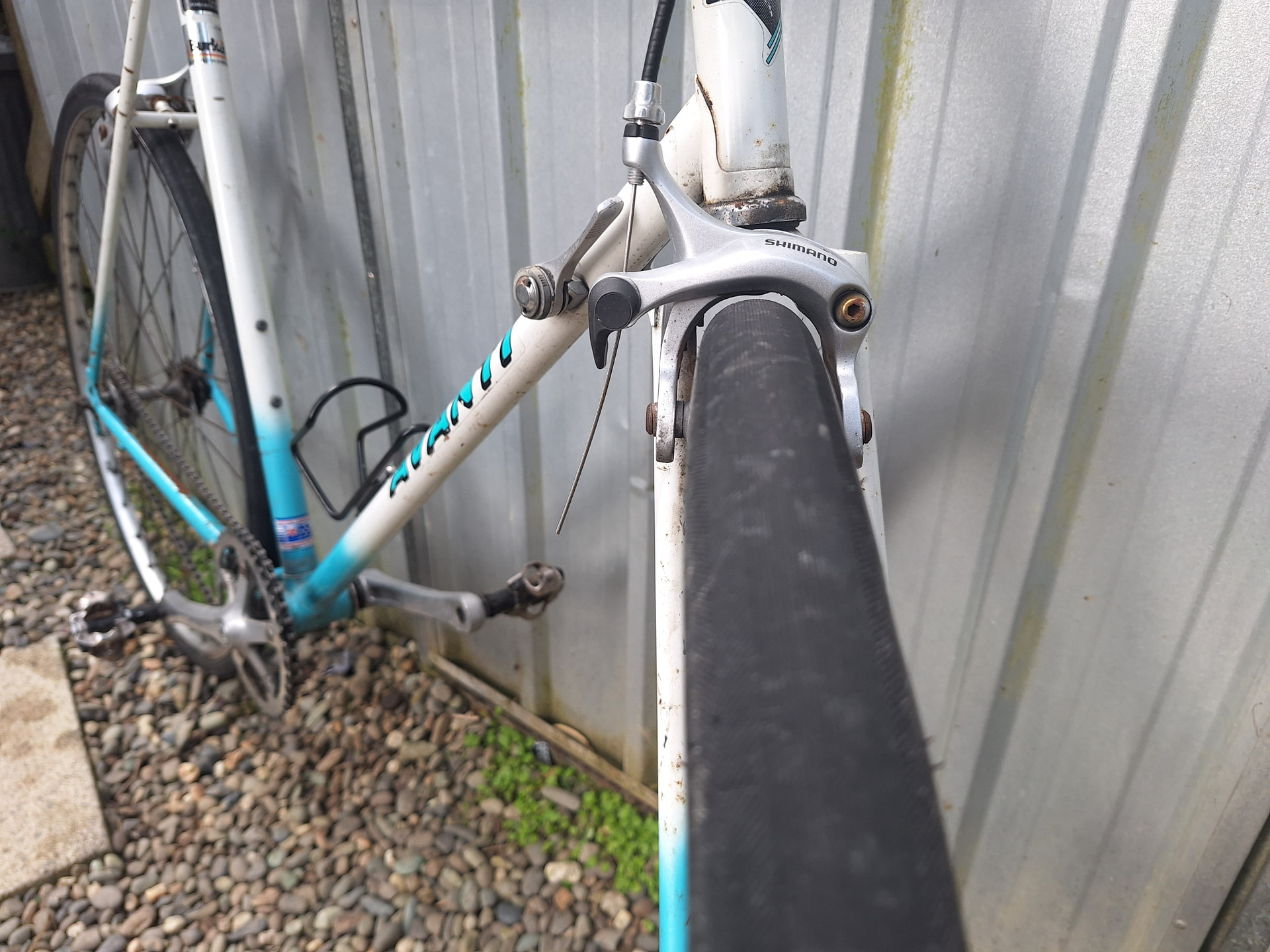

Note that the tight clearance on the front brake (in the first pic) is a function of the frame’s brake-bolt-to-dropout distance, not does-the-brake-have-room-for-38mm-slicks. You can see in the 2nd picture that the front brake has pads near top of adjustment slot, while the rear brake has the pads lower down.
