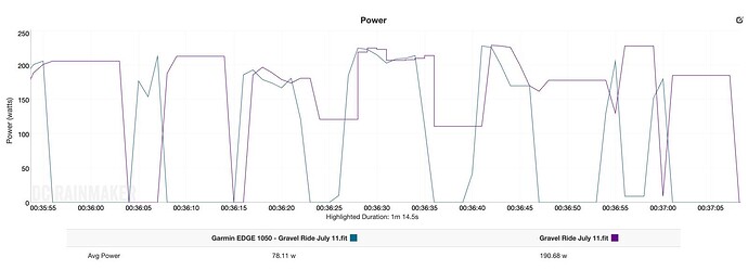

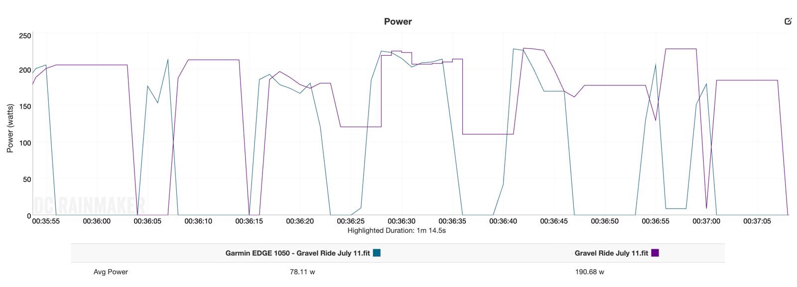

Case in point below. Same ride. Same power meter. Very different data:

@GPLama - Interesting. I assume this is two different head units?
Again, I don’t know how all power meters work (that’s for people like yourself), but my older SRM PM7 sends torque and cadence data to the head unit, and the head unit calculates the power (using stored offset and slope values).
My newer SRM PM9’s computes torque and power internally, and sends the power value directly to the head unit, which simply displays that value. I’d assume this would / should remove the error you see in that image.
Except, maybe, a small offset due to not being able to press “start” for recording on two headunits at exactly the same moment.

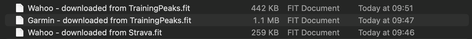

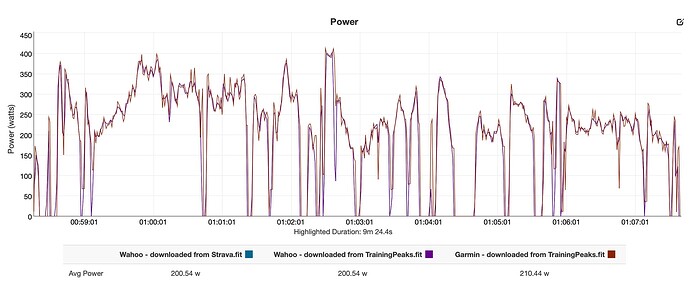

Edit: I have some data dual-recorded on a PM9 and sent to two different devices (a Wahoo Roam 3 and a Garmin 840). It’s certainly close, but not as perfect as I’d expect. Interesting.
These files were downloaded from Strava, and TrainingPeaks (the latter being my preferred storage location, as I use WKO5 a fair bit). I note it would be better to compare the FIT files taken directly from the device, to remove any processing errors from the software used. Note the Wahoo file size difference between data exported from Strava (256 kb) vs TrainingPeaks (442 kb). The Garmin file is likely larger because I have more things paired to that device (on this day, a Tymewear ventilation strap).
So I think the discussion is about whether the “error in power” is due to a measurement error in the power meter itself, how it’s calculated/displayed on a head unit, and then on a software platform. It’s not simply X power meter is good/bad. There are additional layers to consider. It’s the whole power recording and displaying ecosystem.
