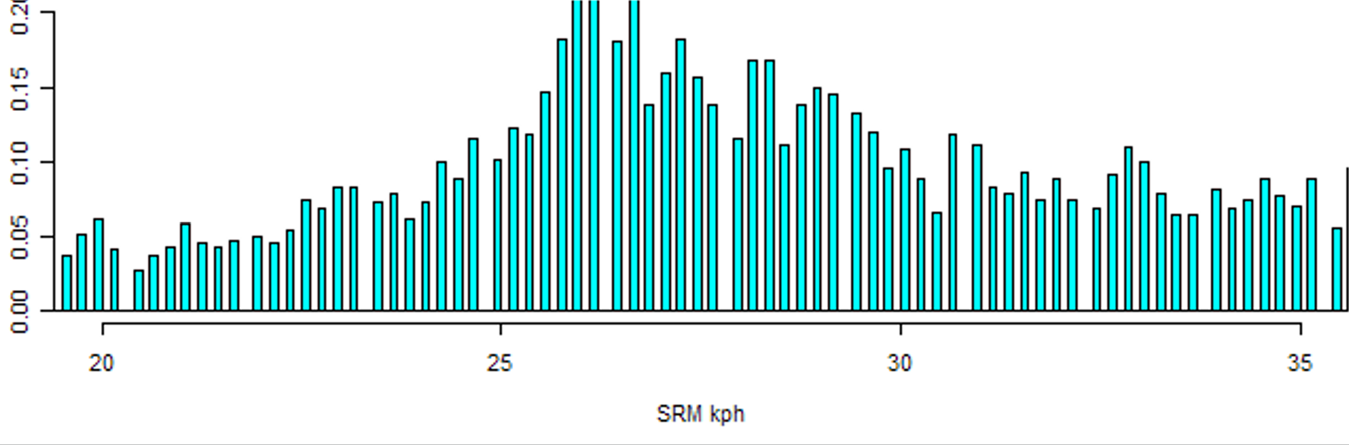

This was with the old SRM speed sensor. Here’s a histogram of speed as recorded by the old SRM head unit from about an hour of riding. Notice the pattern that looks like a comb with missing teeth. This was for one SRM/head unit, so I asked on the old Wattage List for riders to examine their own SRM data for specfic speeds and got several responses, all saying that combing back through years of data, they saw the same missing tooth pattern. At the time I thought it was just an oddity of ADC or DAC conversion, but I hadn’t yet come up with VE, which depends on acceleration. The reason why I recommend a speed sensor over GPS now is exactly because GPS speed readings are noisier than wheel speed sensors.
