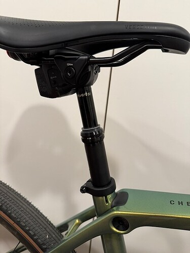

I recently got a Trek Checkpoint+ (eGravel bike) and added a Rockshox Reverb XPLR dropper to it (yes, I know it’s only a very small amount of drop, but I got it really cheap so decided to try it). Because of the dimensions, there’s not enough seatpost length to clamp in a workstand (see photo).
I know I can temporarily raise the seatpost, but that turns any quick workstand use into a longer process than I’d like. I can also hang the bike from the saddle, which is ok for some things. And, I could consider the Silca Hirobel, but that again takes time and I’m guessing would be just as slow as lowering the saddle, and probably bring some other issues to bear.

Thanks for that, but unfortunately in this case there’s not enough space on either the lower or upper part of the dropper for the bike stand clamp.

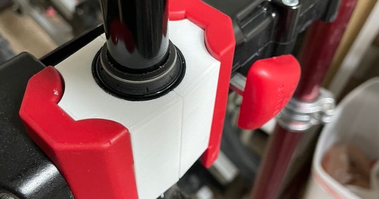

I made this to solve that exact problem. If you have access to someone with a 3d printer, or have one yourself, you’re more than welcome to download it and use it.
Wow, this is awesome!!! Thank you!
I’ll print it tomorrow and give it a try!
