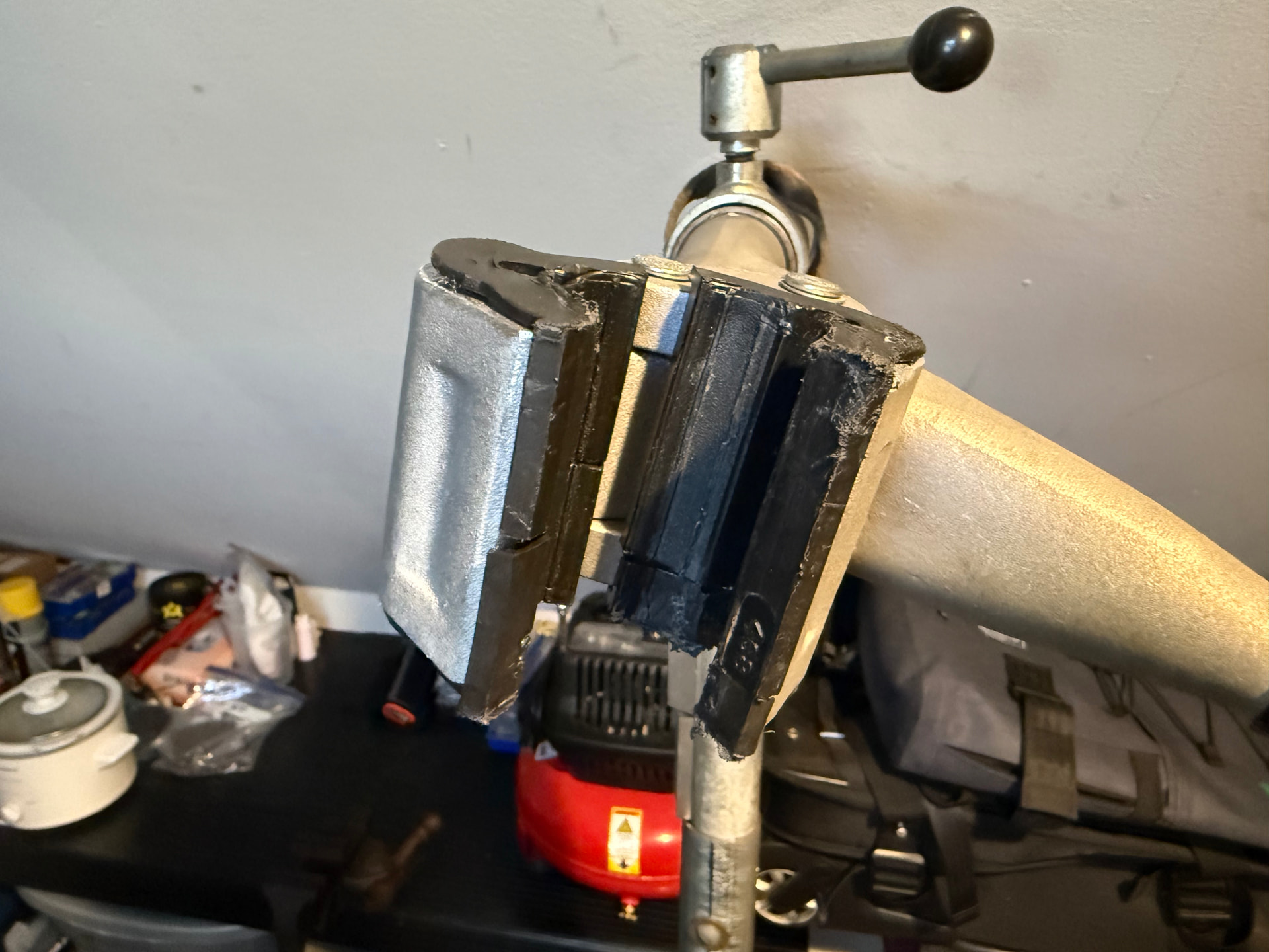

I found this thread when I was searching for ideas of how to modify the Park clamp. Seemed like it would be pretty easy but I wanted to see if anyone else had done it. Not much info online anywhere else. Today I spent a little time with a hacksaw, a file, a utility knife, and some hot glue, and I got the Park clamp down to 66mm. I think the Feedback is 89mm, the Park Micro-Adjust is 70mm, and the Efficient is 51mm, so I’m pretty happy with it.
I mentioned this exact thing several posts up. It’s silly not to cut the clamps down.
You were my inspiration to finally take the hacksaw to it. I knew it could be done, but I needed a little confirmation that I should take the plunge and actually do it. At some point I’d like to do a better job with the rubber jaw covers and better adhesive. I’ll probably add a new pair to our next QBP order. If I can cut them down really nicely maybe I can heat weld the joint.
