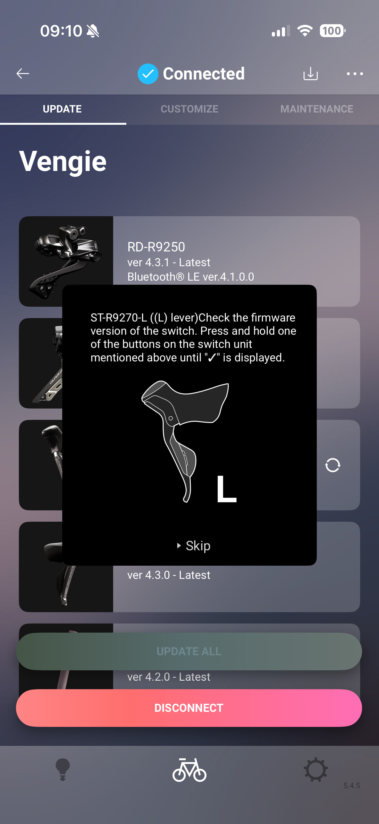

Update: I don’t think my issue with the left shifter is battery-related. E-tube app is not reporting low battery and in the E-tube app when checking for firmware update for the shifters, the left shifter always take significantly longer time to be recognized by the app after pressing and holding one of the buttons.
How long does it take for you to wake the Di2 system up after it has gone to sleep? When I press buttons on the left shifter after Di2 has gone to sleep, it takes 7 seconds before the front derailleur would respond. In comparison, the right shifter takes probably a couple of seconds to wake the system up.
