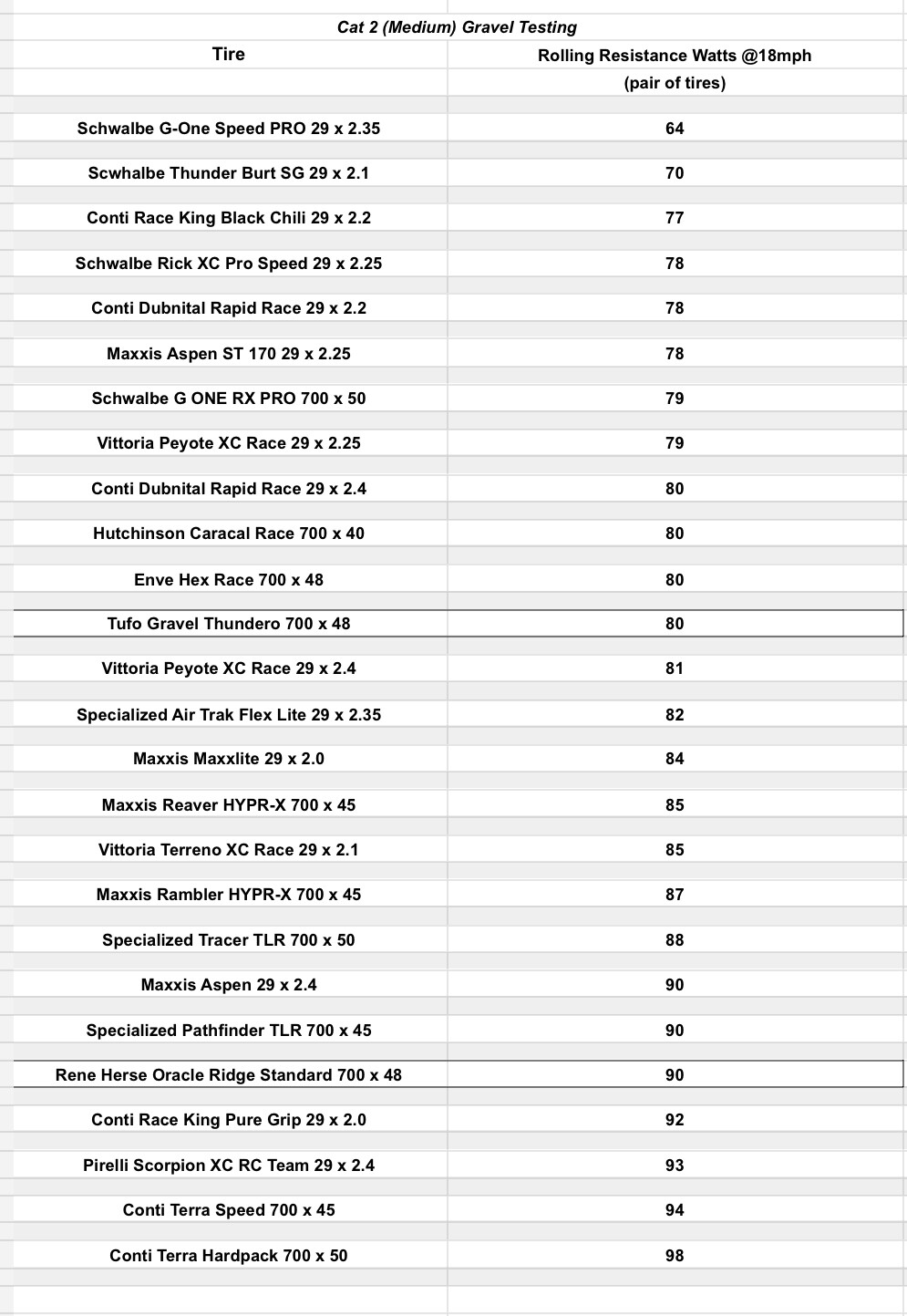

Well John Karrasch has just tested the RH Orcale Ridge on cat 2 gravel, I won’t post the full results but it was the 5th slowest tyre he’s tested…

Test results below. Suffice to say the RH tires were not……good.

The Thunderos right up there. Enough so that I can’t really justify switching to RX Pros, which is wonderful news for my wallet.
As per a previous post, TB’s are the tire of the gods. RH is the tire of the devil (although they have a godlike marketing department).
Yeah. The 1W difference is probably within the margin of error in the testing protocol, and pretty inconsequential in the real world. If you’re happy with the Thunderos for your conditions, it makes sense to stick with them.
