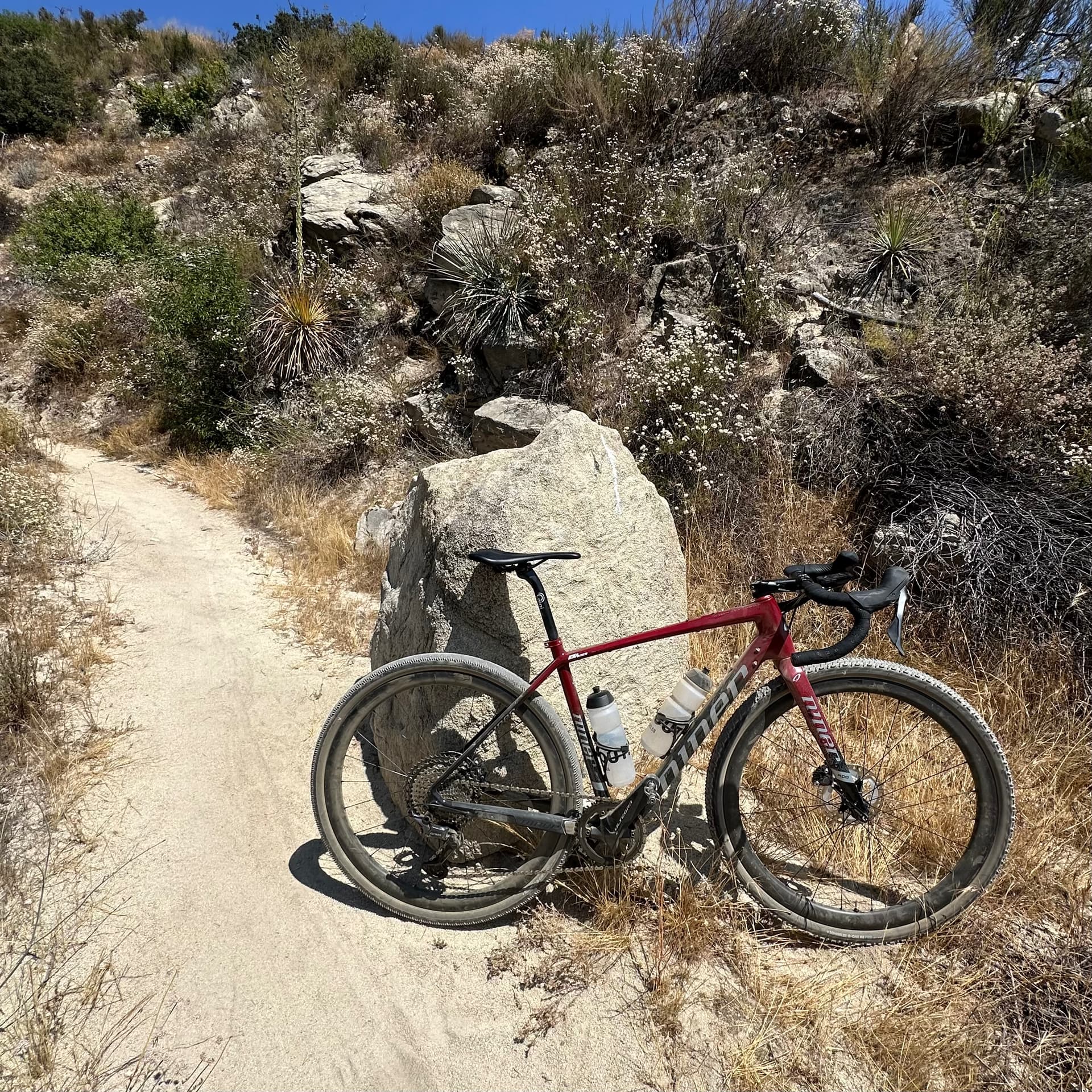

I found a combo I’ve loved this season for the more aggressive “gravel” I ride in the mountains, which includes a decent amount of baby head rocks on double track and single track, as well as dirt and asphalt roads.
Shwalbe G One RX Pro (45mm) in the front and G One R Pro (45mm) in the rear.
The new compound on these is pretty game changing IMHO. It combines somewhat aggressive treads with harder compounds which allows them to roll really fast but have good grip when it gets loose and rowdy.
I’ve felt no weird sketchy cornering attributes when ripping down super steep road descents either.
I also really enjoyed the new Specialized Tracer TLR as a rear tire. Fast rolling and good grip. Very versatile tire. Definitely inflates small. 45mm Measures 43mm on a Roval Terra CLX II (25mm internal rim) wheel. Could be a good option for people with a borderline rear tire clearance or for days when you’re expecting mud if you ride where places where that happens.

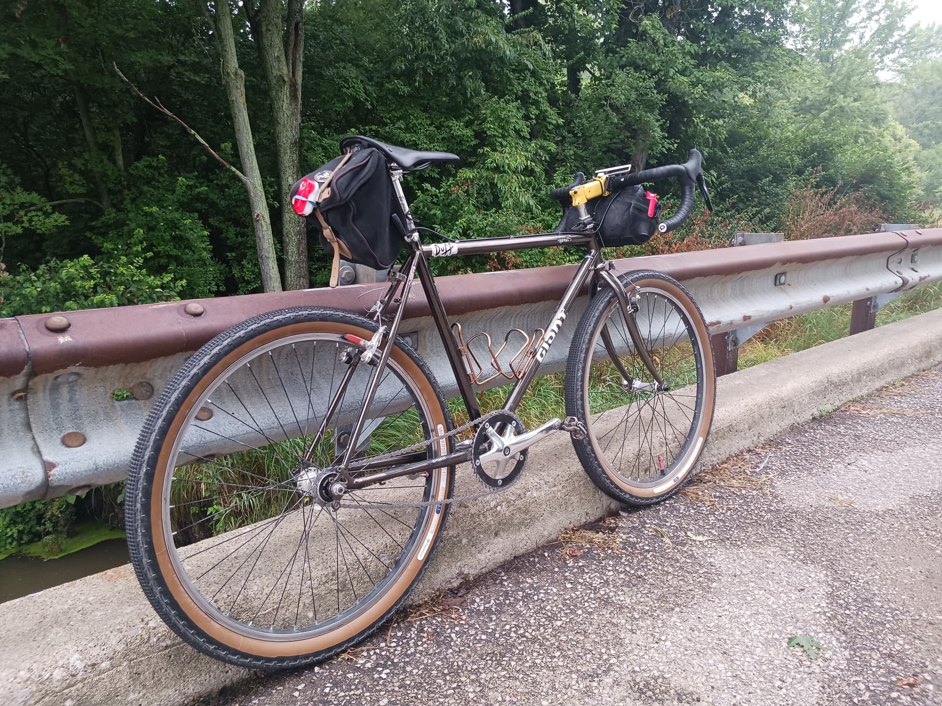

Here’s a vote for TB’s.
If you’re running a converted vintage MTB as a gravel bike and need 26" tires, the Gravel Kings in 26x2.1 are really fast compared to the other XC-ish tires I’ve tried. You can also get two of them for about the price of one from Rene Herse, if you shop around.
I know nobody else cares about this, I just wanted to participate in the new forum :laughing:
