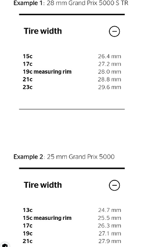

I wish they’d all keep to a standard! I’ve found some info on the Continental website. It seems to suggest that they use different width “measuring rims” and for different tyre sizes, but it’s unclear. :man_facepalming:t2: They say their measurung rim for 28s is a 19 mm internal width. So, they should measure 28mm on my 19mm wide rim, but they don’t.

In all the info on their website, Conti only provide two examples explaining tyre width in relation to rim width. They explain that they use a “measuring rim” that seems to vary in width depending on the size of the tyre.

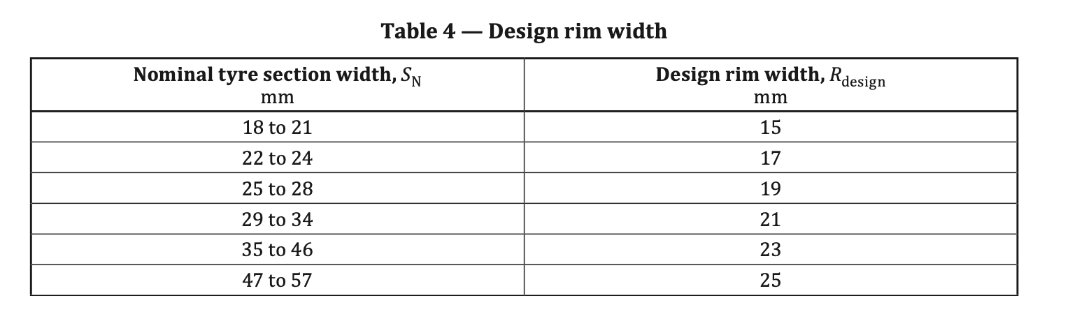

There is a section on design rim widths for given nominal tyre widths in ISO 5775-1. A 25 and a 28 share a 19 mm design rim. Normally I’d say we can only expect a tyre to match its nominal width IF it is mounted to a rim matching its design rim… but your experience is that both nominal sizes don’t line up even though your rim is very close to the design rim for both.
