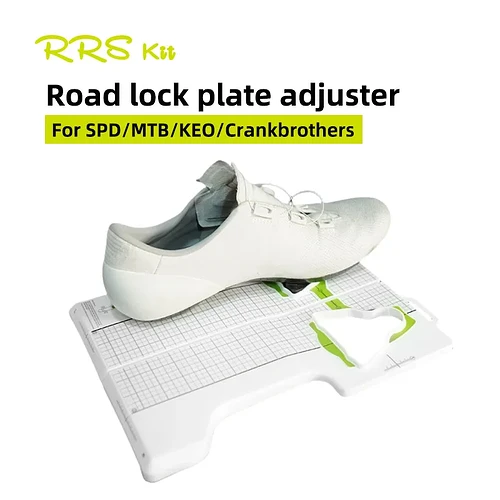

This is one of my better AliExpress purchases:
Unfortunately that is a blatant copy - I suggest purchasing the original from Ergon.
