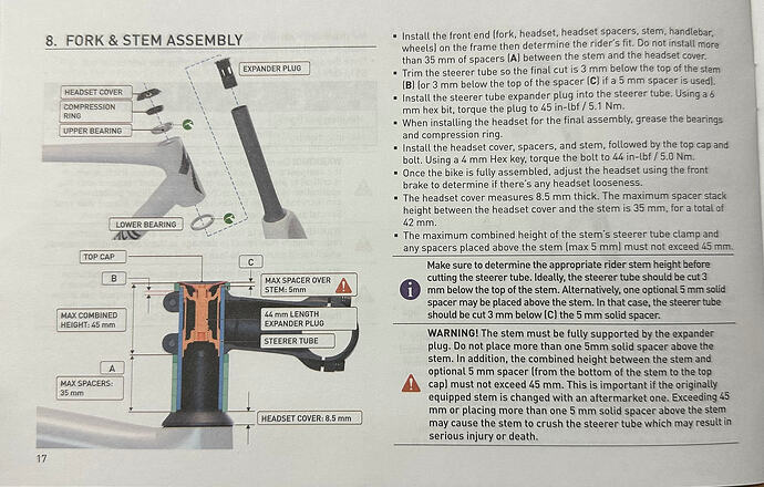

So I was making a point of checking the manual for my new Crux and saw the page about stem spacers.
  • As noted above, I want to test the fit before cutting the steerer down. The suggestion that I can’t have more than one “solid” 5mm spacer above the stem seems absurd.

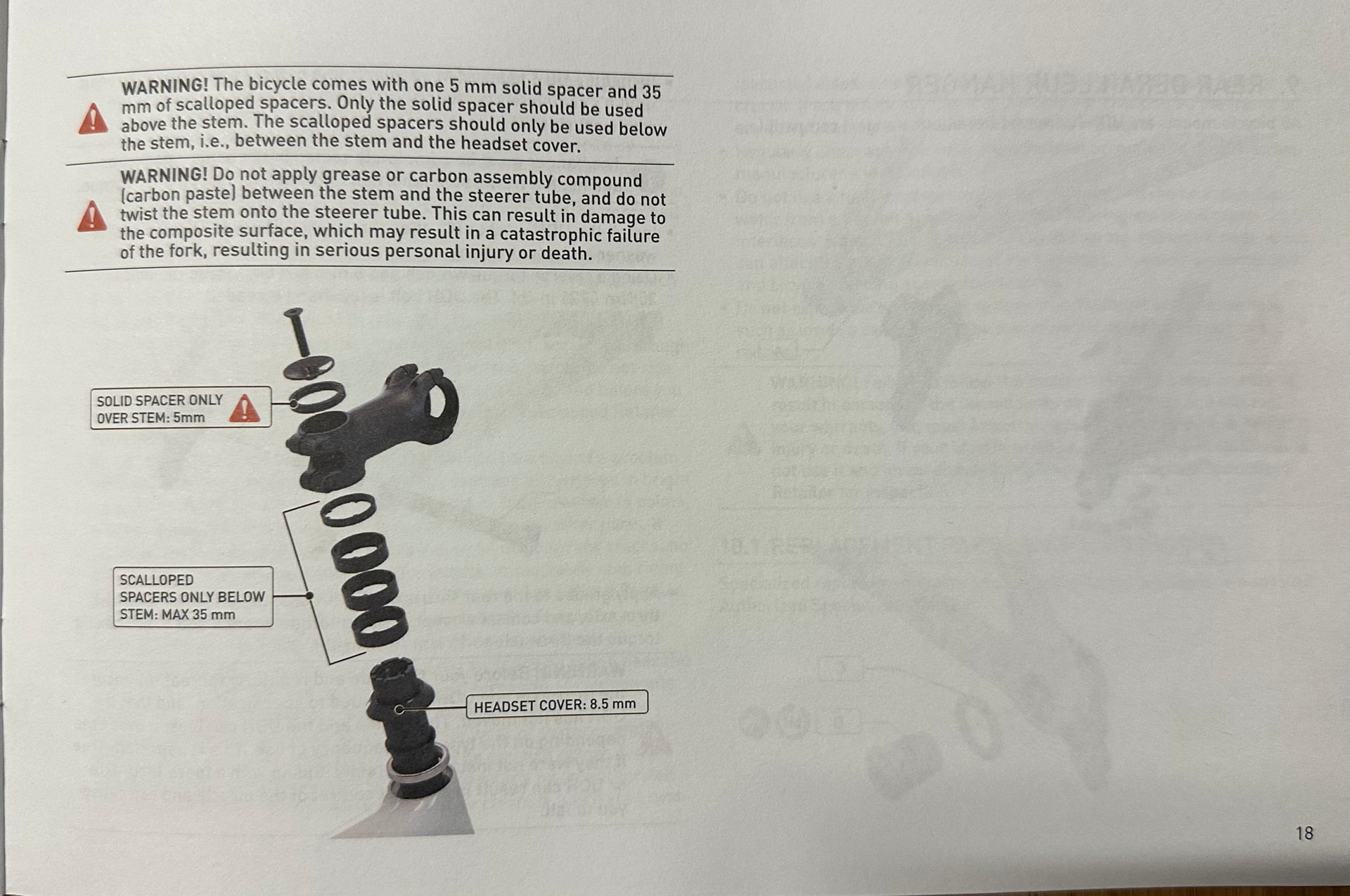

  • The Melbourne shop that sold me the bike obviously didn’t worry about this instruction because they shipped it with one of the 5mm “scalloped” spacers above the stem as well as the solid one.

Yes it’s a max of 5mm.

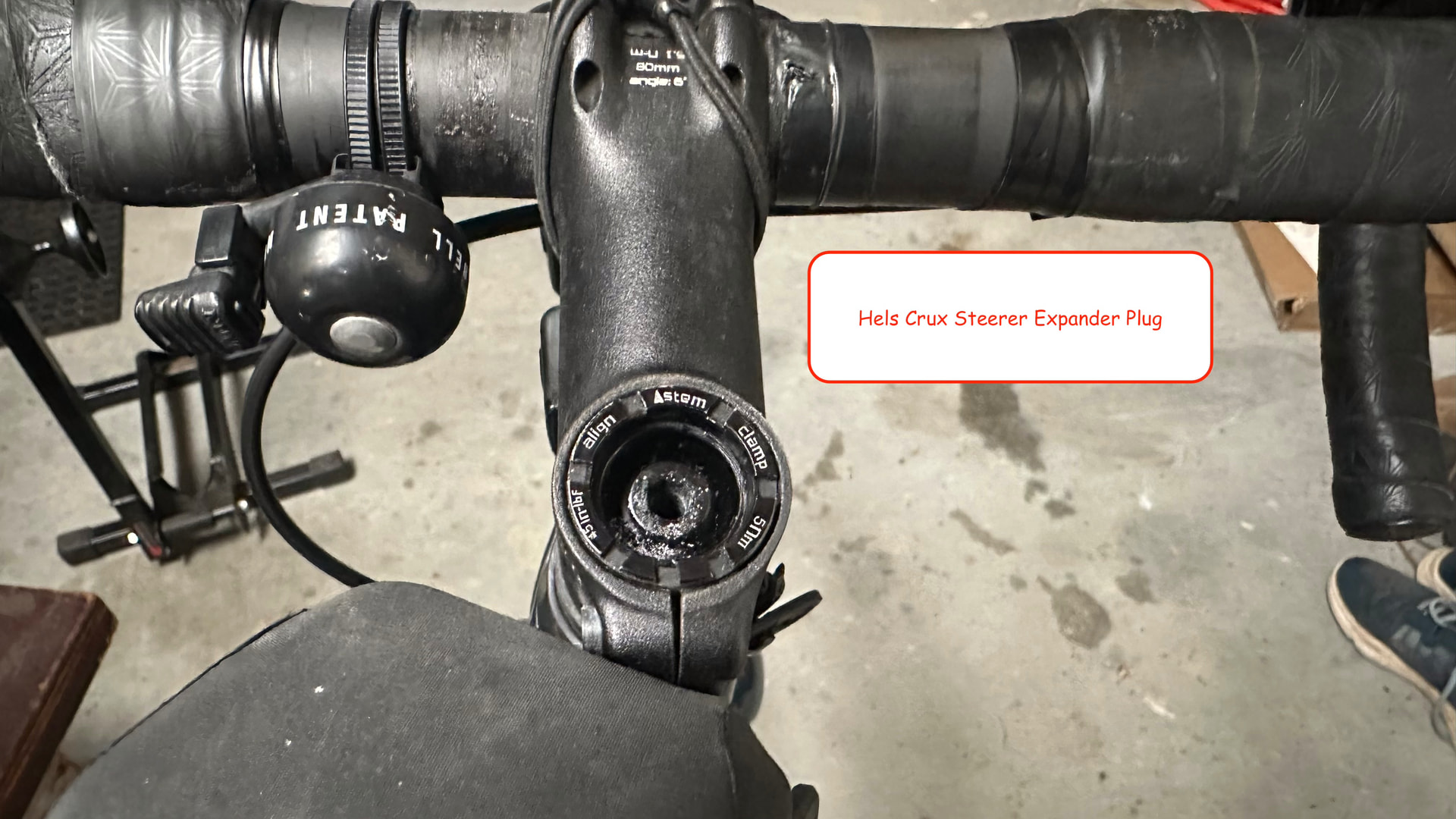

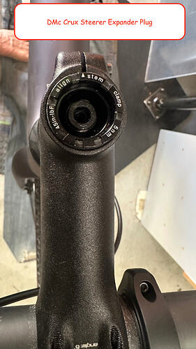

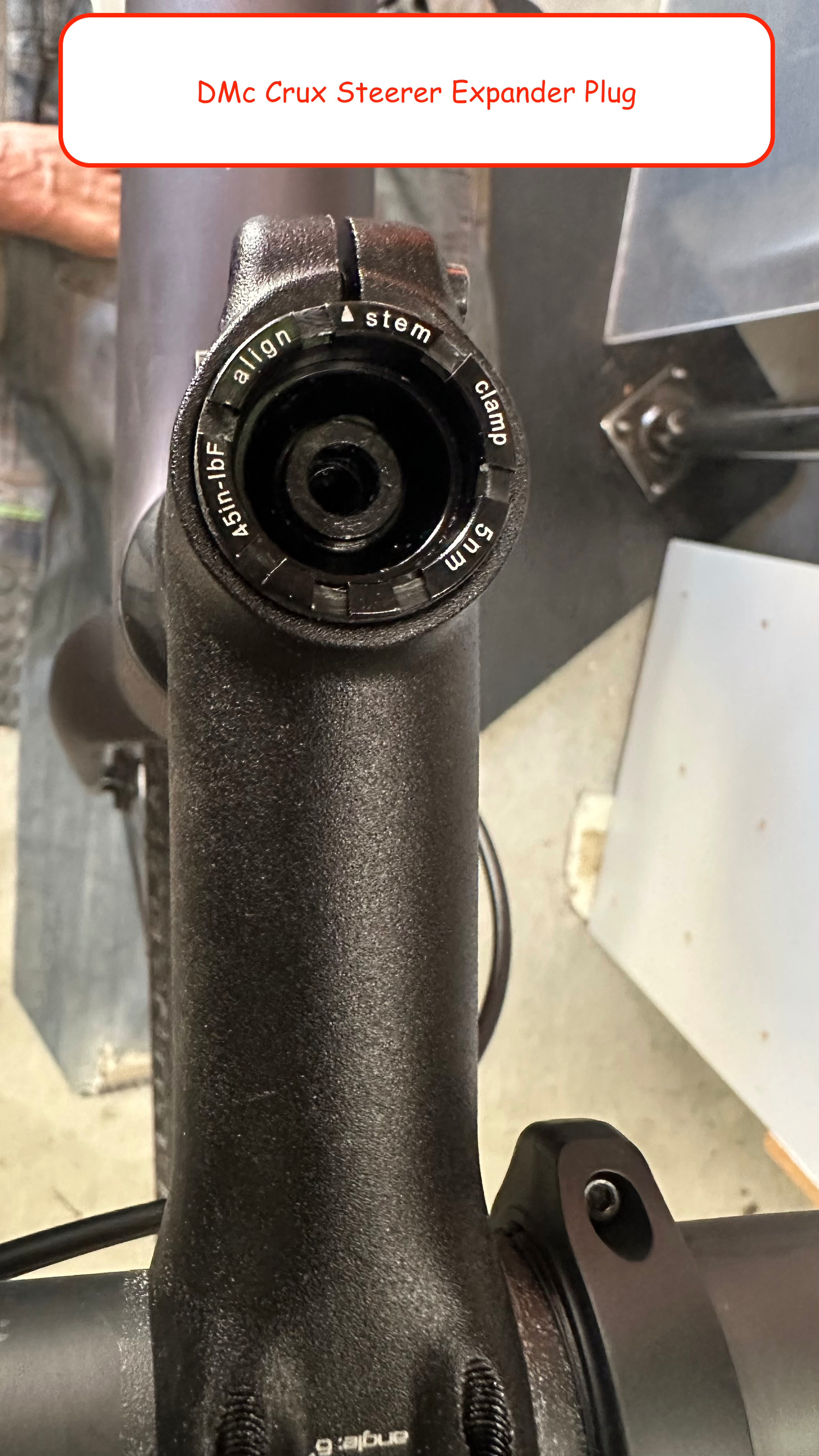

Which way around should the steerer expansion plug be in a Crux / Aethos steerer??
It seems I’m not the only one who thinks the labelling is ambiguous, because we now have 2 cruxes with the plug installed the opposite alignment from each other.
Having found the 2 different part numbers in the instructions that came with my bike, I set out to confirm which plug I actually had, and if it had been improved since Hels’ 2022-23 model.
It looks like we have the same plug but one of them is installed the wrong way around and I’m not 100% sure which is wrong.
I think mine is right, because it points at the stem clamp, but at first I thought the word STEM should be pointing at the stem! Obviously the person who installed Hels plug thought that too.
Are these usually installed in the shop or the factory?
It says “align stem clamp” with an arrow to indicate where the stem clamp should be. The bottom pic is wrong.
Thanks Rich
I admire your conviction.
According to my local Spec dealer, these plugs are factory installed, so the plug in the bottom photo has been like that for ~3 years of riding, courtesy of the factory.
Wow, that was fun working out how to remove the steerer plug from Hels’ bike so I could install it the correct way around!
