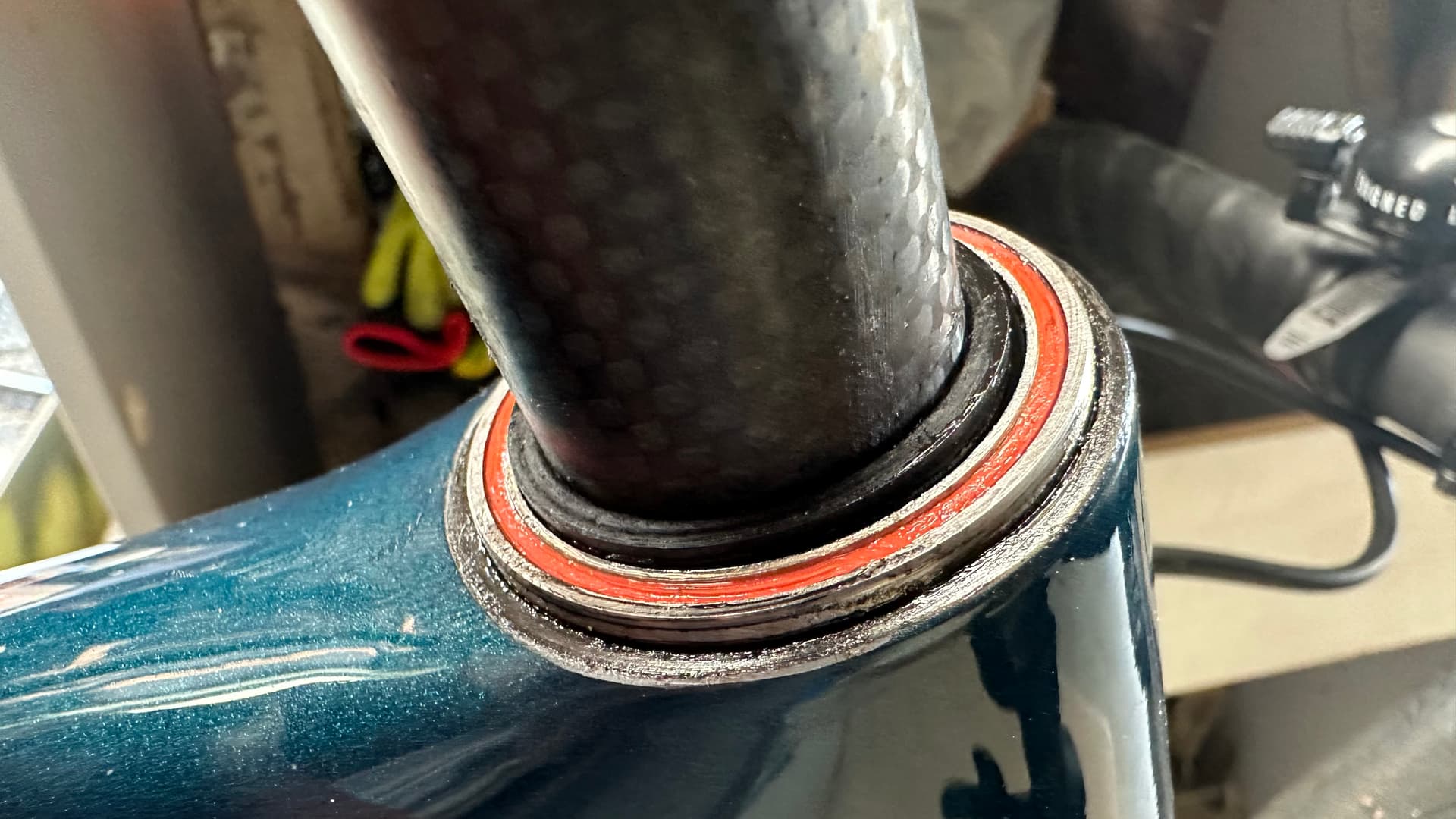

I’ve just spent way too long trying to tighten Helen’s Crux headset that I discovered was loose this morning. I simply don’t seem to be able to tighten the top cap bolt such that the front wheel turns freely but the headset doesn’t move when I push the front wheel against the front brake or a wall. Even with some grease under the top cap bolt, soon as the bolt is finger tight (ie the torque spanner hasn’t even registered yet), the steering feels tight.

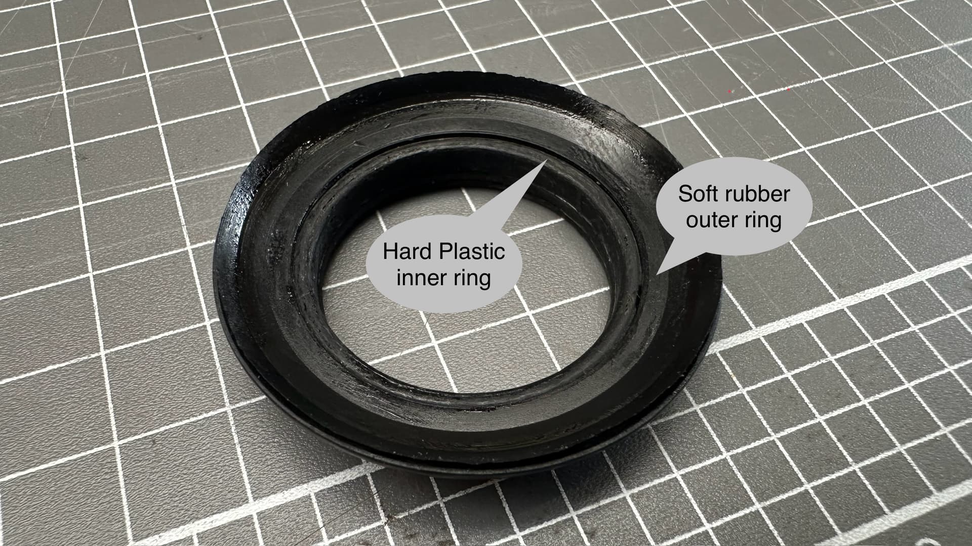

I lifted the headset cover up and the compression ring doesn’t look to me like it’s being pushed into the top bearing as much as I’d like - it seems to sit flush with the bearing before it’s started compressing into the bearing.
I wondered if there was another washer missing under the headset cover to push down on the compression ring but the drawing on Specialized dot com says what we have is correct.
I guess I’m curious if anyone (@Jase?) has had this issue before, or if anyone has suggestions.
I’ve set it up so it’s as loose as I’m comfortable, so the wheel feels tight but not terrible and the headset isn’t moving when pushing against a wall/brake.
It seems to me that the specialized top bearing cover is just poorly designed so it doesn’t load the inner compression ring enough before the rubber seal starts dragging on the outer race or the frame. Not impressed, but at least it’s relatively easy to fix.

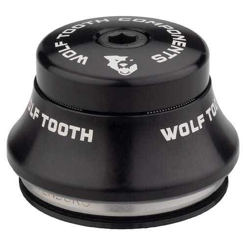

The ultimate solution, in the absence of Specialized fixing their design, is to replace the upper headset with the WolfTooth IS42 headset, which is what Specialized Australia told our LBS to do for us. This is the link to that Wolftooth headset. Note that the Crux and Aethos ARE compatible with IS42 headsets, contrary to the note about Specialized bikes on the Wolftooth website.
Apparently the Cane Creek 40 headset is also suitable, as shown in this video by Nolan and Bike Sauce (link provided by another discord member).
Another user also provided more detail on the Wolftooth Headset choice….
Speaking from own experience (but I can ofc be wrong): The Wolftooth 7mm top cover (I think that’s also called dust cover) won’t work with the Specialized stock upper bearing. The stock bearing is just too high for the Wolftooth dust cap. The bearing that comes with the Wolftooth headset is 6,3mm high while the stock bearing is 8mm high. I tried squeezing the Wolftooth top cover over the stock bearing and that didn’t end well.
While we are already at it: The Wolftooth Performance headset (Wolf Tooth Performance IS Headsets - Integrated Standard – Wolf Tooth Components) won’t work because it comes with an IS41 bearing → Fail.
Only the Wolftooth Premium headset (Wolf Tooth Premium IS Headsets - Integrated Standard – Wolf Tooth Components) is available with an IS42 bearing which is the one you need. However, both are available with 7mm stack which makes them a pretty good replacement for the Specialized stock cap.
Long story short: This (Wolf Tooth Premium IS Headsets - Integrated Standard – Wolf Tooth Components) is the way.

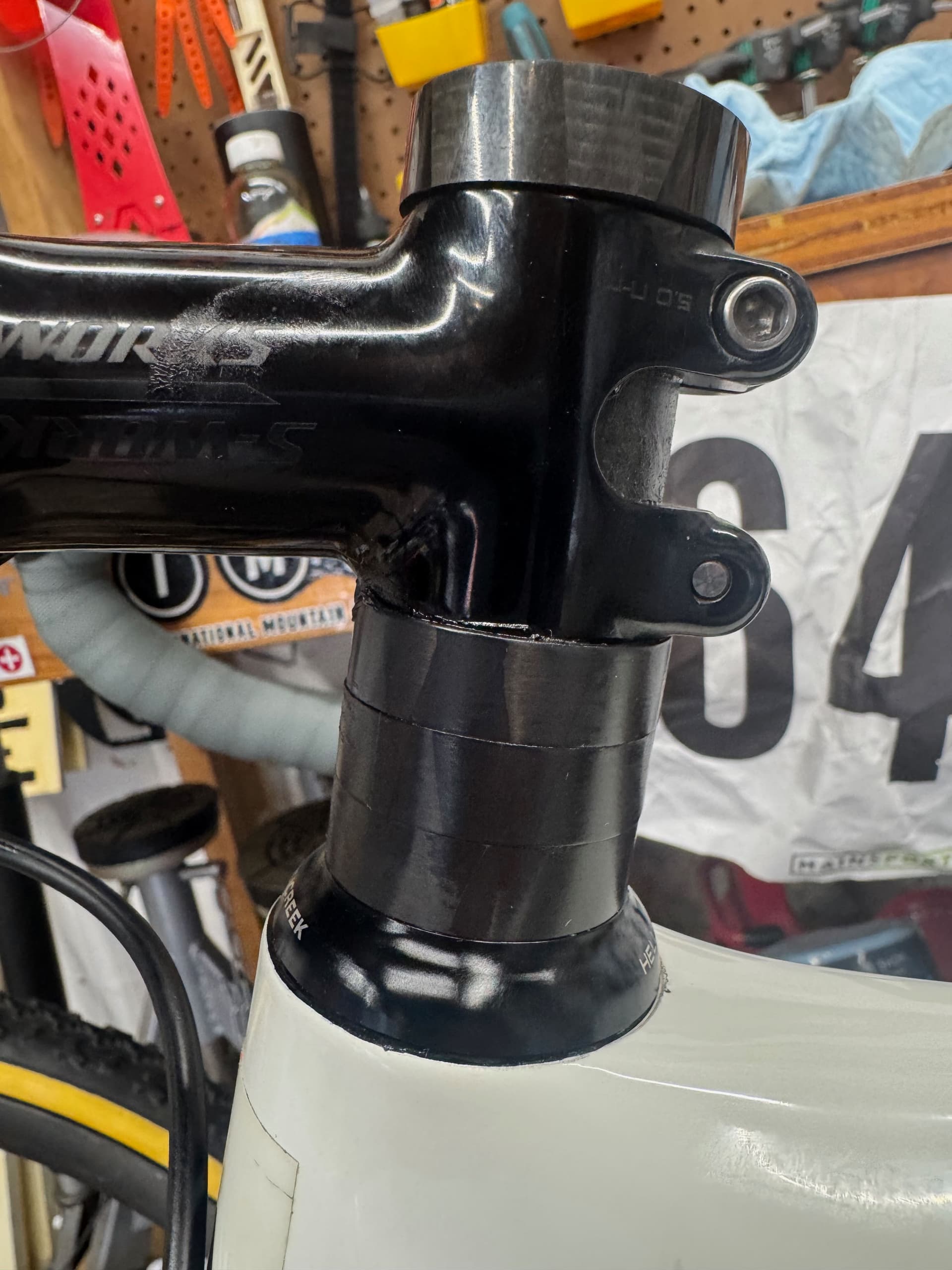

Mine worked better after I took it apart and removed two QC stickers from the mating surface of the compression ring and headset spacers. I was quite surprised to see lightweight spacers which suggested that the headset isn’t just a minimum price product. However it still doesn’t work properly.
I experimented by replacing the stock lightweight spacers with solid ones and adding a Wolf tooth headset cap, which improved it into the acceptable category. But longer term I’d like a full wolf tooth headset when the bearings get replaced as it is simply better than the stock price point headset.

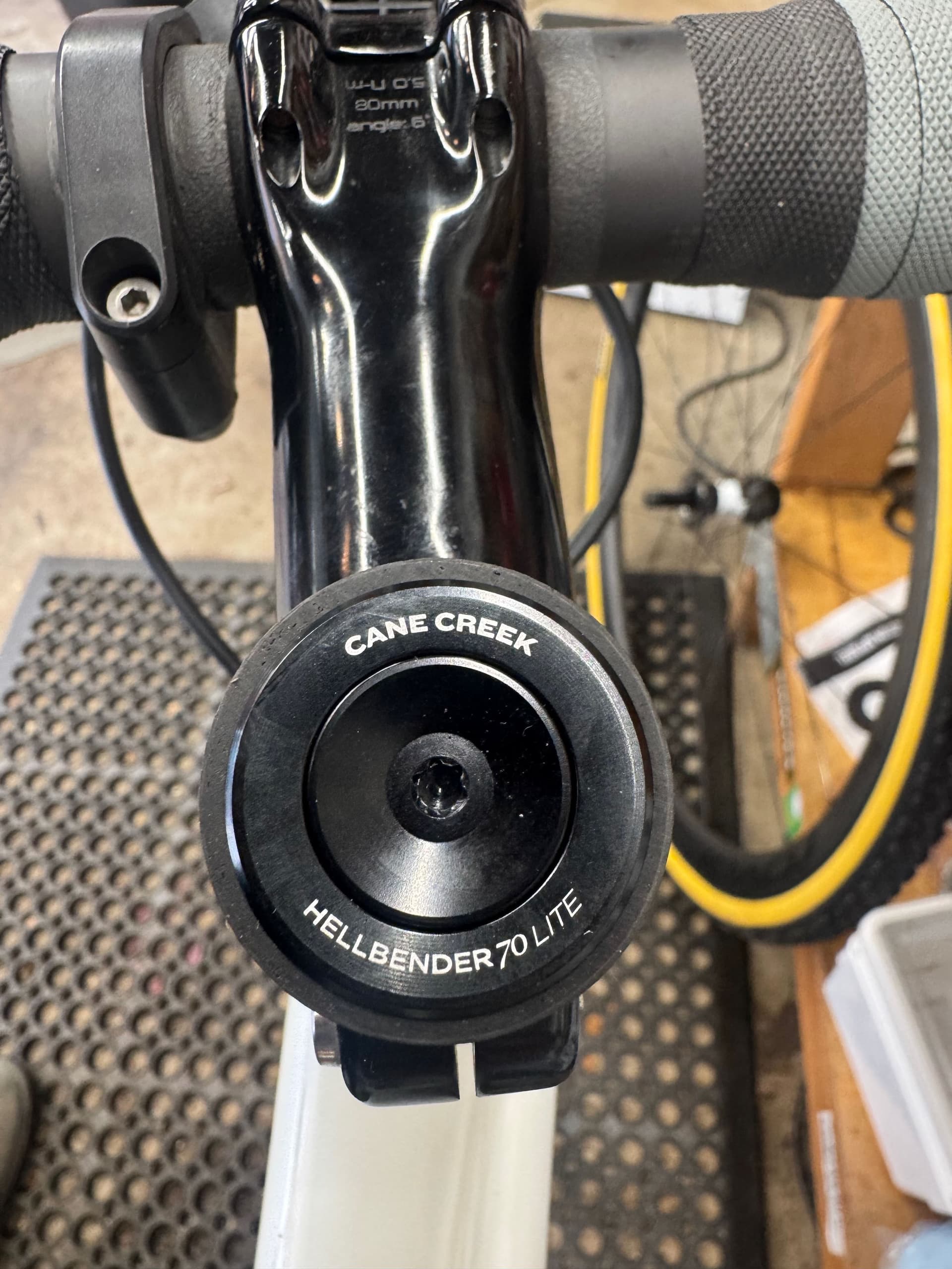

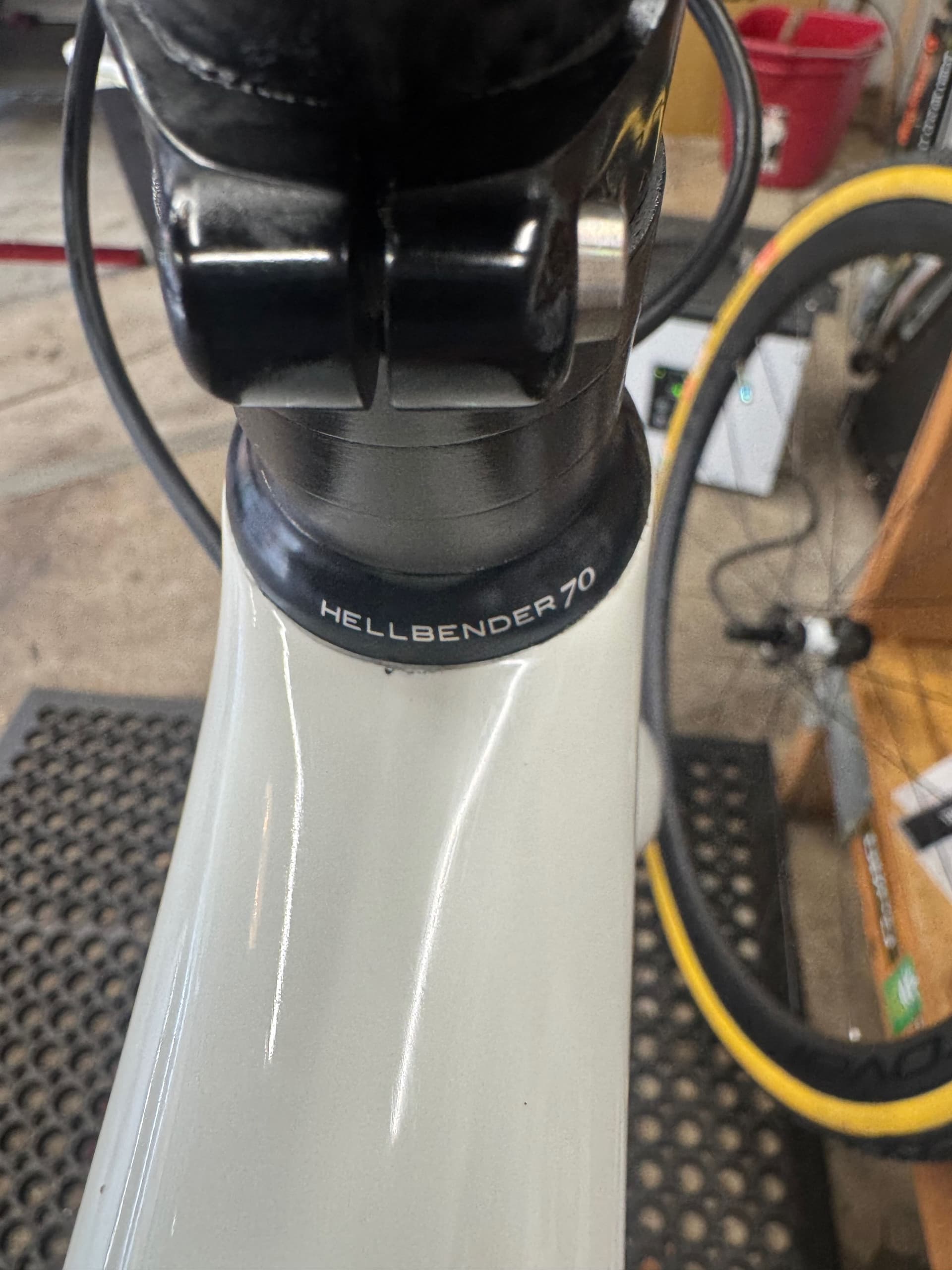

The proper and elegant fix for this is Cane Creek park number BAA2471! It installed in a jiffy - upper and lower bearings, cover, dust cap and bolt. It is very well made and a 100% drop in replacement. The only recommendation I have is to put some grease on the o-ring of the cover and the top of the fork tube to make it easy to slide everything on. Highly recommended!! This is a Hellbender 70 Light kit specially made for the Crux. Hellbender 70 Lite
Note: The Cane Creek 40 recommended in the YouTube video did NOT work on my Crux. Cane Creek specifically recommended the BAA2471 part. And I contacted Wolf Tooth and they did not recommend their bearings, saying only they “might” work. And Chris King recommended AGAINST using their bearings for the Crux, “you would not be able to set the preload correct for both bearings (ours requires a higher bearing preload). This difference in preload can cause premature wear of one of the two bearings”.

fwiw a $2 replacement headset shim was sufficient to solve the headset issues on my current crux.

I was able to more or less solve it with an extra microshim (like the FSA micro spacers) between the dust cap and compression ring. Start with one, but sometimes you may need two.
I can’t sorry. My LBS took a look at the issue and surmised it was a spacing/bottoming out problem so they rifled around in their parts box and found a slightly taller shim (pretty sure that was how it was different) and put it in. As others have said, no special part required.

I solved Hels’ headset woes with a couple of generic shims. I don’t know what brand my LBS had but Cane creek have a version of these.
I believe Jase’s LBS replaced the compression ring, not the expander plug. They obviously got lucky with a ring that fitted and was fractionally taller than the stock one.
The shims achieve the same result.
