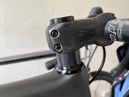

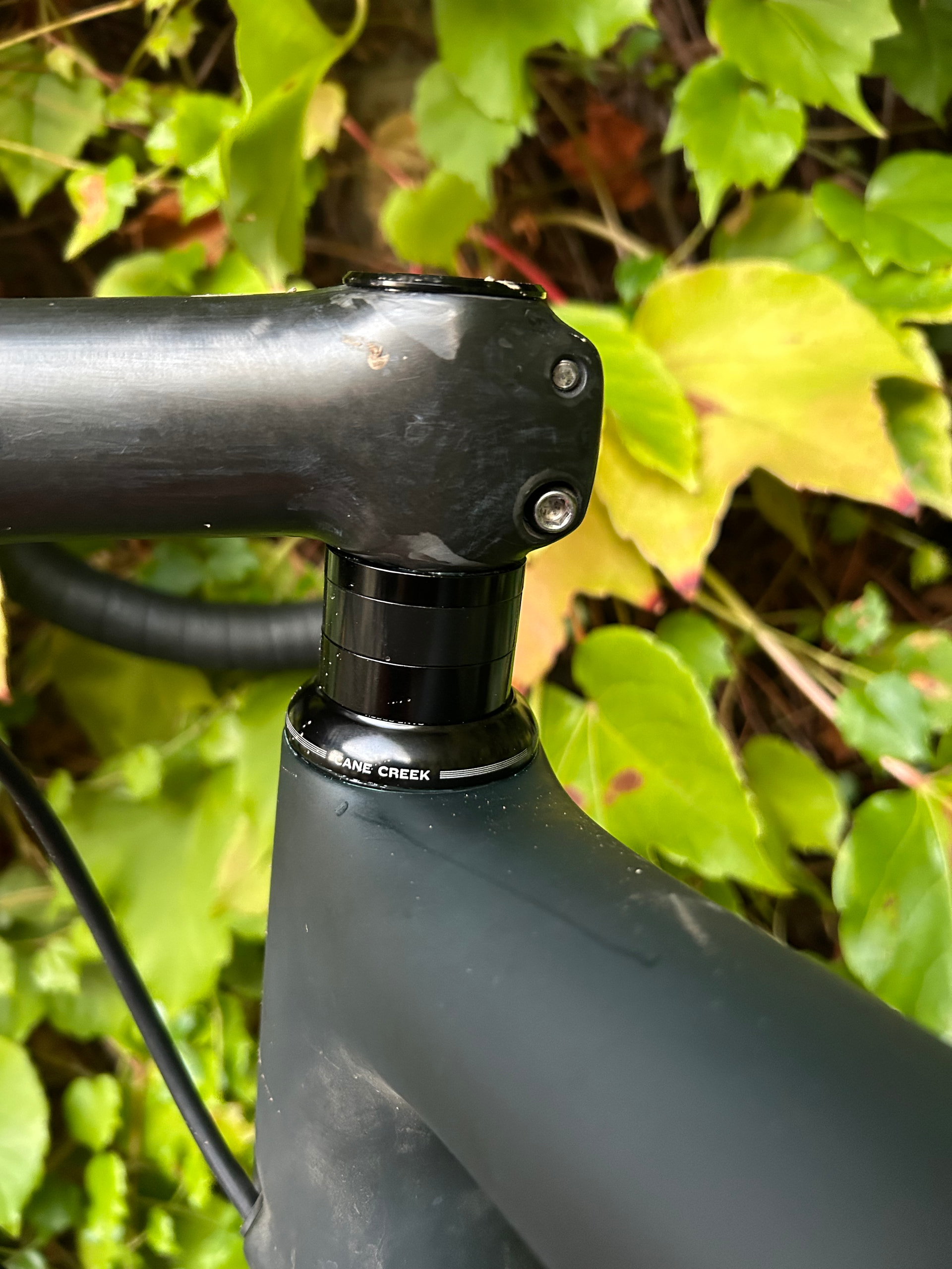

For anyone wondering that’s what a ‘Cane Creek 40 IS42 short’ looks like installed on my Crux. I had previously tried microshims between compression ring and bearing cover as well as a different compression ring.
I only replaced the upper part of the headset, still using stock bottom part of headset
This Cane Creek product seems to have solved it for me. I also switched to solid headset spacers rather than the scalloped carbon ones.

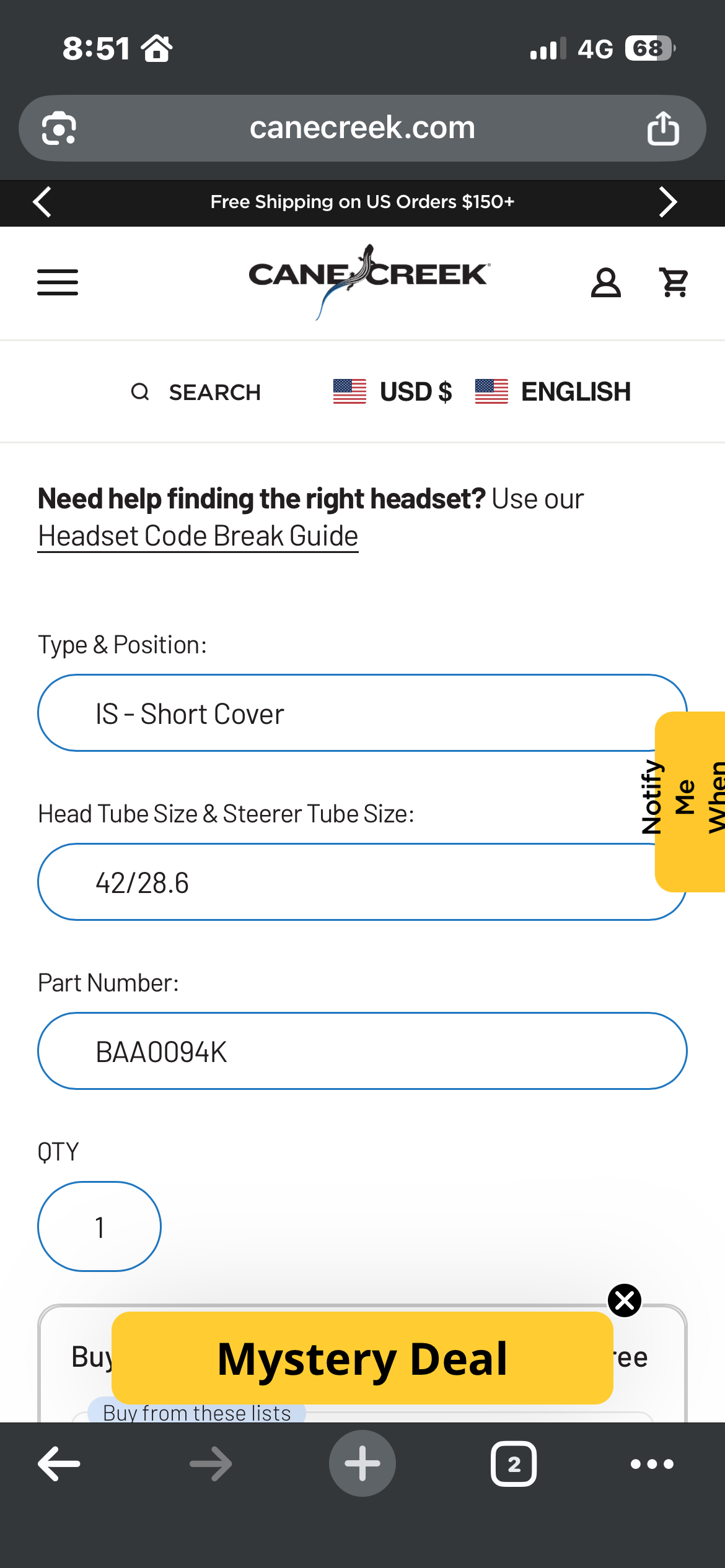

Do you know the part number / name of that particular headset?

John, are those the Cane Creek spacers that are designed with a double level lip that nests inside the spacer above it?
Why not replace the whole headset at once? The top and bottom are designed to work together. As Jason pointed out back in October 2025, the correct part number for the Cane Creek headset in BAA2471. And Cane Creek is on the EC Members Benefits list.

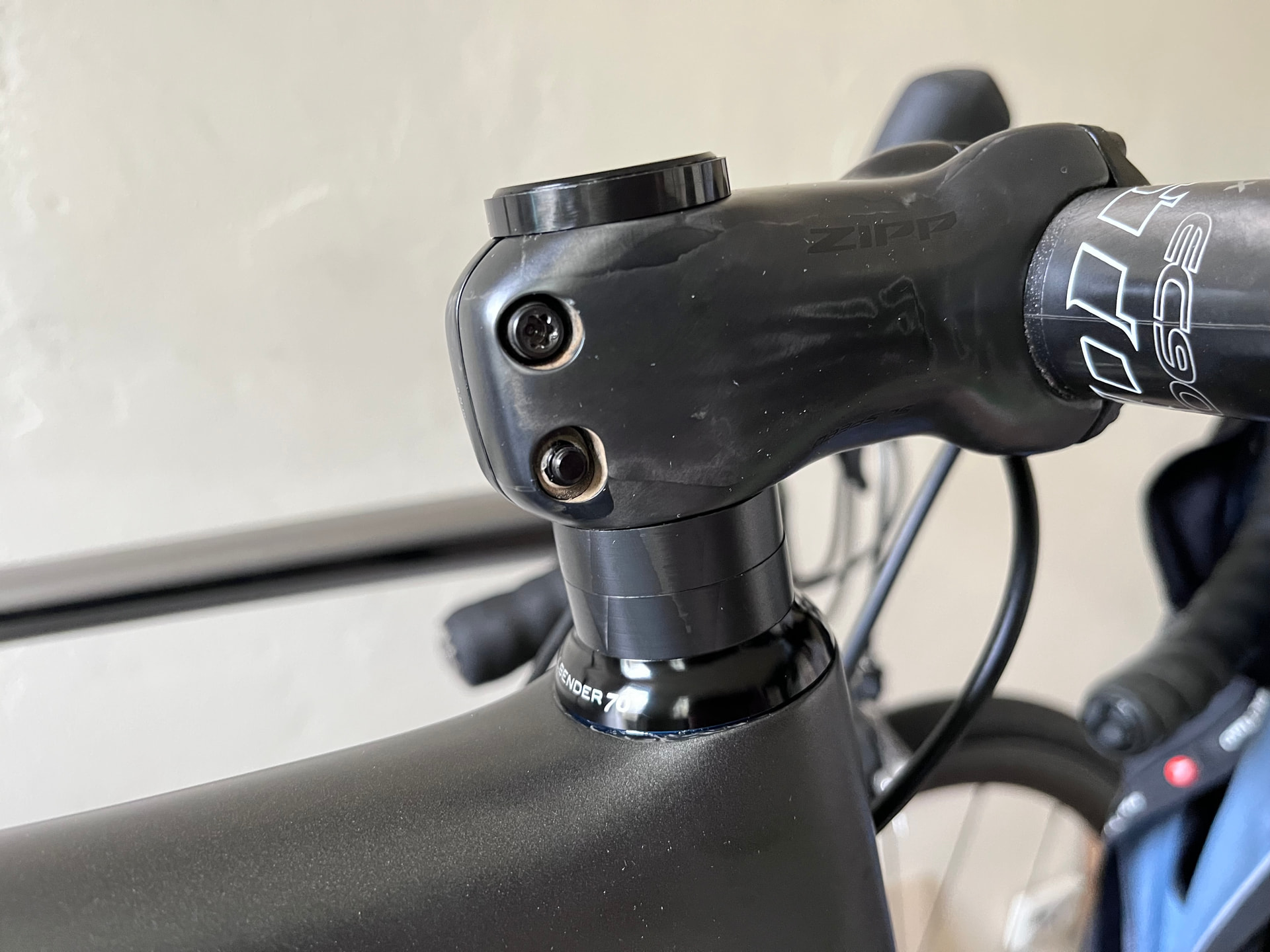

After three previous warranty requests and lazy attempts at making me go away, Specialized sent the mother of all fixes to my LBS and had them install it (first image). A cheap alloy FSA 4-mm dust cover. I knew then I was on my own.
Jason’s post above came just in time. After feeling ill for a day looking at my poor, disfigured Crux, I found the comment and part number in this thread and ordered the headset. It’s been five months or so of hard riding since I installed it, and it’s still solid (second image).
I feel a little silly contributing yet again to this thread. But it was such an infuriating experience, and I have sympathy for the folks who are still having to sort this problem out with their bikes. Probably selfish angst, too. Oh well, I’m human.
I don’t know how manufacturers like Cane Creek decide to make one part or another for a specific market. But it’s funny how the Hellbender 70 Lite is made just for a Crux and Aethos. I sometimes maliciously imagine Specialized approaching Cane Creek and saying “Please, get us out of this mess. We’ll do anything,” and then subsidizing Cane Creek making this part. Ha ha, just goes to show how sore I still am about it. In any case, the headset has worked well for me.
Nope, just some solid aluminium spacers I had in the parts bin.
It’s the 40 series. IS design, short bearing cover, 42mm size for 28.6 steerer.

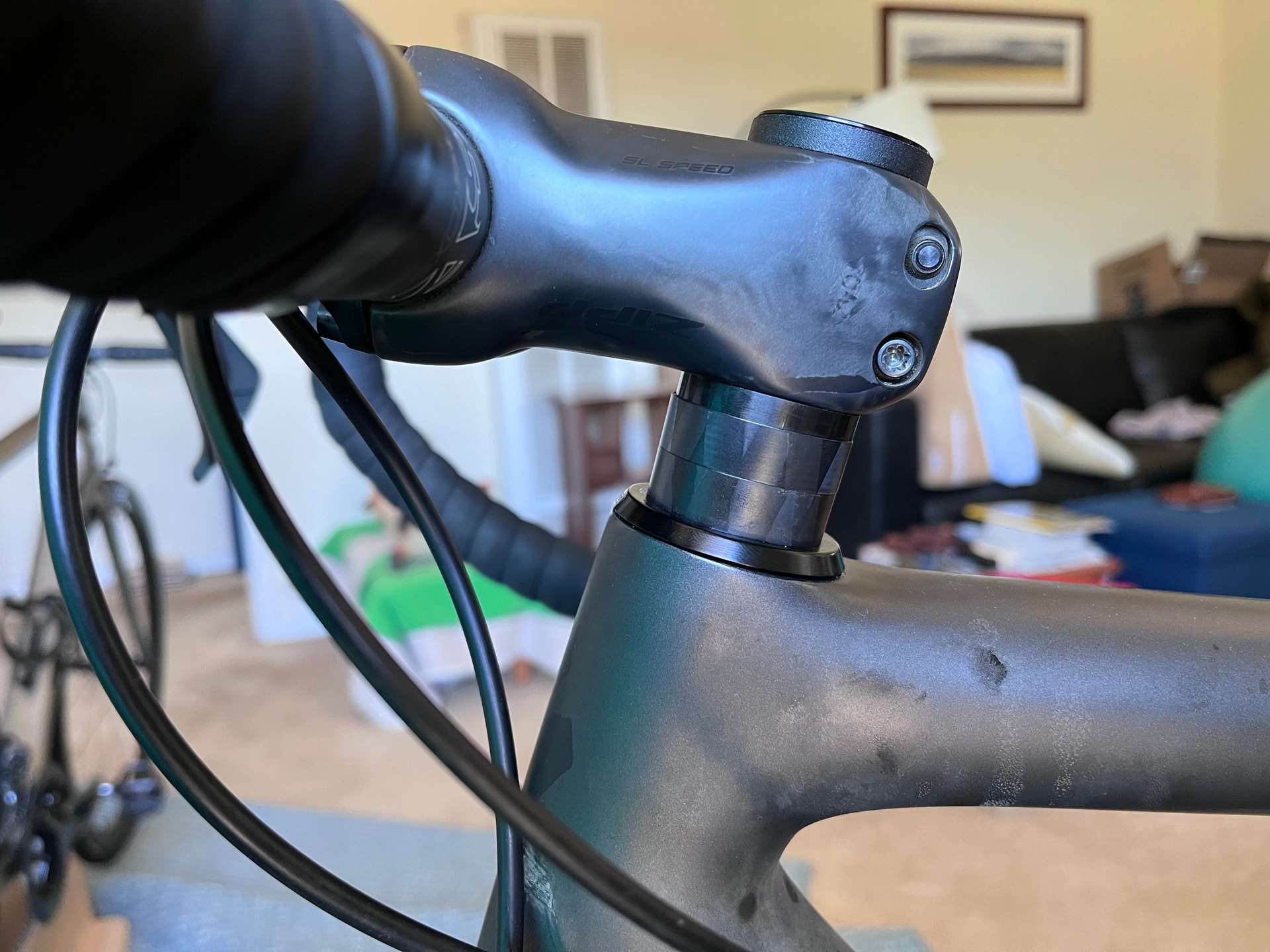

As much as I seem to have fixed Hels headset with some simple shims, Raoul and Horst have got me nervous that the thin metal shims could damage the steerer tube.
I checked it this week and it is unmarked. Phew.

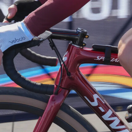

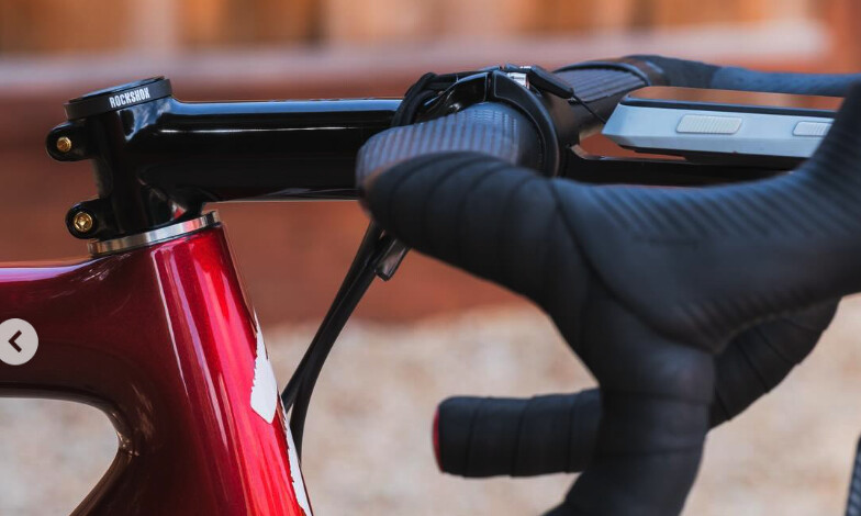

Seen at Sea Otter on Keegan Swenson’s Crux. I have never seen this headset setup before! Creative mechanic perhaps?
That’s the 5Dev cap—you can buy here: Titanium Headset Slam Cap – 5DEV
I read a forum user say that it was designed to fix this Crux headset issue but I emailed 5Dev 4x to ask them the same question and they never deigned to reply :man_shrugging:t2:

This is very different to our issue with Hels’ bike - hers hasn’t come loose since the first time I found it loose because the plastic expansion ring compressed from new and when I tightened it then the top cap seal dragged on the frame.
The shims have fixed this problem but I’m trying to get the new top cap just because I got worried about the metal shims touching the steerer. So far after 2 years the steerer is still like new. :crossed_fingers:
It was just used to lower his stem more than the stock bearing cover allowed. 0.75mm stack vs the stock 4mm.
