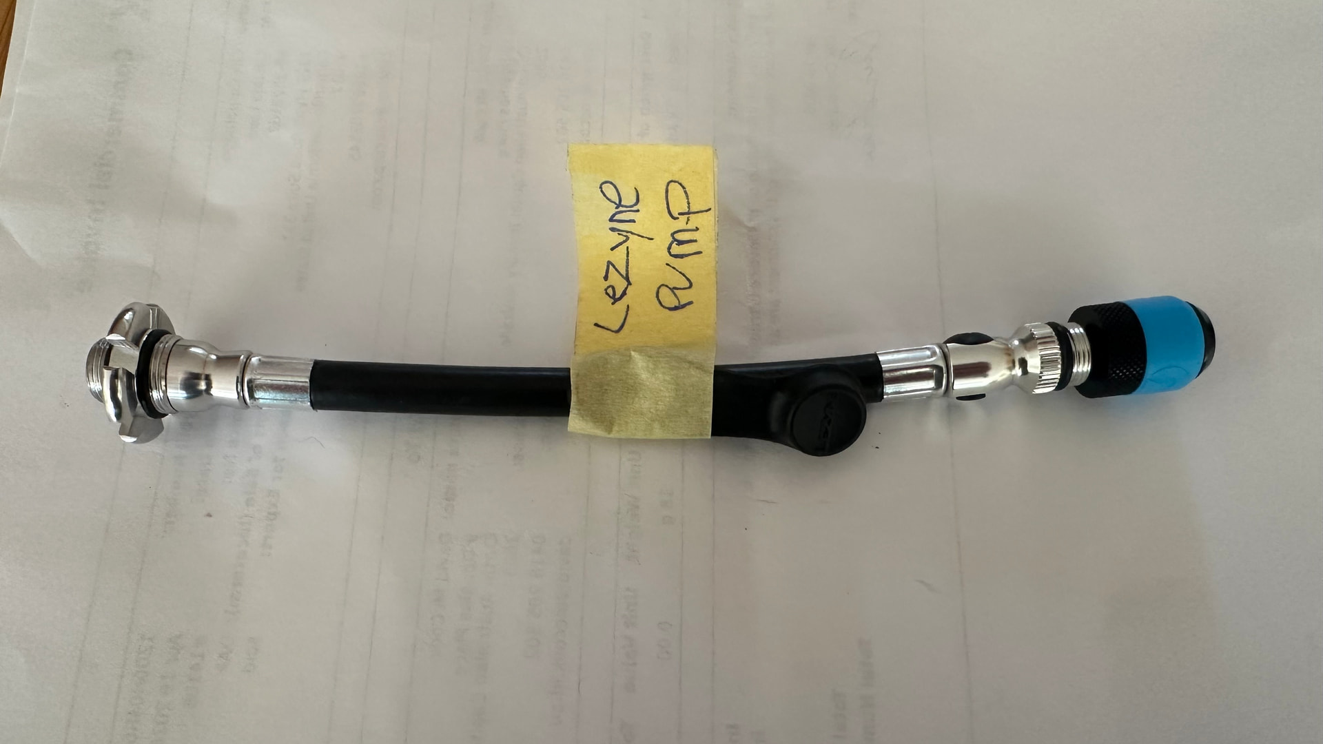

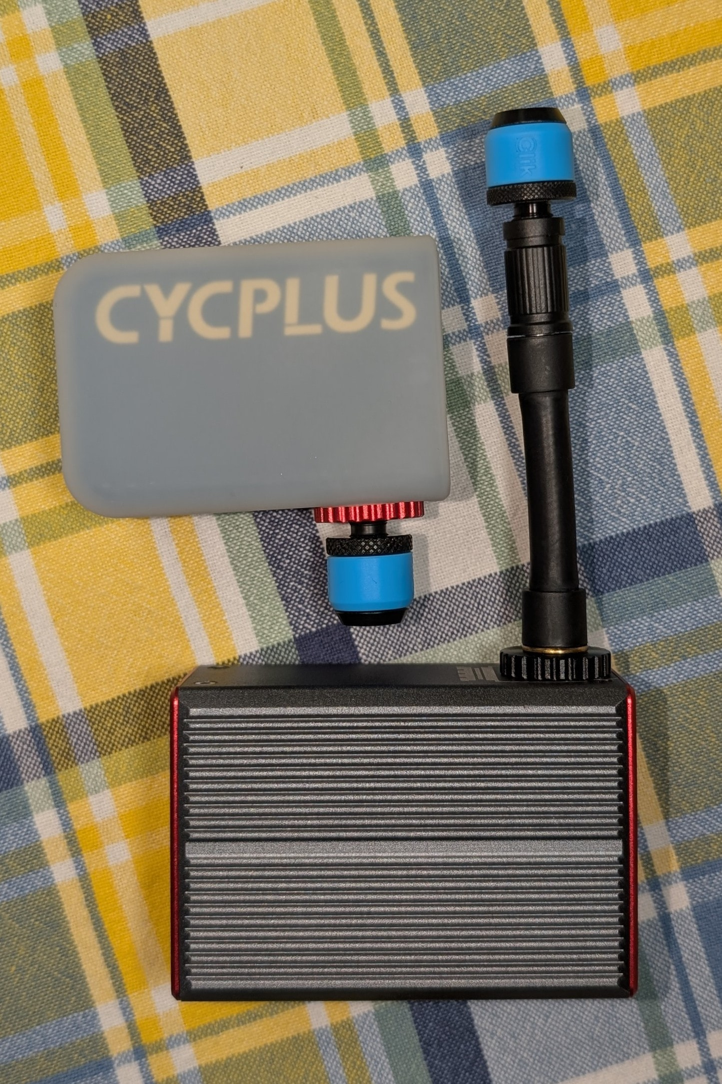

Father up in the chat @Kent_Voss posted about swapping the threaded rings on the Silca and Cycplus inflators and I did the same.
This allows for running a Clik pump head directly attached to a Cycplus AS2 Ultra.
I have the Cycplus threaded ring and mini hose on an Elettrico Ultimate, which works great and if I could order one, I’d probably have the Silca threaded ring on both pumps.

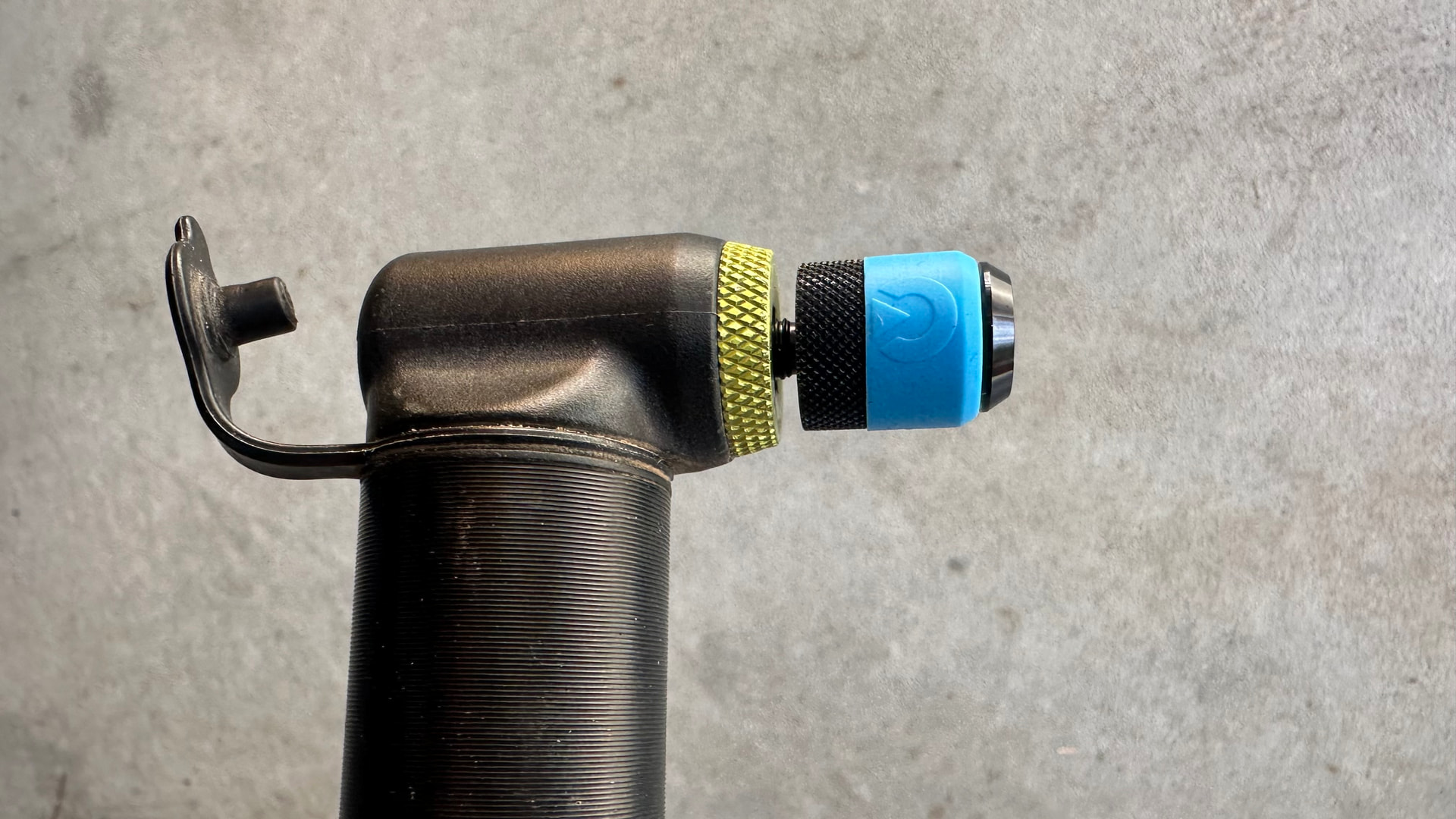

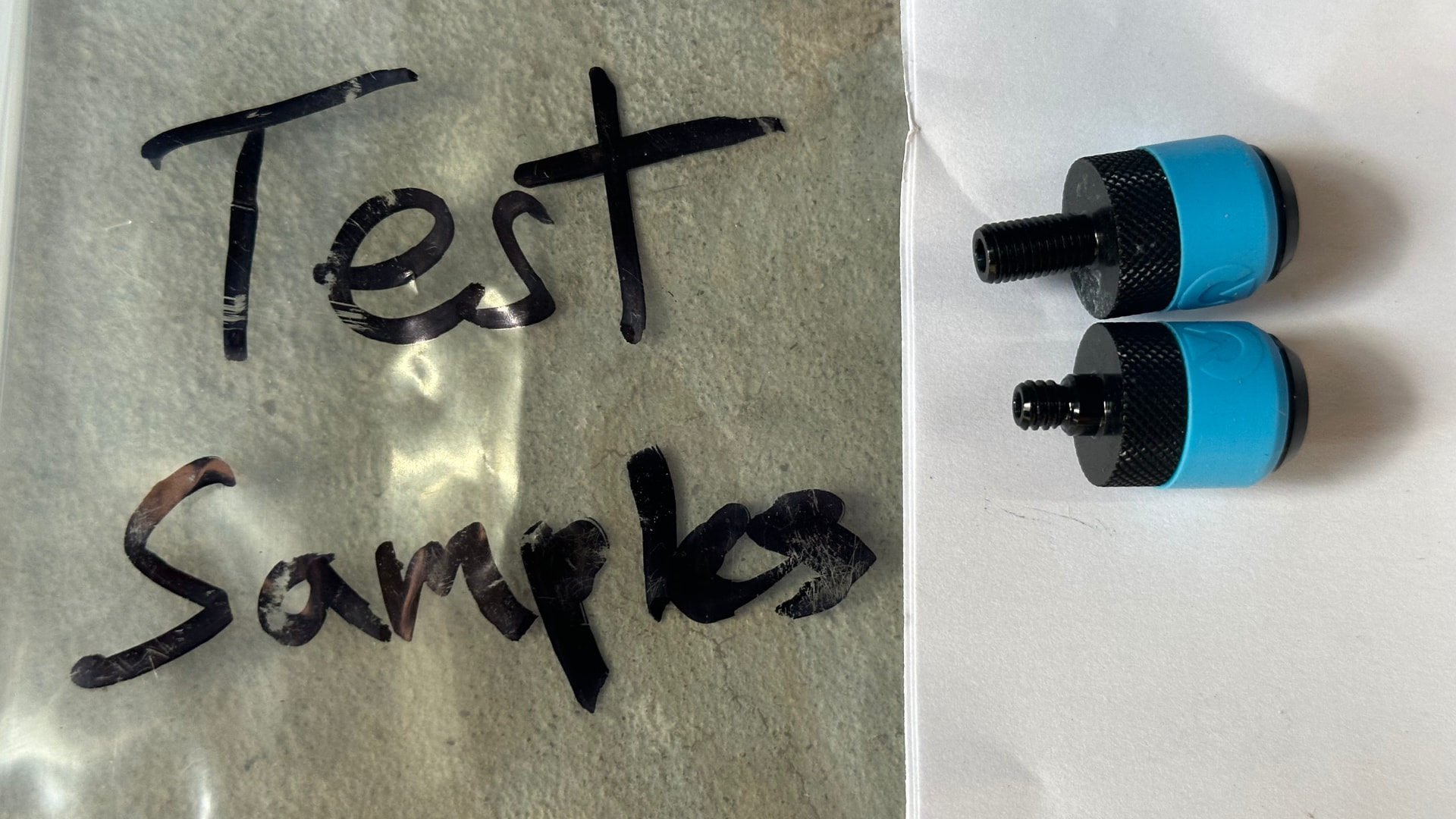

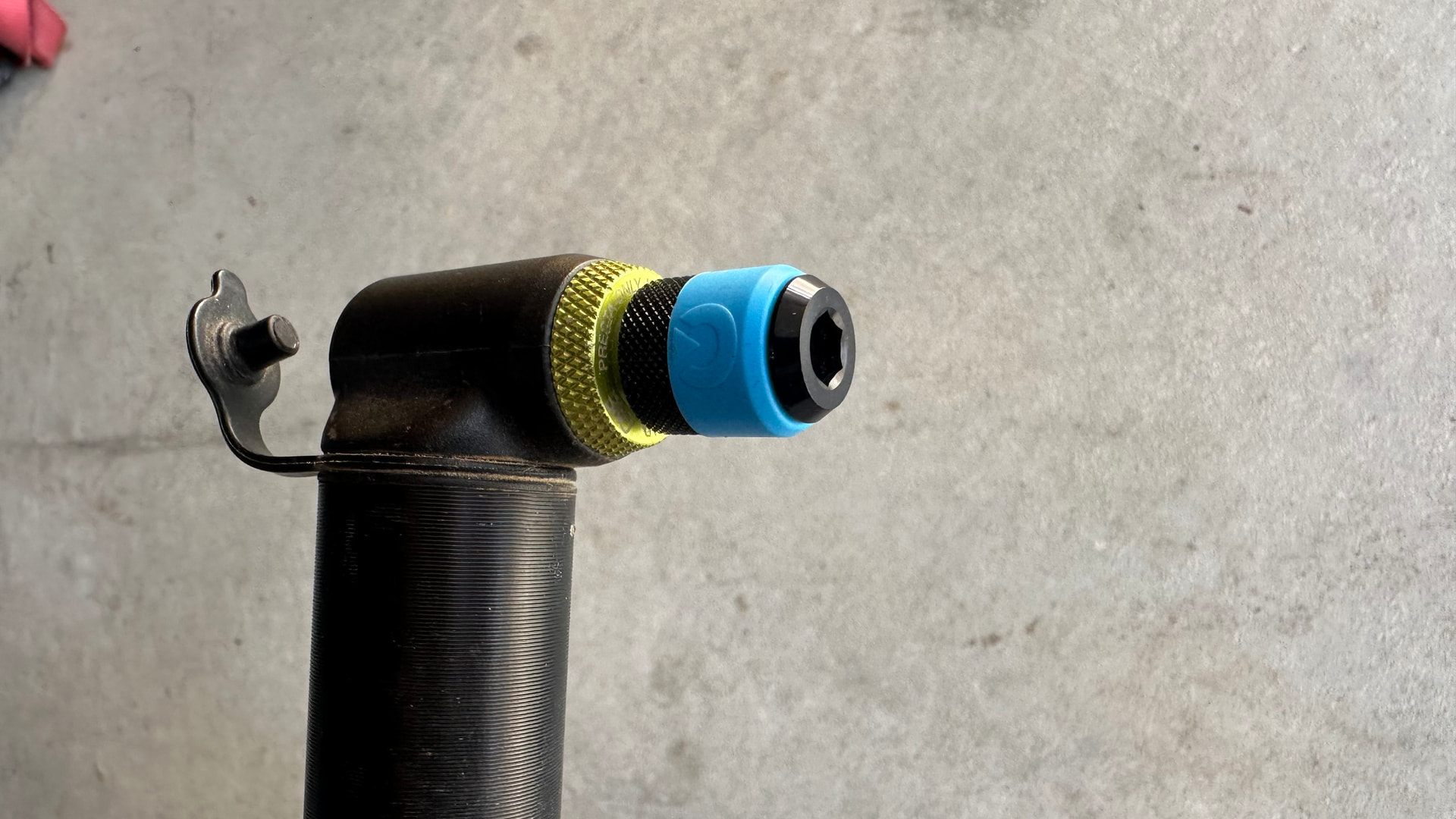

The prototype presta pump - clik valve adapters arrived - they are great!
I’m quite intrigued as to why they took so long to make these, because they are the #1 thing I’d want when replacing presta valves with clik valves, but I can only assume it was challenging to make the small diameter presta end consistently and reliably strong enough.
There are 2 versions - one with the smaller diameter thread that screw-on pumps like Lezyne use, and one larger diameter for push-on pumps, like our OneUp MTB pump.
I am happy - I have everything I need for clik valves on all our bikes and pumps.

Amazing. Does this Presta adapter work on a stock Cycplus AS2 inflator?
I have no idea - I don’t have any cycplus devices.
I’d be surprised if one of them won’t fit.

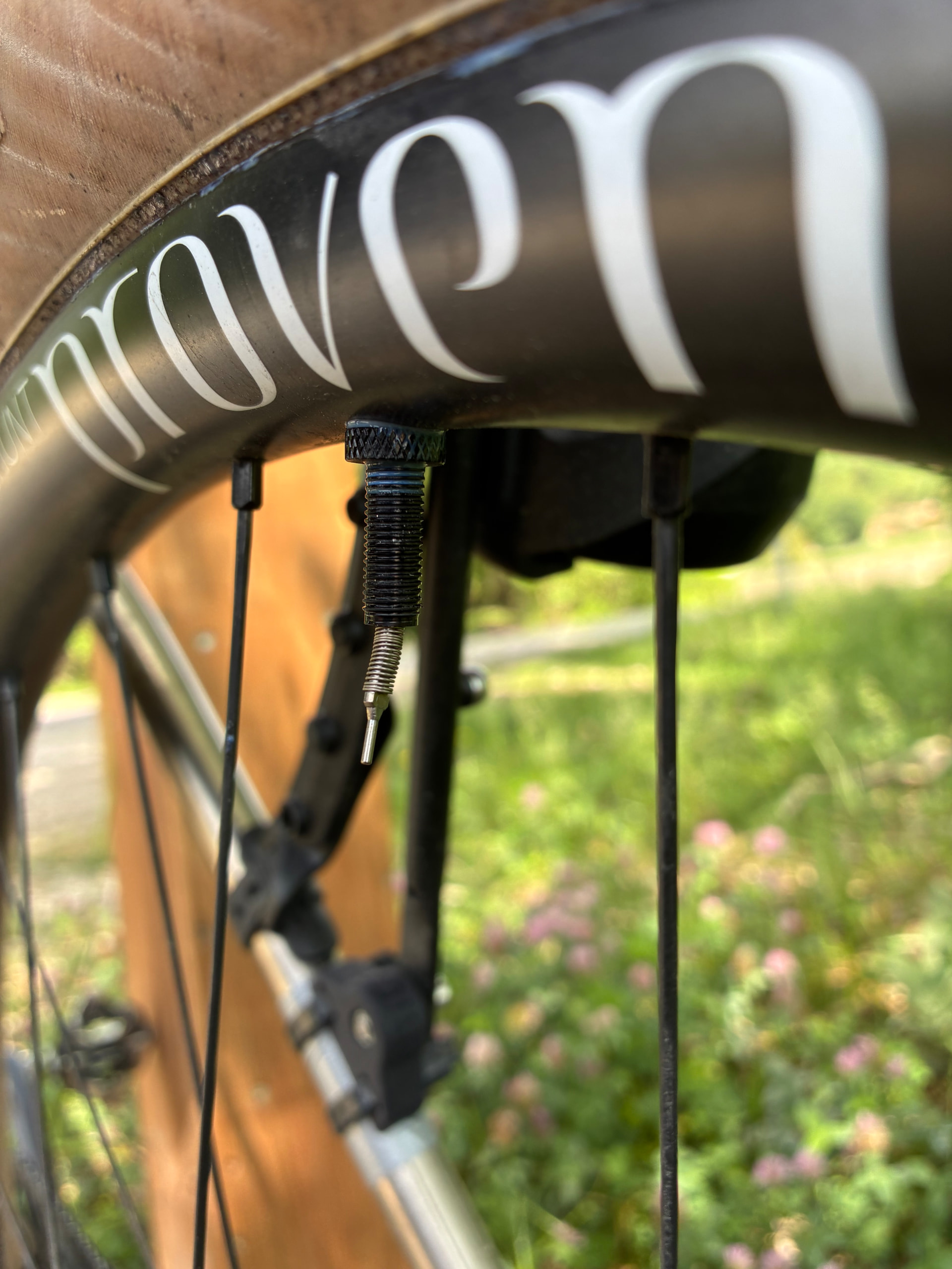

Today’s ride result, got a puncture on a sidewall and I was hoping to rely on sealant and numerous pump strokes to get home. The OneUp 100cc ended by removing the head of the click valve, the head now stuck in the pump head and the core valve impossible to remove from the body. Just ordered a Wolf Tooth one for new time.
