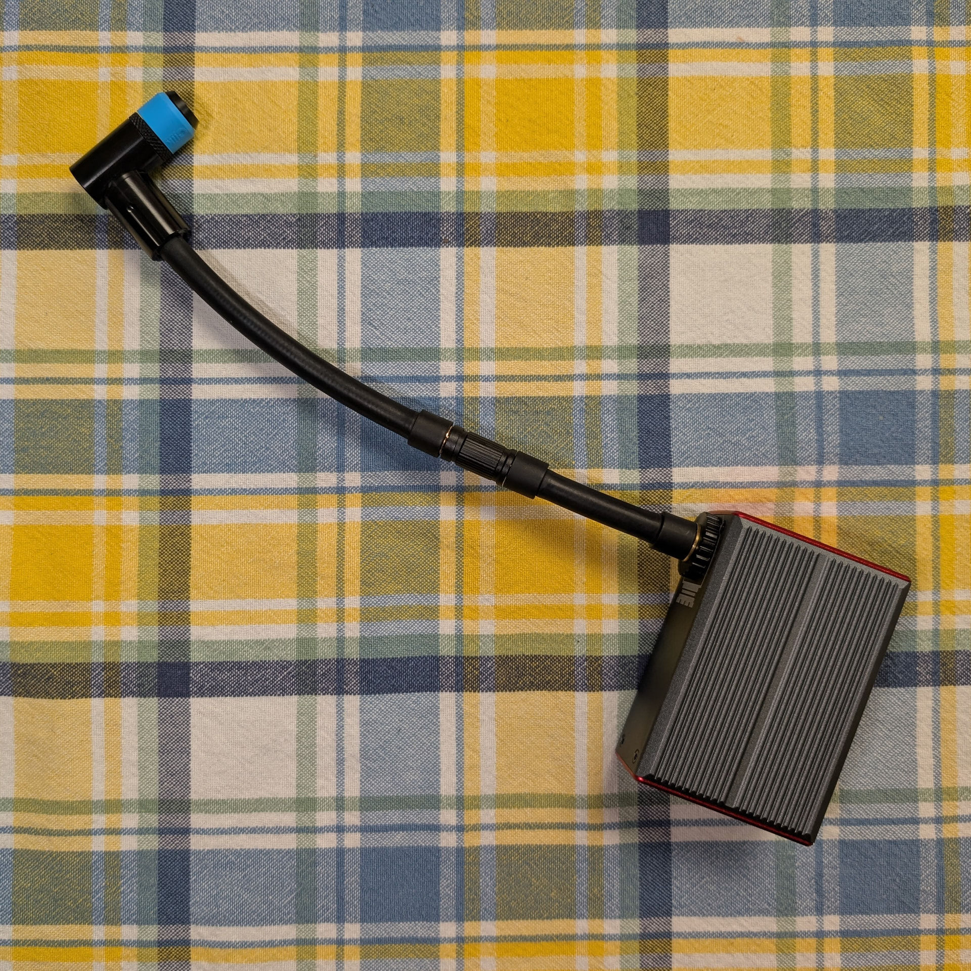

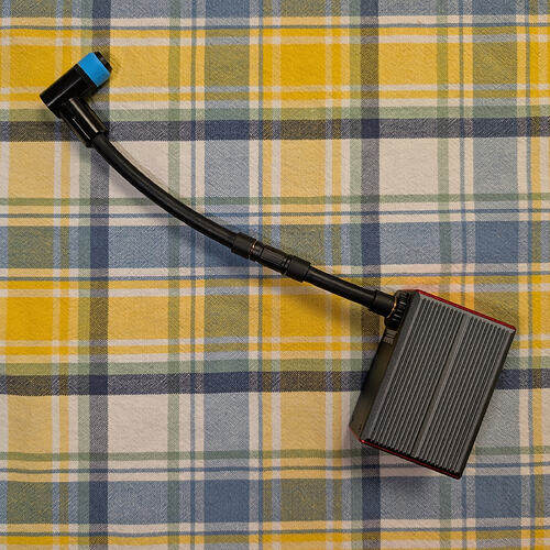

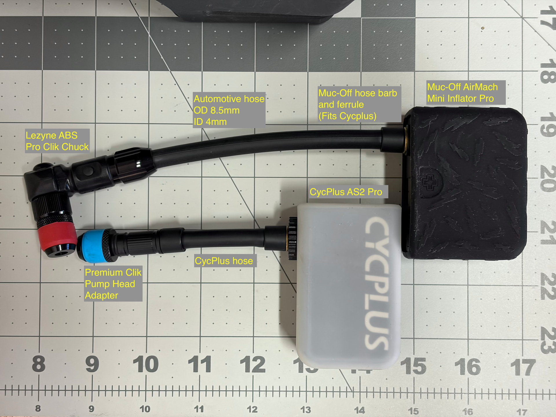

The chat about pump adapters inspired me to work on my own. I was able to build a right-angle extension hose compatible with Muc-Off and CycPlus (maybe more?) electric inflators without any adapters in the middle. This gives me a lot of maneuverability when working on 20” wheels.
I reused the hose barb and plastic ferrule from an original extension hose; some automotive hose in the garage; and a Lezyne chuck.
The tricky part is the hose because I wanted slightly more length and the original hose and barb are smaller than usual. It turns out they use Lezyne sizing, not the sizing expected by Clik’s right angle pump head.

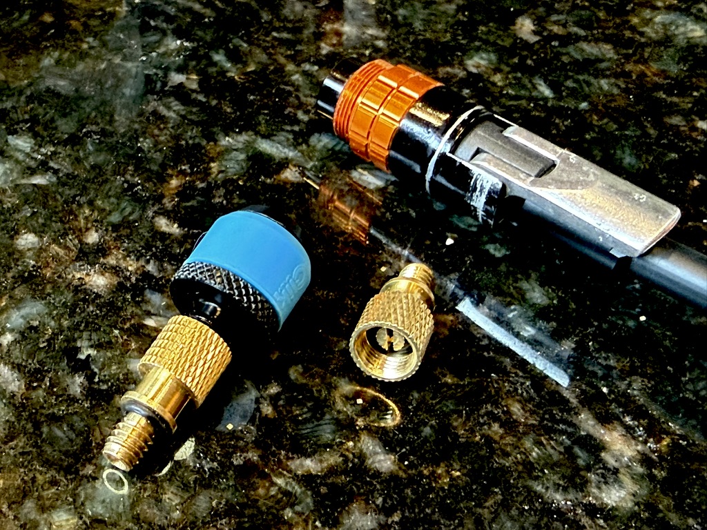

So, I had a wonky Clik valve that almost new condition but air wouldn’t pass through when pumping. So I decided to take it apart. I don’t remember exactly how I did it but I will say there is a correct side you pull from. I got it apart and was able to reassemble but the valve didn’t improve much. If I could find it I’ll try to get some photos.
