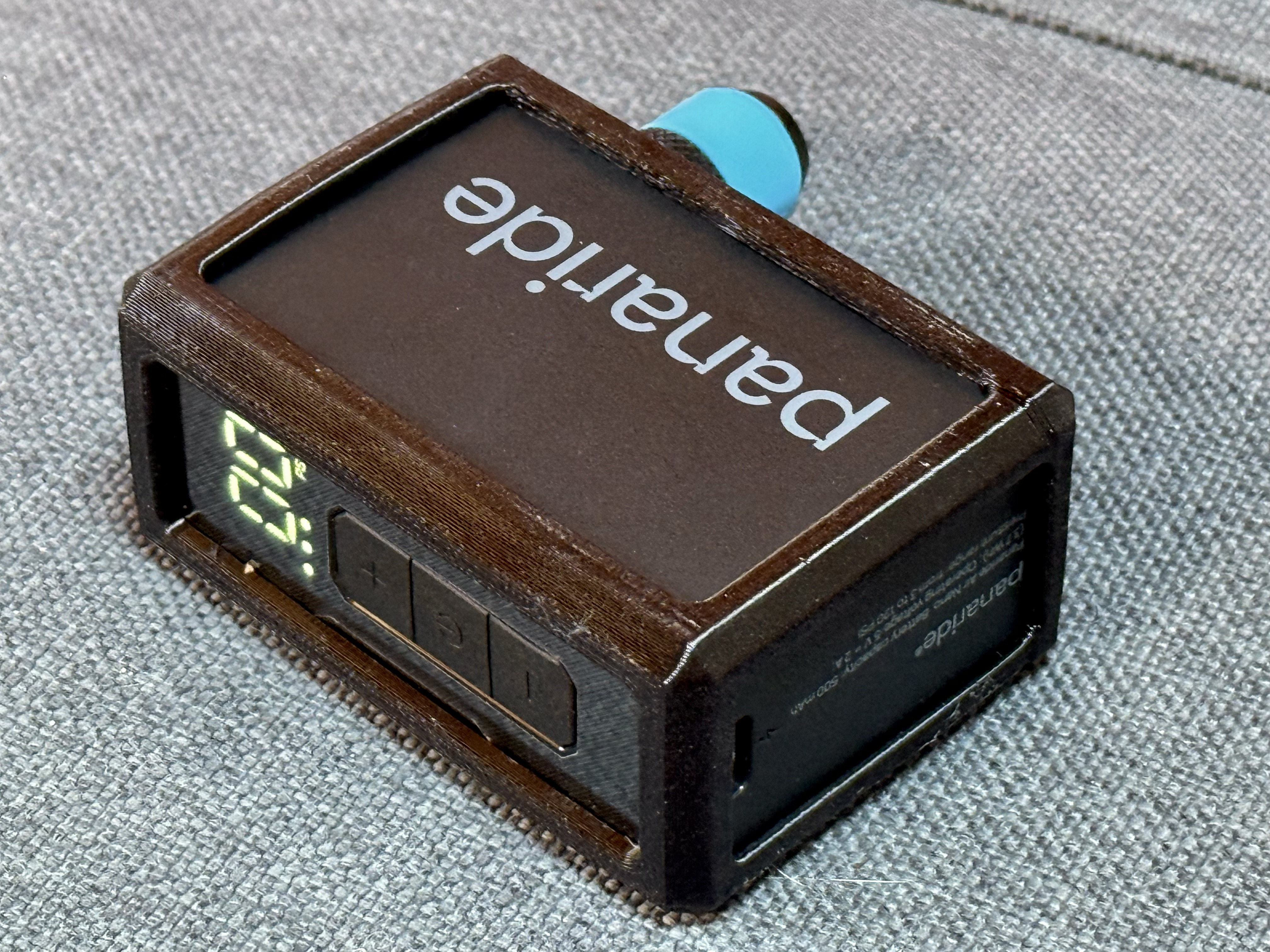

@Greg_Lepore recommended this Panaride brand e-pump a while back in this thread and it looks to be a rebranded Cycplus AS2 Pro at a quarter of the price (25USD currently). https://amzn.to/4vDkNM9
The Clik adapter threads on directly and I’ve been using it for the past month with no issues. It doesn’t come with a case so I designed and printed a TPU bumper cage for it. :smiling_face_with_sunglasses:
I’m not certain the gauge is accurate but the pressure reading seems to be consistent across several pumps I’ve tried.

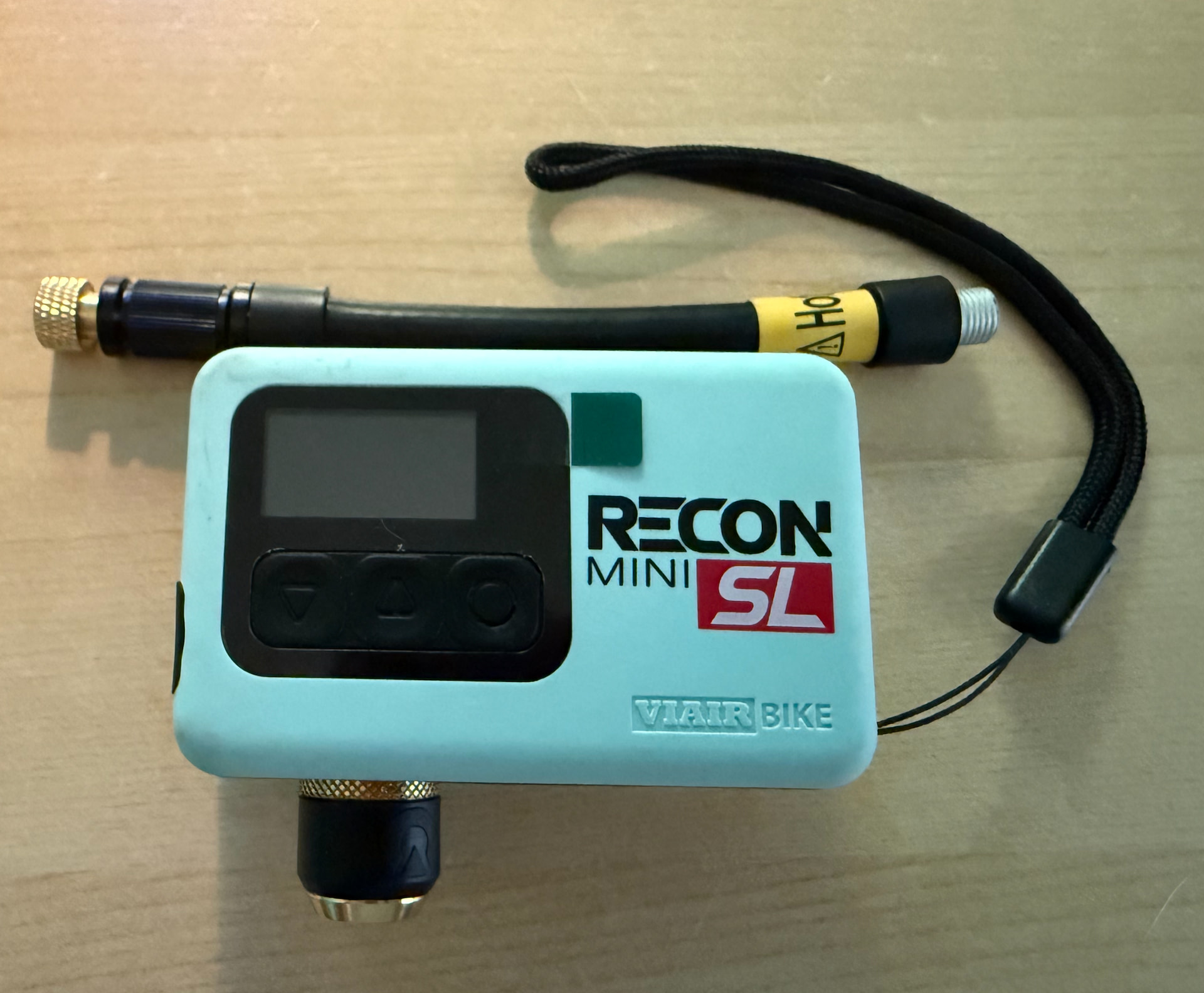

Also just chiming in with my update, about 6 months in. So far so good, no issues with sealant clogging them so far, and the ability to easily get a mini pump on and off without losing pressure and no fear of unthreading a valve core is really the #1 appeal of these things. On that: I finally pulled the trigger on a portable electric inflator, Viair makes one that comes with a nice beefy solid brass clik chuck and its working great so far (I know it wasnt top-of-class in the roundup, but they got me with the clik compatability). It comes with a schrader extension hose that I’ve fitted a little brass presta converter to in case I need to help any non-converts out.
