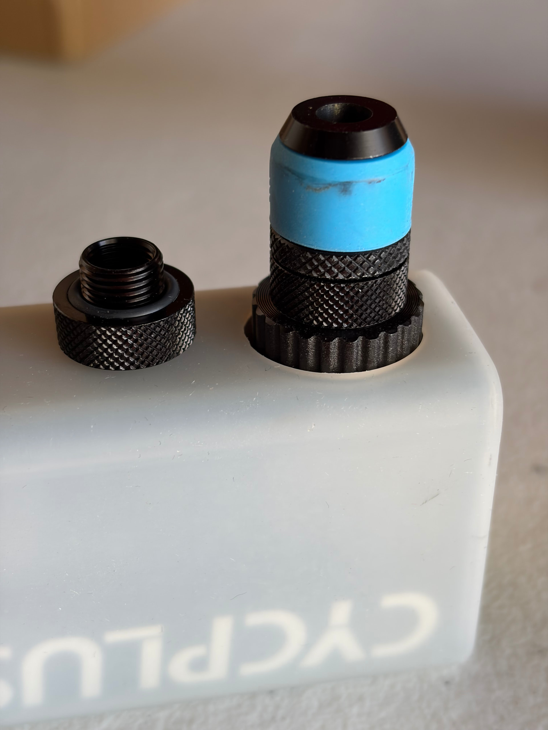

Ah damn, I have that pump and I just put in an order in with Clik Valve last week.
I was mistaken. The Clik adapter goes between the CycPlus disc and the Shrader-to-Clik adapter. Still pretty compact overall, though.

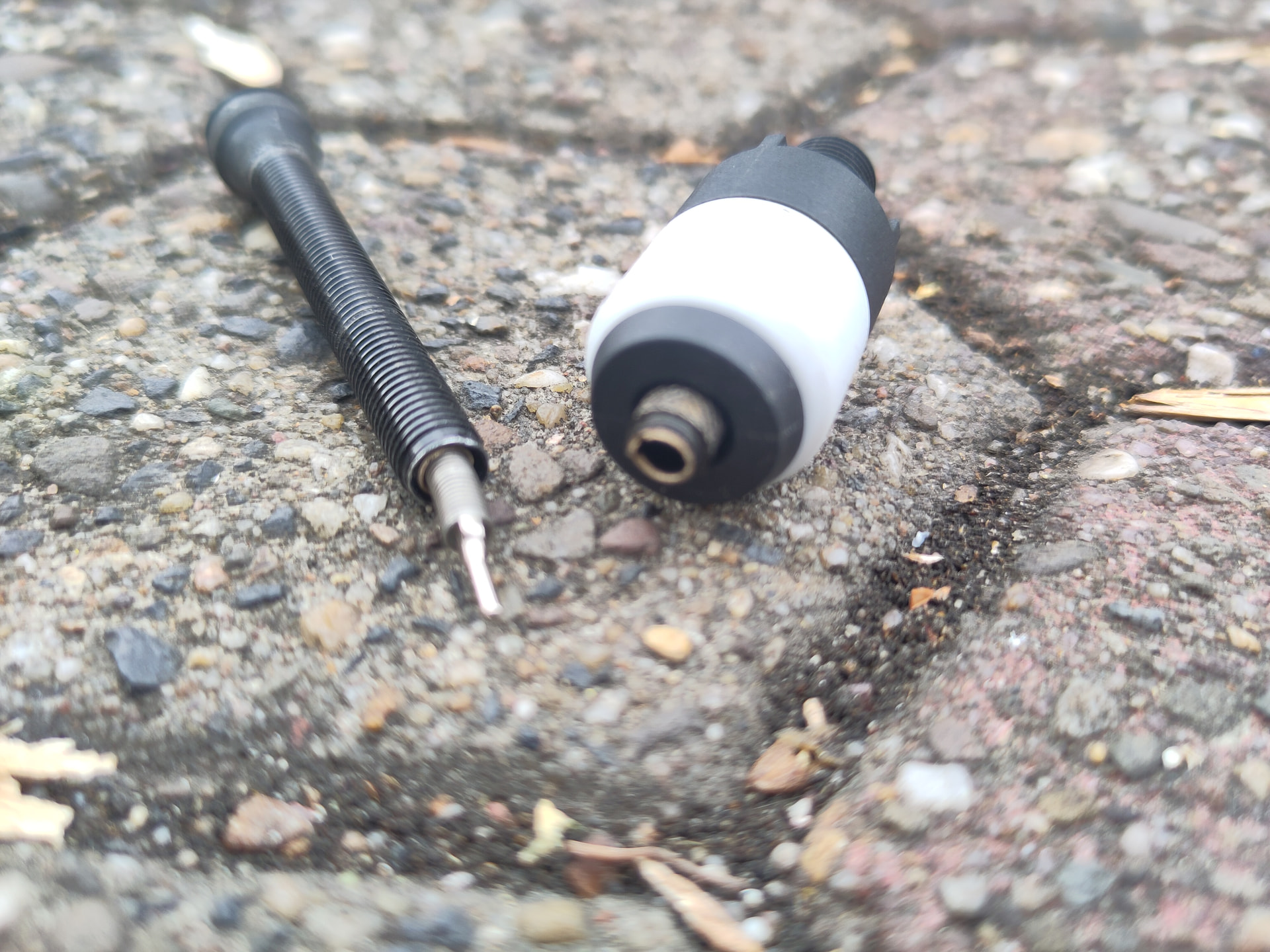

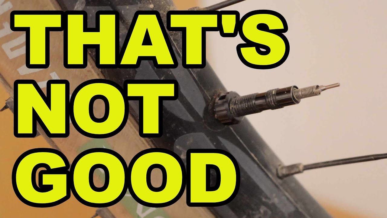

Hast anyone else experienced a broken valve? I was quite content with click valve but now I have to reconsider
I have not but Path Less Pedaled did. The outcome looked exactly like yours.

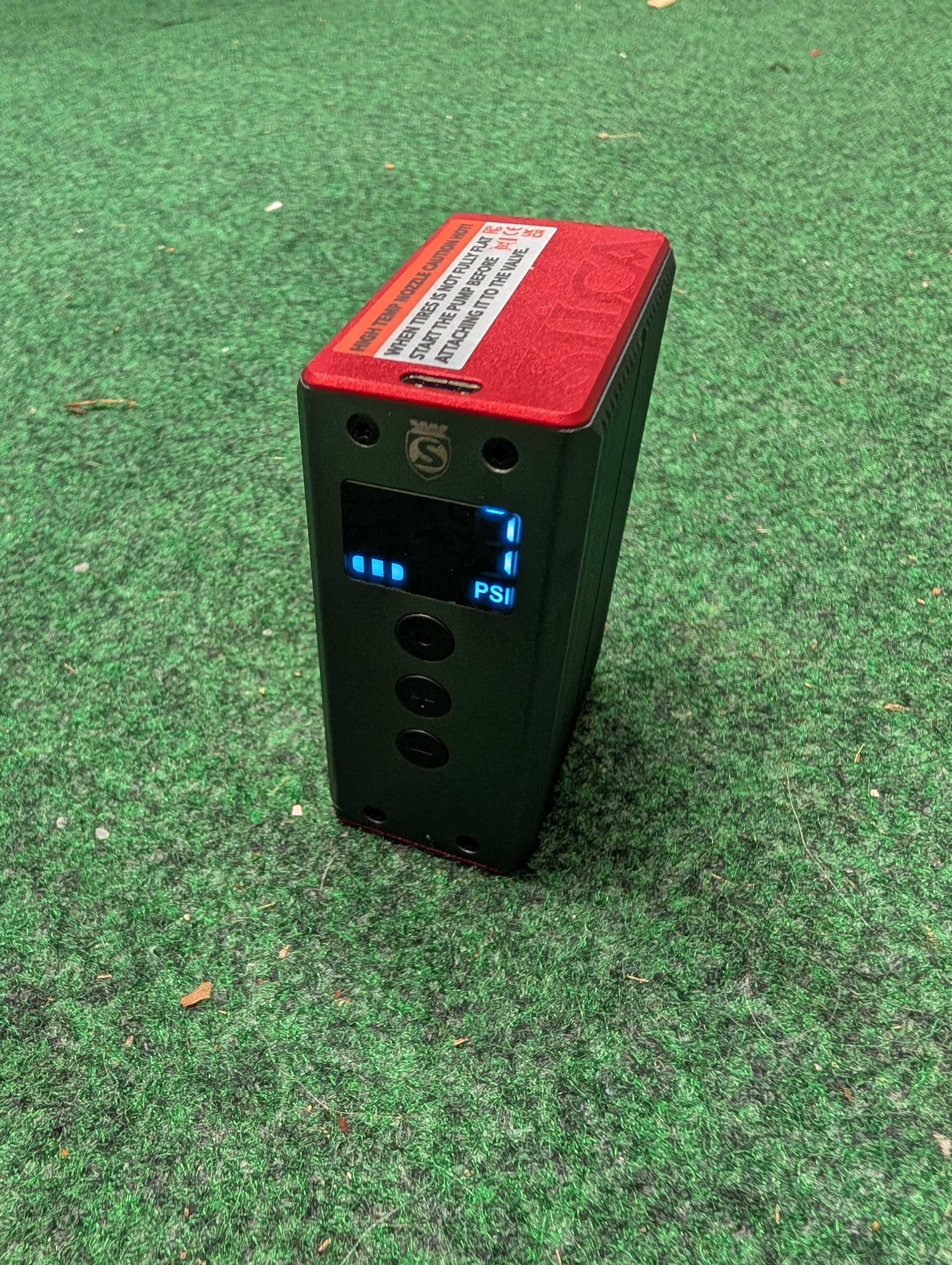

I screwed the blue Clik adapter into a nine-month-old Silca Elettrico Ultimate inflator, and almost immediately the device started “sticking” at 4 PSI at atmosphere. That figure jumped around wildly with repeated uses, and the inflator soon bricked with a permanent EE8 (Pressure Sensor Failure) error.
Silca was great with a warranty replacement.
I started the new unit with Clik only, including screwing in the adapter very lightly (perhaps that had been the problem). After a week or so I abandoned the Clik system entirely because I wasn’t confident about the pressure readings – I’d swap back and forth with my Park shop pump and the readings just weren’t consistent. I also didn’t appreciate the Clik system when I was out and about and wanted to check pressures or top up with pumps that didn’t have an adapter.
However, the replacement inflator started failing almost exactly like the original. First, it would stick between 3 and 18 PSI at atmosphere, then it would resolve after a day and multiple power cycles. I was left stranded on a ride with a puncture when the device kept rocketing between 156 PSI and ~40 PSI at atmosphere, finally settling in the 150’s, and therefore unusable. The dreaded EE8 error appeared exactly like the original pump: Directly after draining much of the battery then fully charging overnight. After a few days, this unit pulled out of it, but is currently stuck on 7 PSI at atmosphere (an improvement following two days at 8 PSI).
In this video the pump (no Clik adapter) was showing 4 PSI pushing nothing but air, then the sensor jumped all over the place after stopping the pump

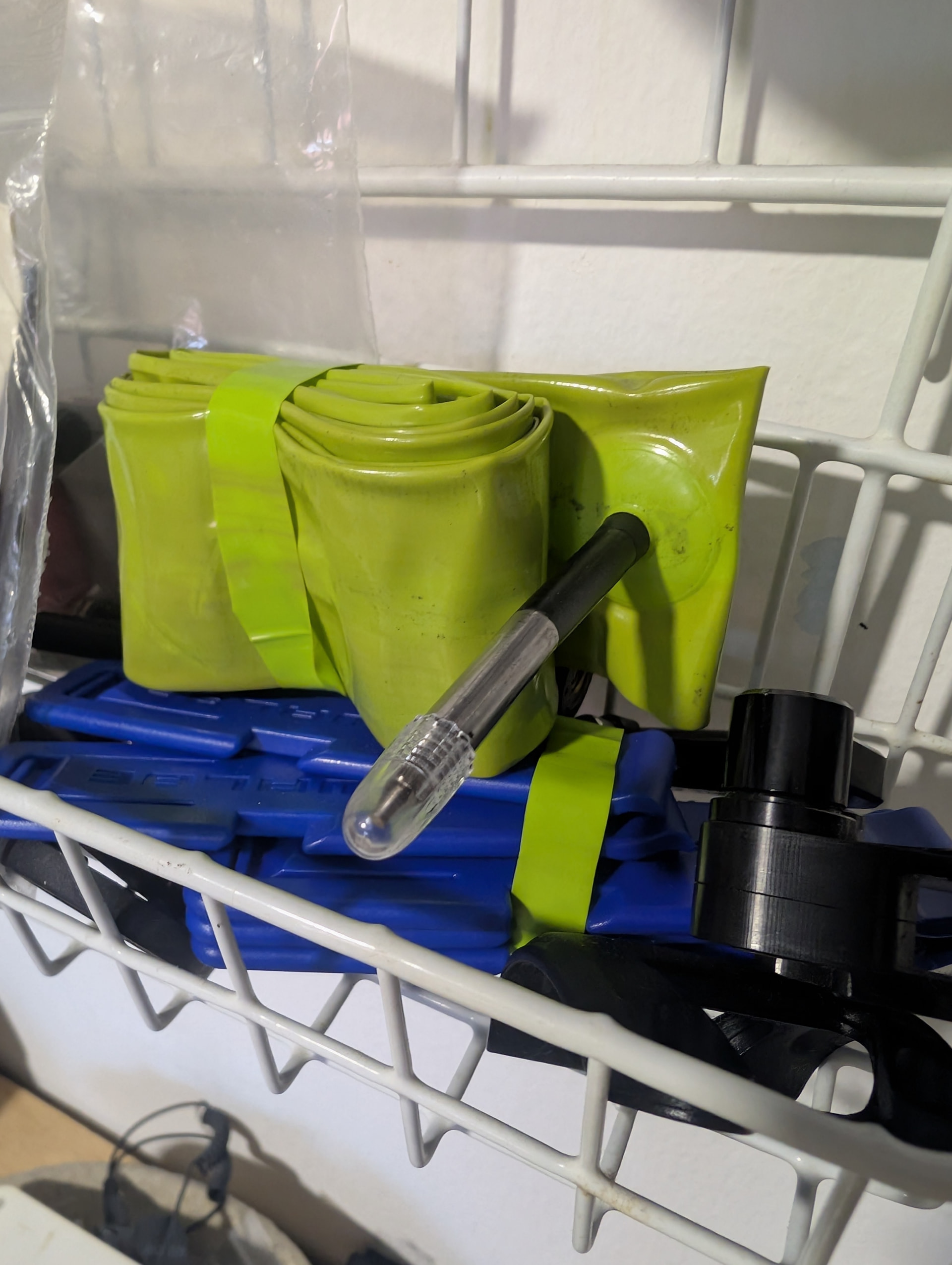

I belong to the self-sufficiency camp, so I’ve got all the bikes I ride regularly swapped over to Clik, so I never get caught out with having to swap between Prestas and Cliks. I’ve also got spare TPUs ready with Cliks in the saddle pouch for when a puncture happens. The TPUs also get re-used with patches, and the Cliks stay on them, so it’s all been good. The pump is a Cycplus AS2 Ultra with the hose fitted with a Clik head.
I’m also quite the nosey lad, and will mostly stop for other riders stranded by the road with a puncture. In those cases, I’d just get the Cycplus (minus the hose) on their tube and they’ll be ready to go in a few seconds.
