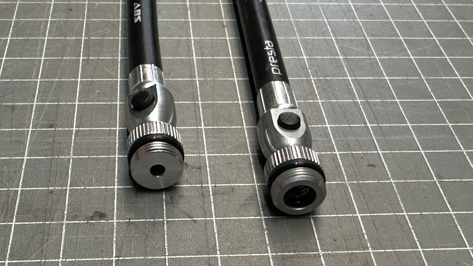

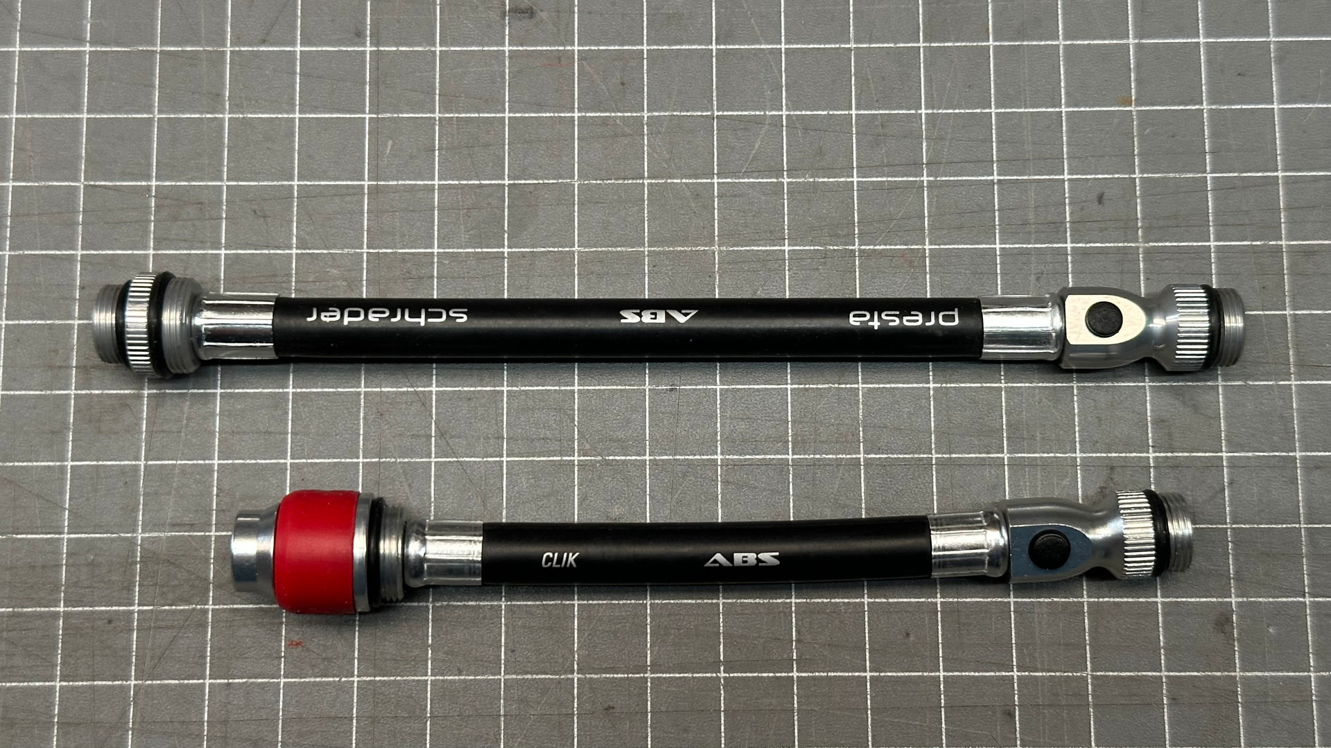

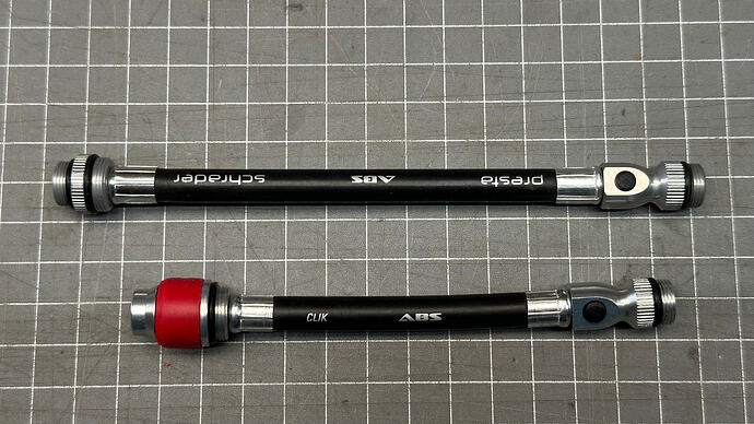

I finally managed to get a couple of Lezyne ABS Flex hoses with Clik heads for our Lezyne road hand pumps.
To my utter amazement and frustration, Lezyne saw fit to redesign the other end of the hose so it is no longer a presta valve head, as it is on all their otherwise identical hoses and hence they didn’t provide the pump thread on the end of the clik head either.
They already had the basic design with presta and schraeder compatibility - WTF didn’t they just use the same presta end piece and tap the external thread on the Clik end??? :exploding_head:
For the sake of tapping 2 threads, which they already do on their other hoses, this hose manages to lose any possible presta valve compatibility, so we have to carry another spare presta hose if we want to allow for unforeseen problems.
As we’re about to head to Japan for ~3 months, I will be carrying the spare presta/schraeder hose just in case.
FFS, I could even fix it myself if I had the correct thread taps…

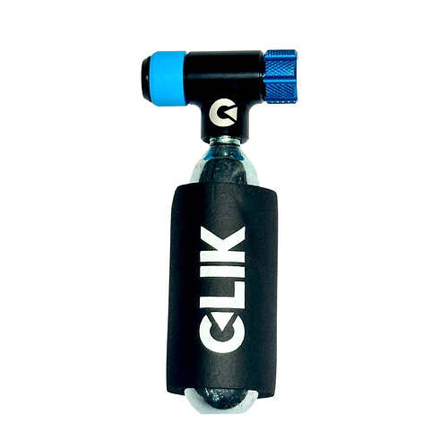

It’s been a bit since I read through the whole conversation, has anyone here tried any of the ‘native’ Clik CO2 heads? Only seeing the Clik and Lezyne ones currently, most of the ones I own are Presta Thread-On so using the adapter won’t work (but I have found they will work just pressed onto the valve…)
I have this Clik CO2 head from Clik themselves. It works very well.

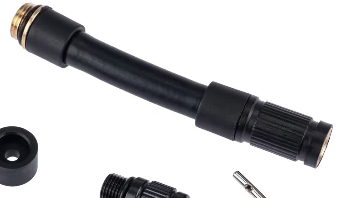

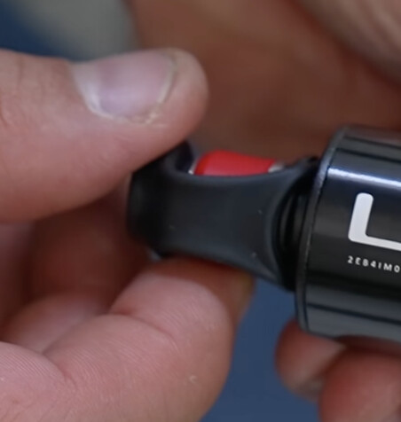

I just got the Lezyne Clik hose to use with my Road Drive. The rubber cap can cover the port on the Clik head and does have a firm grip. It’s a little stretched, though. Lezyne’s photos of their Clik Drive pumps imply they have a variant of the cap with a longer tether that accommodates the taller Clik head, but there are also images of the same product where the cap is stretched. This image from YouTube basically shows how the cap looks on my pump.

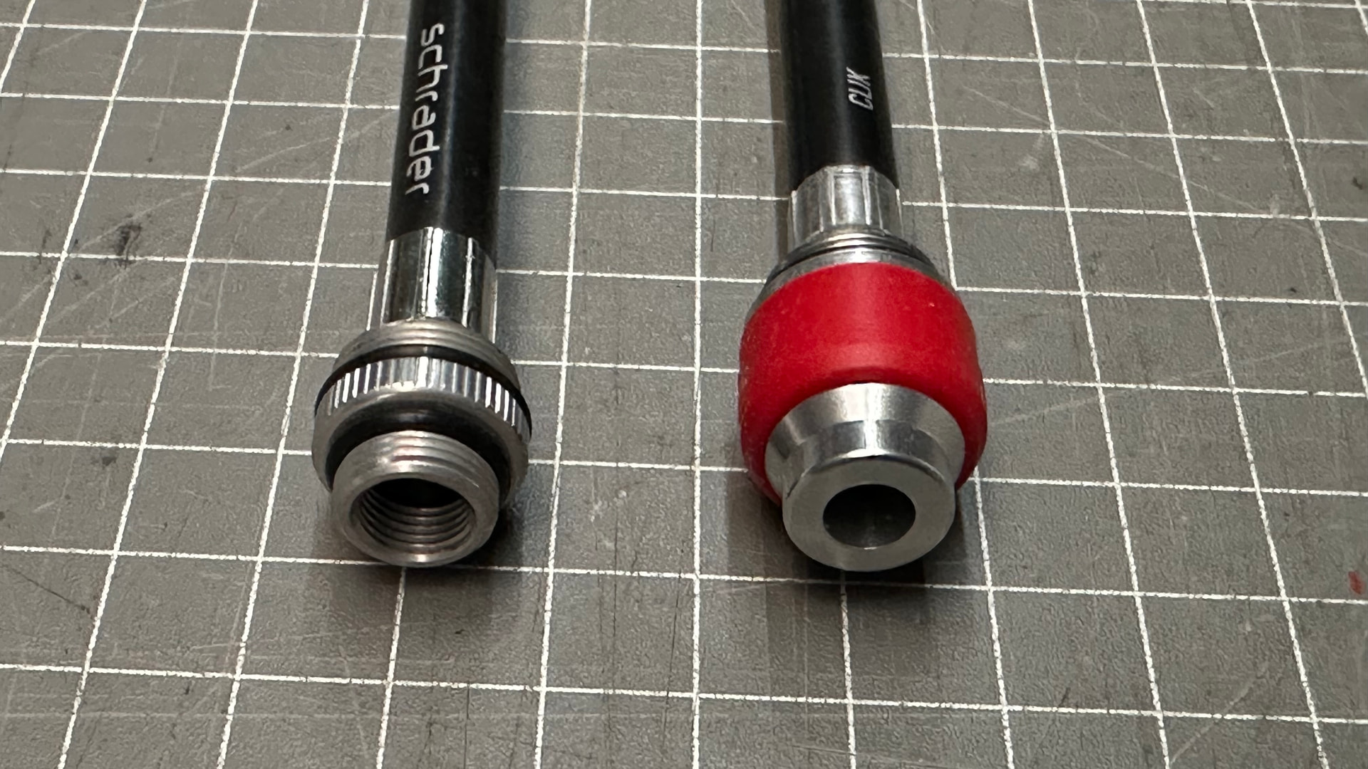

It seems like the thread to fit the outlet of a Lezyne hand pump is M11 x 0.8. The OD of the Clik head is 11mm. I’m tempted to tap mine, but there’s not a great place for an O-ring either on the end of the Clik head or inside the pump outlet to seal in pressure.
Somebody at Lezyne must have bought a giant pile of M11x0.8 stuff at a screaming deal or something - thinking about trying to build something to hold the standard chuck for my Lezyne floor pump(s) while the Clik chuck is on (or vice versa) so I reached out to them about the threading there - same (pretty unique?) thread there.

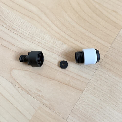

It just occurred to me that you could combine a Presta-to-Schrader adapter and a Shrader-to-Clik adapter with the Lezyne Clik hose to cover all three valve types. The adapters fit inside the bore of a Lezyne hand pump alongside the hose (depending on the size of the hand pump).

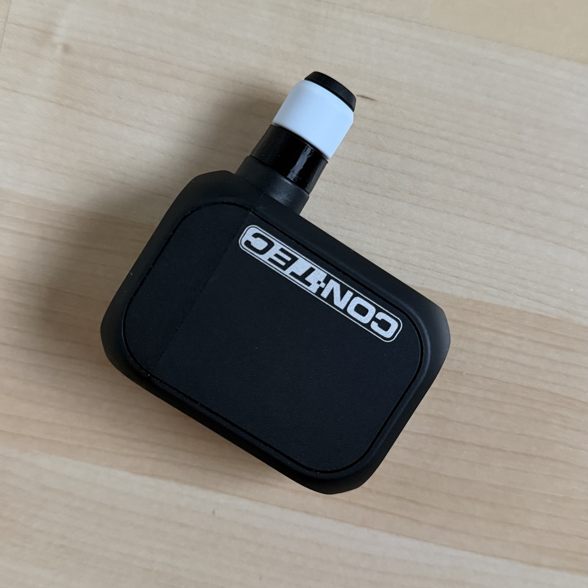

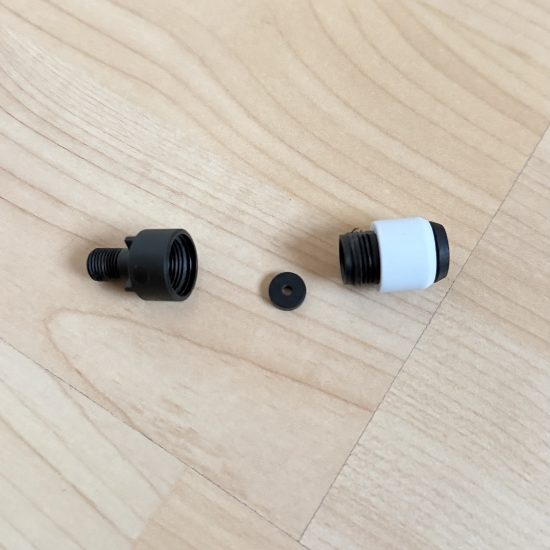

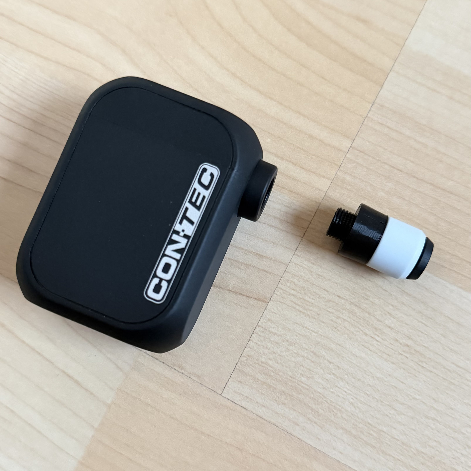

I made a simple adapter to use a Schwalbe/SKS Clik adapter on an electric pump. Many brands use the black extension tube (picture), if your pump uses this tube, this will work! This also keeps the Presta compatibility, simply unscrew it. Feel free to remix it to a different thread.
https://www.printables.com/model/1824297-clik-valve-adapter-for-electric-pump-contec-inflat
