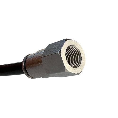

Get one of these-2pcs Car Tire Chuck Screw on Adapter Air Chuck Tire Inflator Compressor Connect | eBay or similar, google “screw on schrader chuck”. You can remove the existing chuck on your inflator, and screw in the clik. That’s how my similar inflator is set up.

I would have to recommend the extension kit, despite the duplication of bits you don’t need (neither do I). The head that comes with it is basically the exact thing you need to convert the old Presta/schrader head, and the slip collar for the plastic hose is very easy to disconnect.

The Universal connector does do the same thing but the free spinning 90° elbow is so much more convenient . :wink:
Thanks for the inputs, @McCookie. I’ve spoken with Byron before, and he’s been great with customer support. Looks like it’s the universal connector for me, since the Clik head is pretty much free rotating, once it’s Clik-ed onto the valve, and Fumpa’s hose is somewhat flexible, at 1m.
