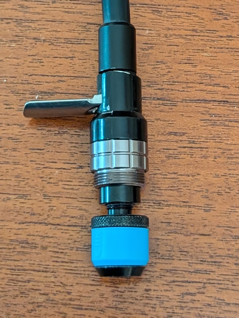

Schrader to Presta adapter + Clik adapter fail.
Silca Tattico style (different brand) pump + Clik adapter fail.
This is my first time using any sort of Schrader to Presta adapter. I tried it on two different pumps without success. Air gets released upstream into the hose and pump. On a floor pump, I could overcome the force but not with a mini-pump. Anyone else have luck with these?
The pictured mini-pump is the same as (or very similar to) the Silca Tattico. No luck with Clik adapter + the pump head in either the Schrader side or the Presta side + the valve adapter.
Good point - thanks for pointing out that the shop adapter doesn’t have the clik mechanism! I’d swear they’ve updated the description since I read it the first time. At least that’s my defence for missing it!
I had tested this combination before with a Silca Gravelero but double checked it a moment ago just to be safe. I used a Clik adapter in the schrader side of the chuck (with the lever locking it in) and it worked like a champ.
Just to be clear, are you using the brass adapters pictured or just the Clik adapter straight into the pump head?
I got some of those brass presta adapters too. That was in August so I can’t quite remember but I think I had to remove the internal bits to get them to work at all.
This particular pump refused to behave either way. The Clik adapter works fine in a couple of other Schrader pump heads I’ve tried.
  • Clik adapter → Schrader-Presta adapter → Presta side of pump
  • Clik adapter → Schrader side of pump

In the interest of science, I put a Clik pump head into the schrader side of my Tattico and tried it out.
It took a couple of tries to get it seated deep enough that it wouldn’t leak when I clicked it onto the valve stem, but it worked fine and I was able to bring a tire from 70 to 80 psi without issue.

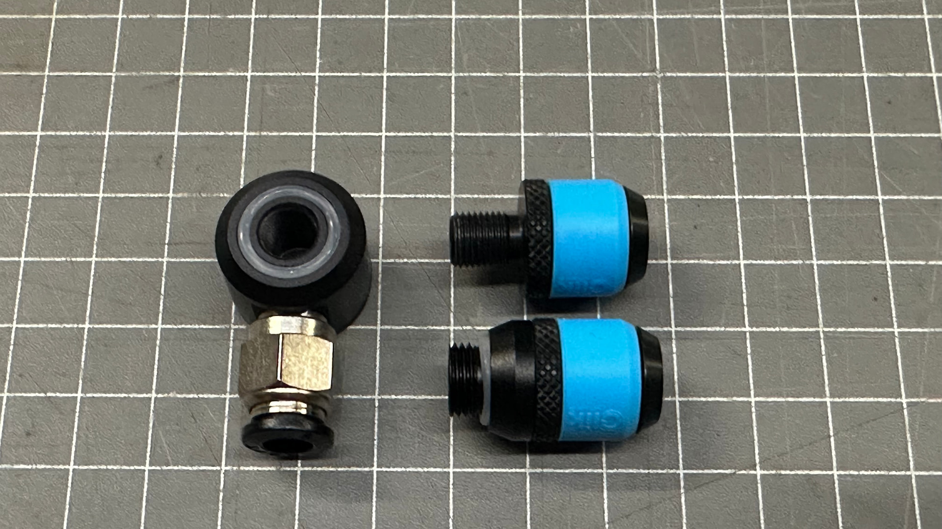

I bought a couple of Fumpa - clik adapters this week, including their extension nozzle, spare seals and universal connector.
I got the spare seals because I had intended forcing the standard schrader - clik adapter into the existing seal so it no longer sealed on a presta valve, but I probably won’t do that since I also got the other bits that make this unnecessary. Hopefully the pump will last so long we need new seals one day.
I was bemused to see that their Clik head for Fumpa pumps is just the standard schrader adapter with a custom thread adapter screwed on the schrader thread.
Jeez I wish they’d just sell that thread adapter ring on its own! not that it’s a big deal to buy the clik adapter with that ring on it but I dunno why they can’t explain this up front.
Likewise the extension nozzle is not bad value but I don’t need another 2 elbows and hose - I just wanted the head that I can swap with my existing elbow nozzle. So now I’ve got enough spares for several fumpas, until they change their standard threads. :clown_face:
I also got them to confirm what the thread is that they use in their pumps, because I wish it was easier to use generic bits and easily convert between valve heads. The straight click head is a 1/8”BSPP thread which is a standard pneumatic component thread. (as if there’s such a thing as one standard!).
