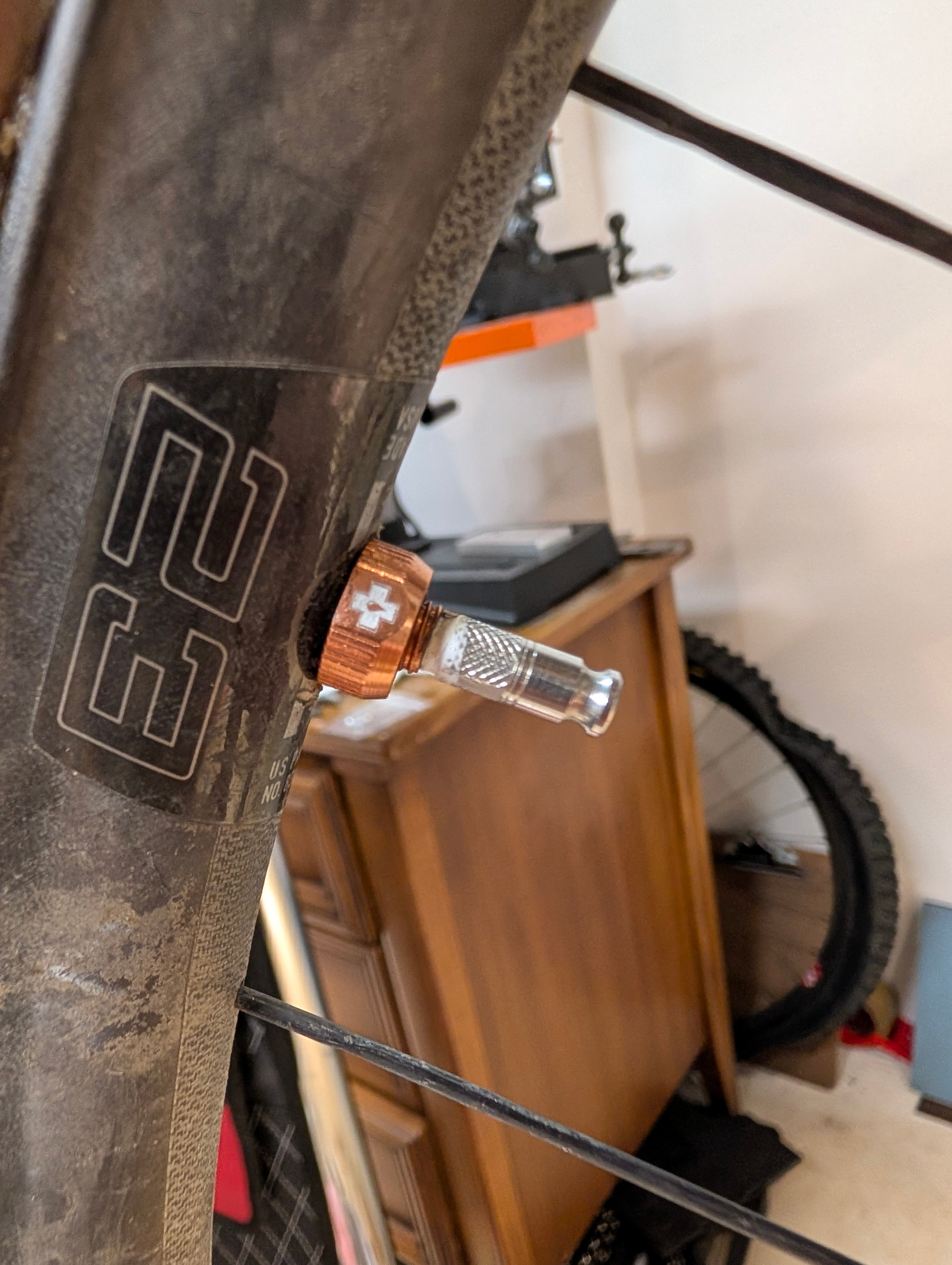

This is my valve stem (muc off) that I cut to length and re-threaded for the clik core. The tap is a 3/16-40 Model Tapered Thread that model railroad hobbyists use (info. from Click)

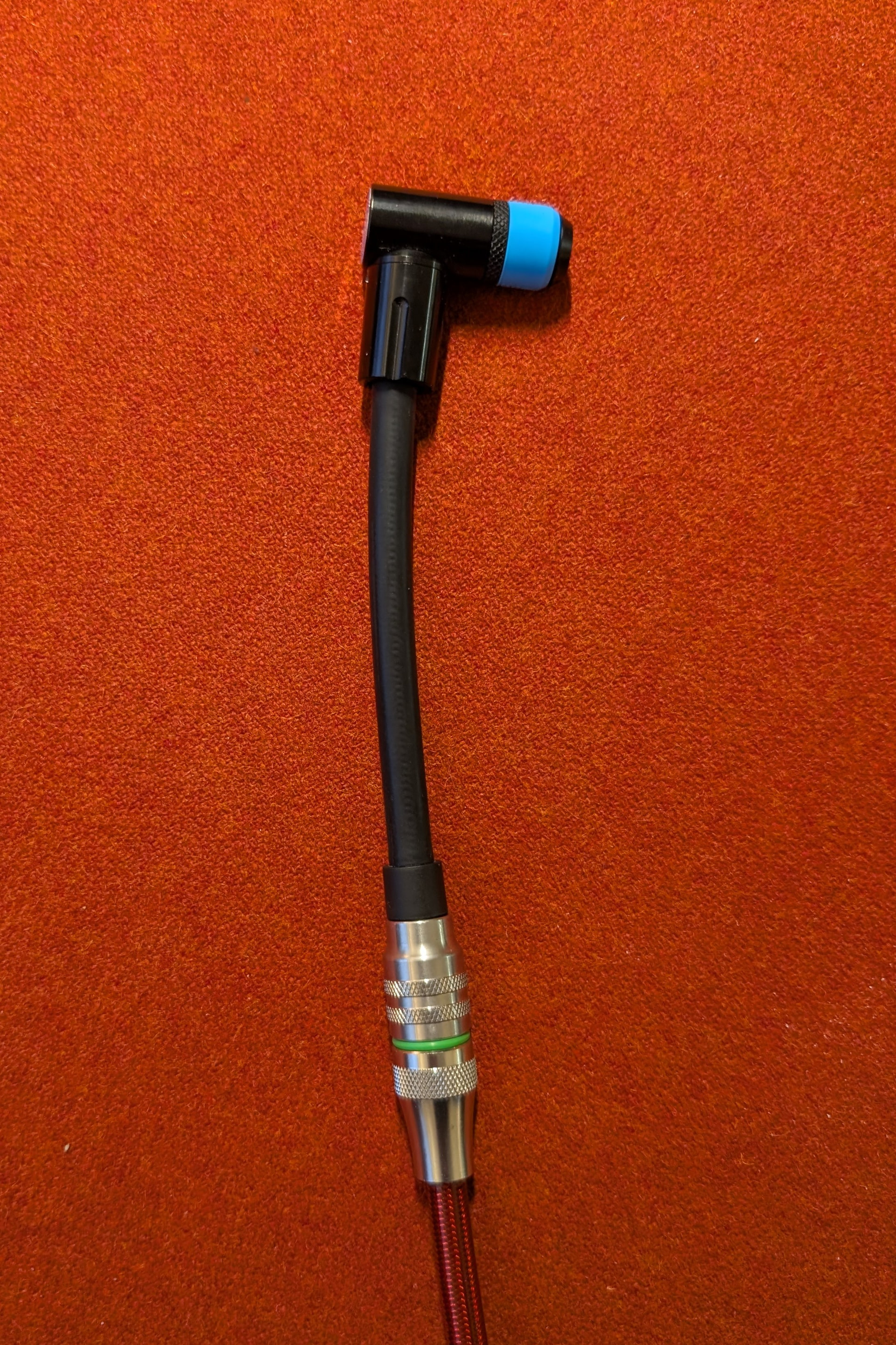

I picked up a schrader extension hose (VG8 thread), cut the end off and used it to attach a Clik right angle pump head to my SILCA floor pump.
I think Clik should consider selling something like this, as their current target market probably has higher quality floor pumps and don’t want to cut their pump hose to attach the right angle pump head.

I’m curious what advantage your extension hose has over the basic clik adapter screwed into your floor pump head?

I’ve had this pump for 10+ years and before that, a couple of Joe Blow pumps spread out over another 10+ years and they’ve all had right angle pump heads, so part of it is familiarity, but I also find a right angle pump head is easier to use, clicking directly onto the valve stem, with no manoeuvering of the hose in spoke/cassette area.
Regarding the Clik pump head, it uses the standard thread for screw on floor pump heads, so makes sense that they designed it this way.
I would imagine they’re having reliability issues with a Clik pump head that will clamp into an existing presta pump head, as the clamp area would have to be similar to a valve stem, thin walled and small diameter, easily broken.

This uses a similar barb style shaft as the right angle pump head, which uses a screw on sleeve to reinforce the hose junction area, hard to tell looking at the pictures if it’s a similar diameter, but the shop pump head doesn’t have the Clik mechanism, which is really the magic of the system.

Oh, yes. I forgot that the shop head doesn’t have the Clik mechanism. I agree too that that is the secret sauce.
