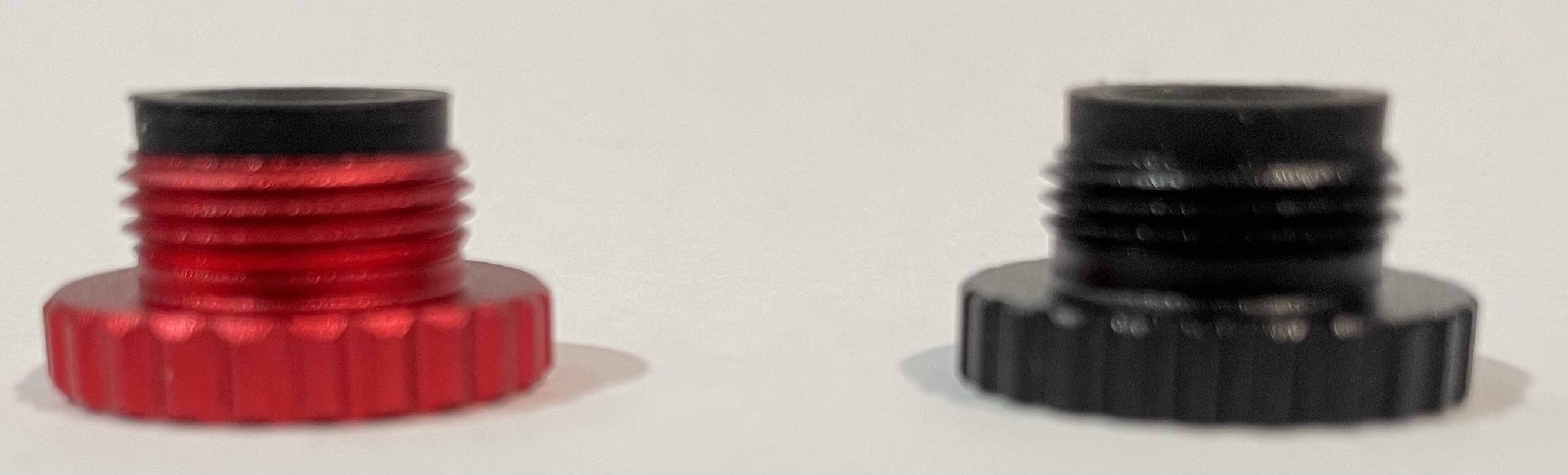

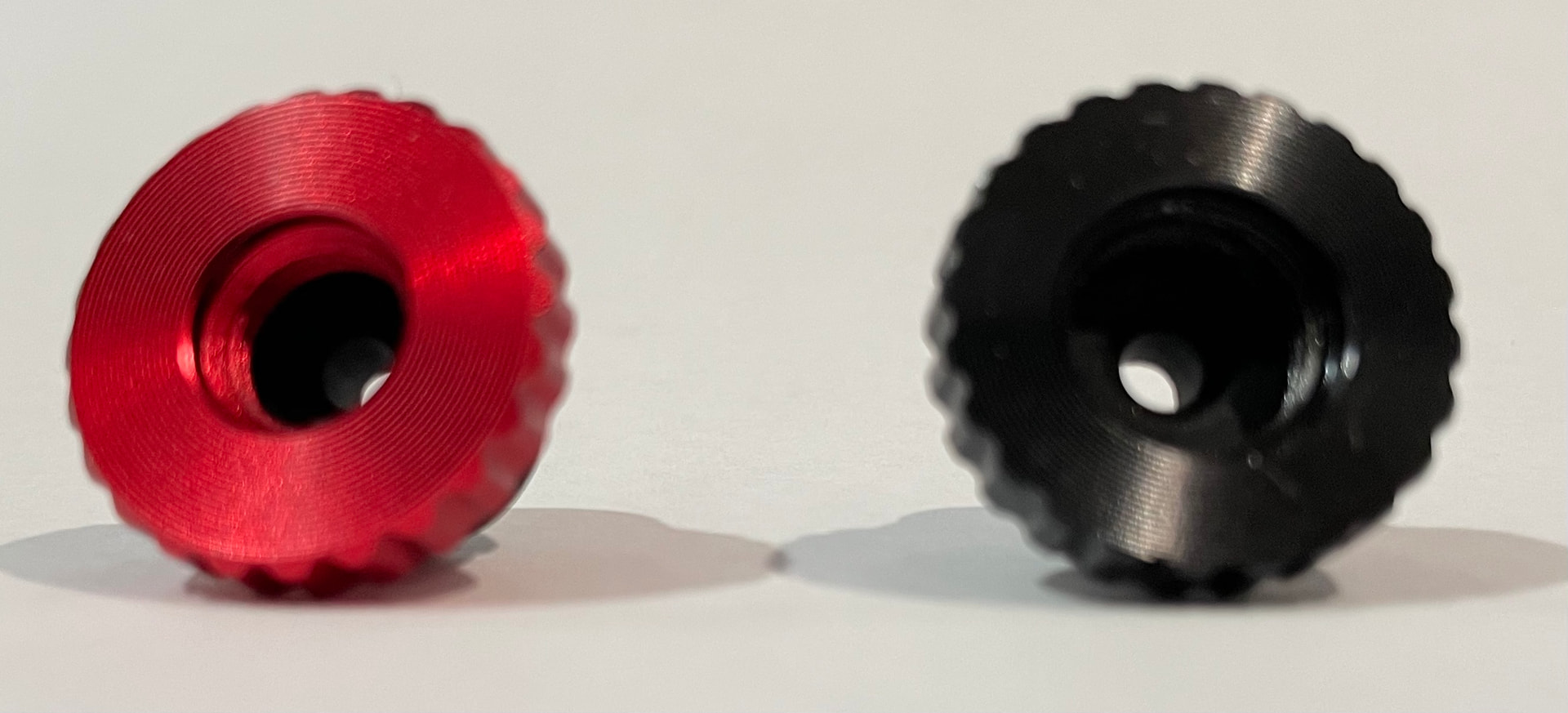

Is it possible to see a photo of the red ring on its own? I assume it’s a schrader thread? I wonder if silca sell it as a spare. Looks like the main benefit of the silca pump over the cycplus
Sorry my pictures are crap, but here they are. The part is identical to the Cycplus, it’s just the inner threads are different and fit the clik adapter. I really wish Silca has put a gauge on theirs, that’s really why I carry/use the Cycplus over the Silca. If Silca does sell that as a spare part please let us know!
Thanks, this is really useful. I’ll email Silca and see if they’ll sell me one. I wonder if Cycplus will change to this or they’ve got a deal with Silca preventing it?
