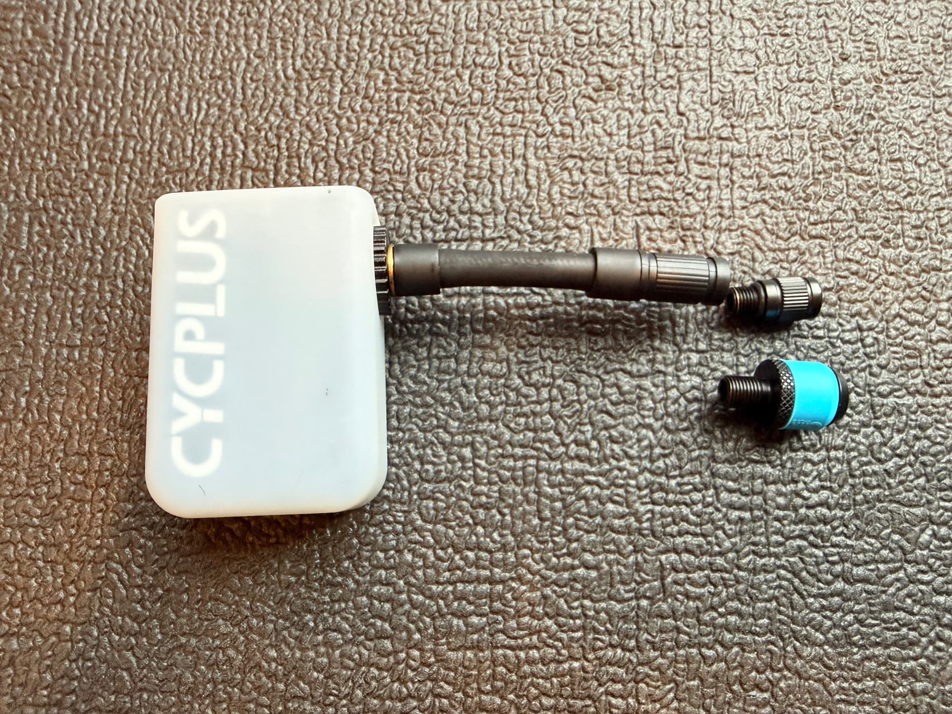

I did another test using the same GP4000 II tires (700x25c) but this time with the tiny Cycplus AS2 Ultra. The AS2 Ultra allows me to set a target tire pressure, unlike the OG Fumpa. It took 1 minute 24 seconds to inflate the wheel with the Presta valve to 90 PSI. I then fully charged the AS2 Ultra and repeated the test on the wheel with the Clik valve: 1 minute 17 seconds.

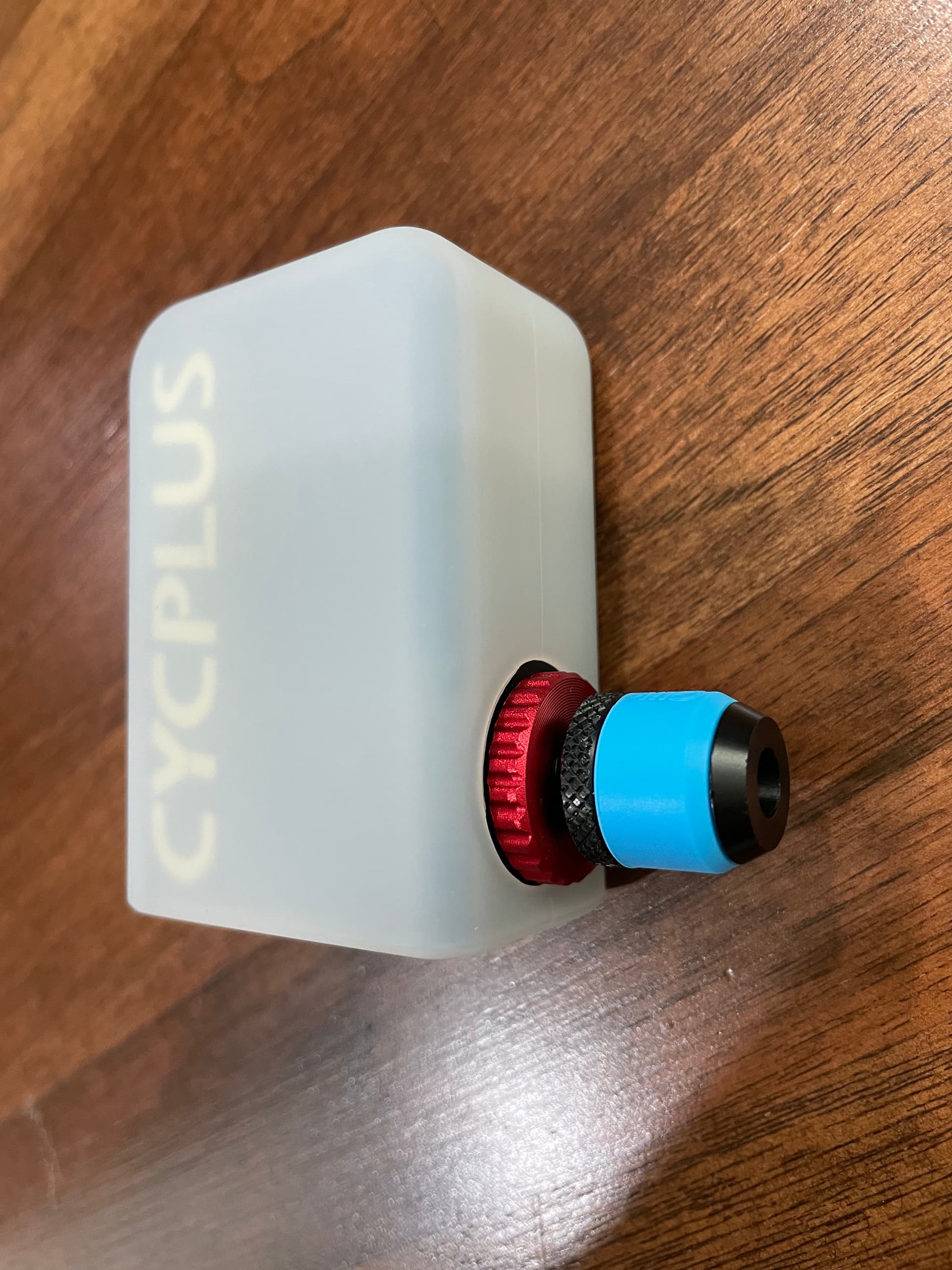

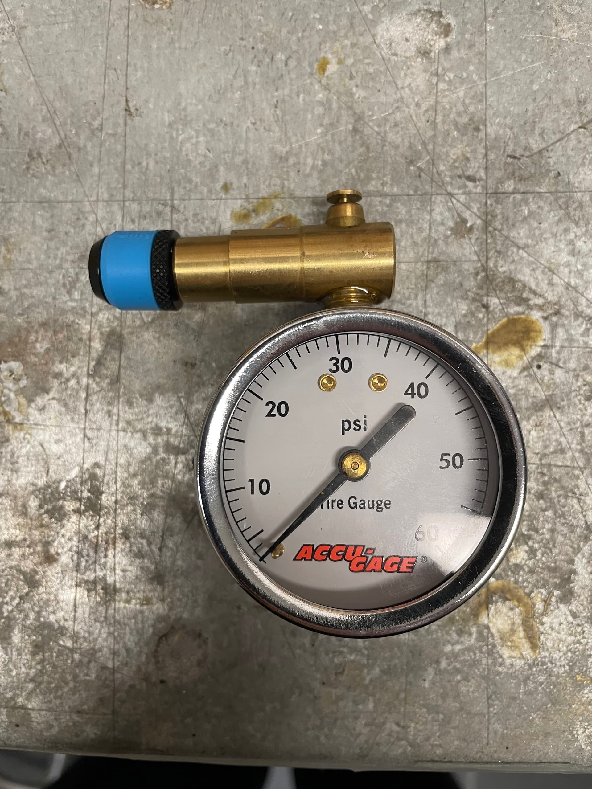

Big Clik fan! It’s just a better valve. For the Cycplus AS2 Ultra, I pulled the little red ring (in the picture) off the Silca electric inflator, to be able to screw in the Clik adapter directly without the hose. It makes for a nice compact system. Also, I tapped (not quite square, I was doing it in a hurry) the inside of my AccuGage to screw in an adapter for an analog gauge. The little digital gauge from Clik (made by Fumpa) also works great for on the go.

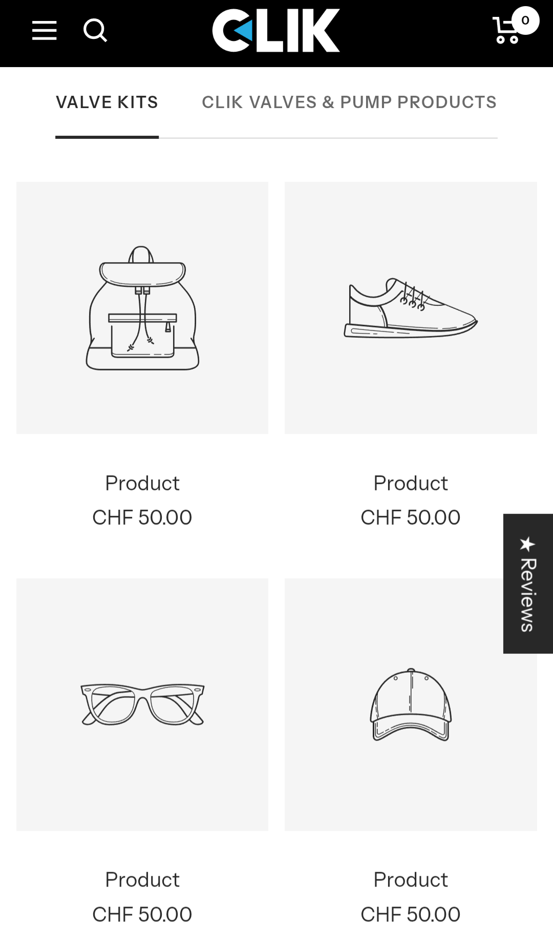

Does anyone know if the Clik Valve website is legit? https://clikvalve.com/
I know this sounds crazy but I have to question when the website has text that was either written by a non-english speaker or is straight up AI. It also just looks messy and unfinished.
My partner is really excited about Clik Valves and wants to convert all of our bikes right away. I was hoping to find colored valve caps to match our existing Muc-off valves.
That is the correct URL for the Click Valve websiite, but the screenshot you shared looks different from what I am seeing here in the US. Here are cap covers: Clik Valve Quik Dust Caps (Set of 4) - Aluminum Clik-On / Pull-Off Cap
