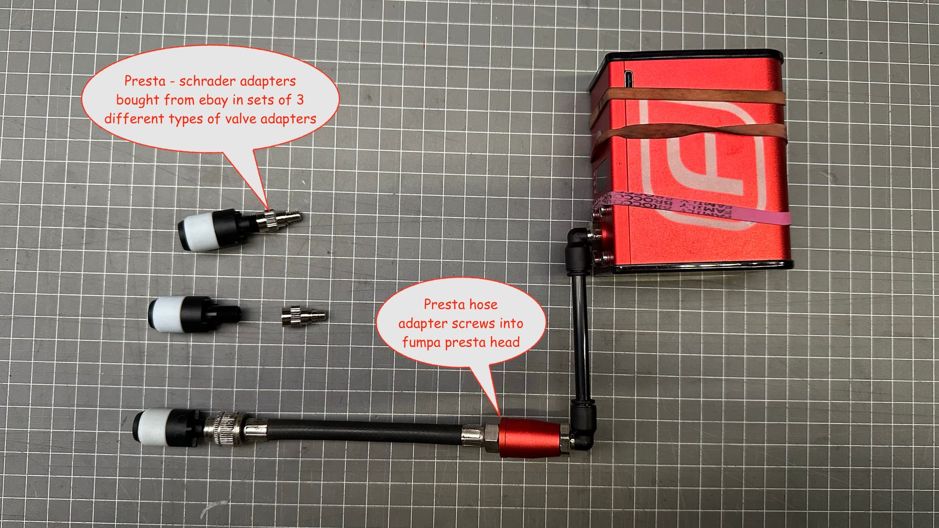

How are you attaching the Clik pump head adapter to the Fumpa elbow nozzle kit?
That’s what the shock pump hose is for - it has a presta valve sized inlet connection so I can just push/thread that into the Fumpa presta head as it is in the photo.
I also just received my eBay presta-Schrader adapters so I can now do the same thing with a simple 10mm long adapter.
I’ll add photos later.

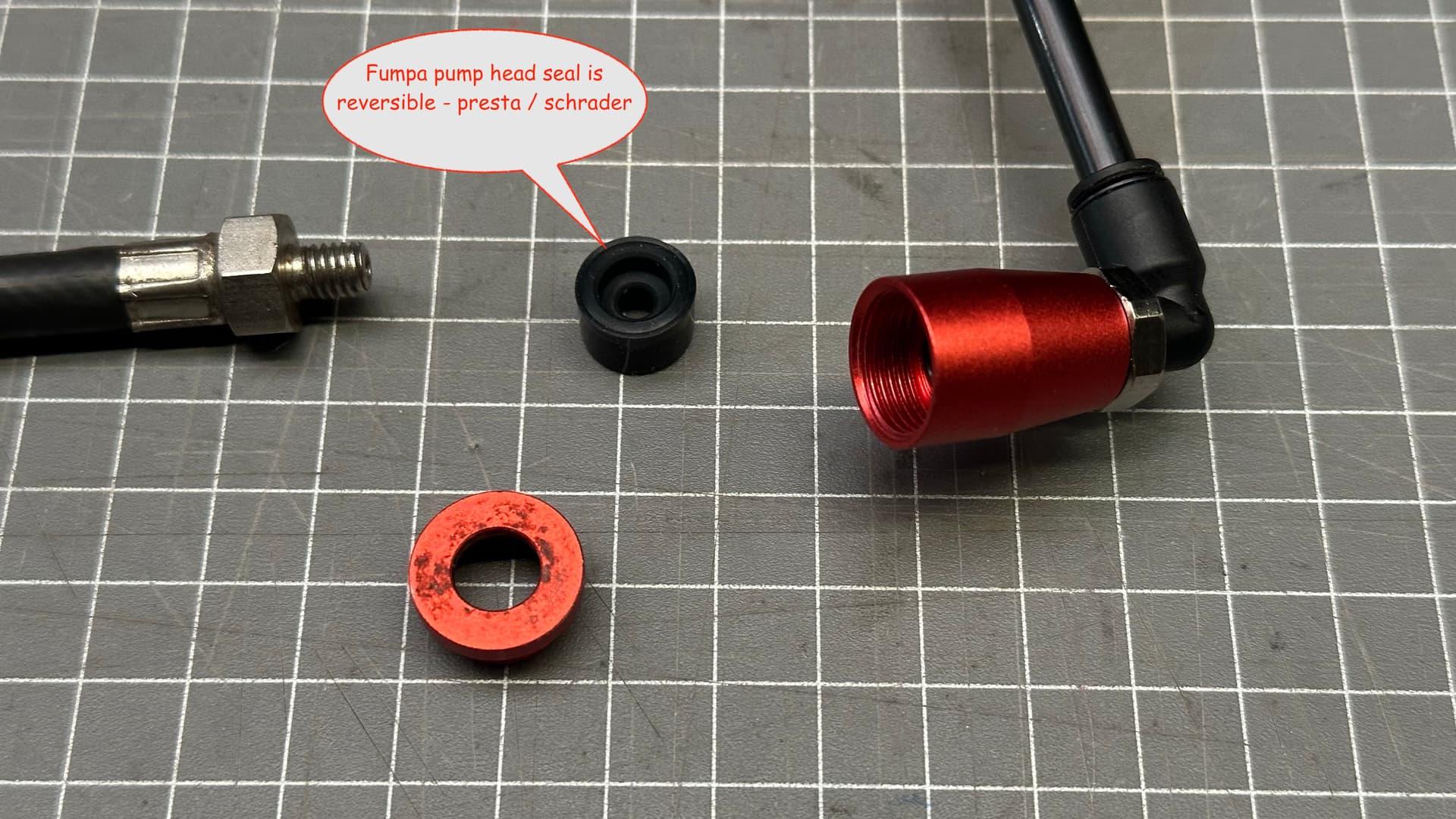

I hope the photos below will help show what I’m talking about.
I bought our fumpa with the hose adapter as well as the standard direct mount head.
Both of the fumpa heads have reversible seals with schrader sized holes in one size and presta in the other (and a reversible plastic pin for the schrader valve).
I figured I’d rather just use a presta adapter in the presta head instead of having to pull the head apart each time I used it on differenent valves, hence I now have a choice of presta adapters and I’ll buy the presta version of the clik pump head when they are released.
I actually prefer to thread the presta adapters into the rubber seals, rather than just push, because I think that will chew the rubber less and thereby prolong the life of the seal.
The fumpa head and elbow use a quick connect hose coupling that slides on to the plain plastic hose and then you have to press the collar to release the hose if you want to disconnect it. The coupling is like the John Guest plumbing couplings shown in this video… https://youtu.be/1tZRIXCzgZE
