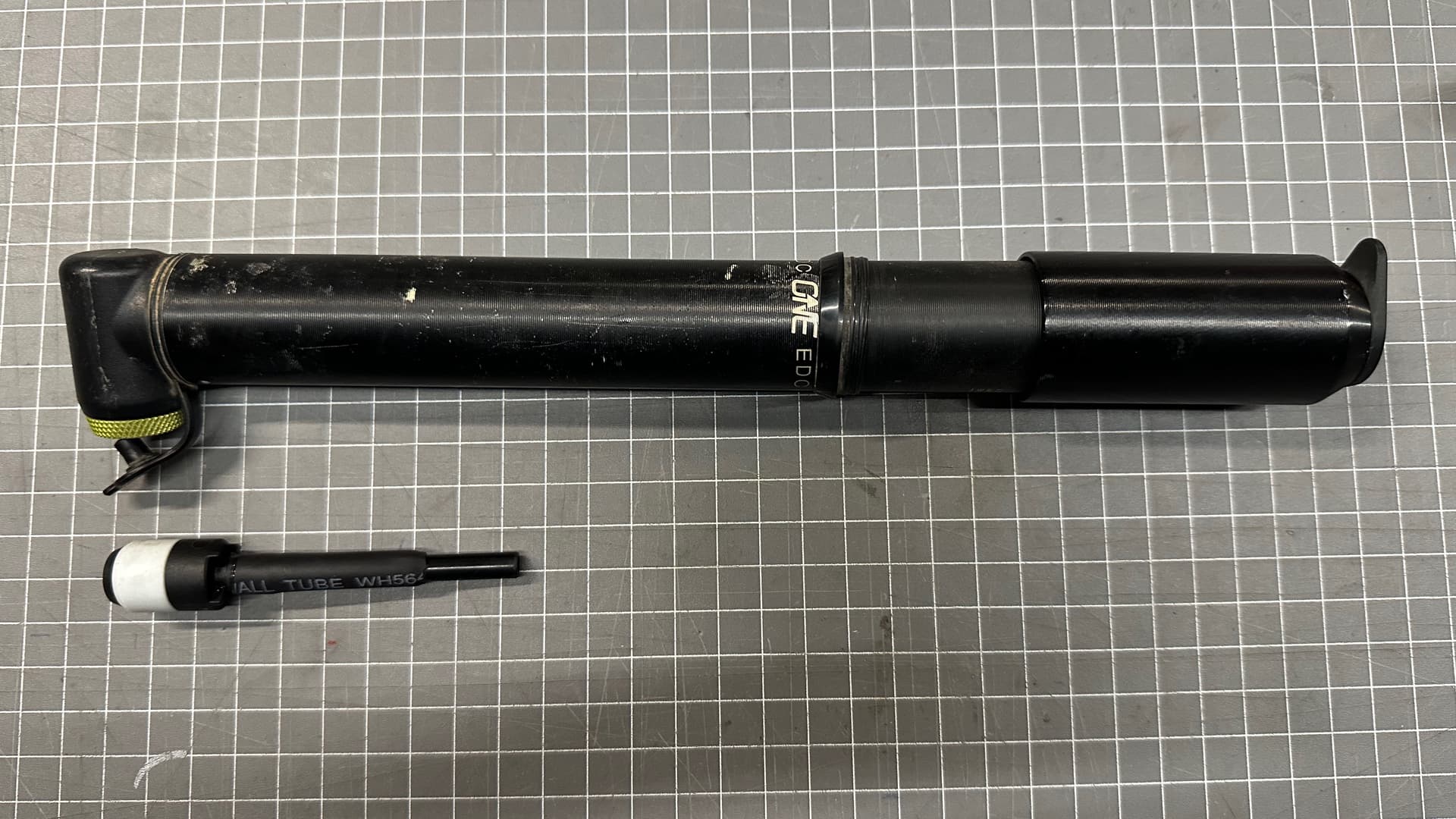

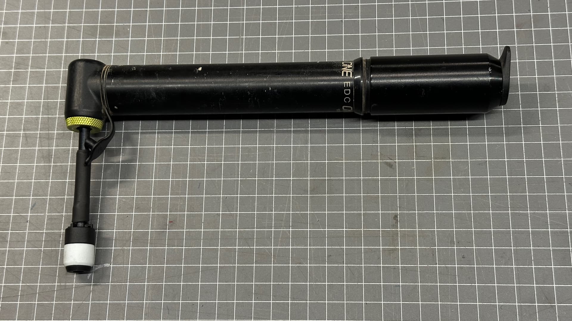

I made an emergency adapter using a spare fumpa tube and heatshrinkq tube, so Hels can actually pump up her tyres with her OneUp pump. It actually works but its awkward

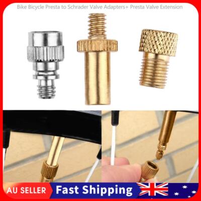

Having made that I then found some metal schrader valve to presta pump adapters thanks to a thread in reddit.
Unsurprisingly when searching for these I get 999 suggestions for presta valve to schrader pump, but these sets with both varieties are scattered amongst the ones I don’t want.
I got mine from EBay but the reddit thread had them on amazon. Some sellers offer them for $3 or so, then hit you for $12 postage! Thankfully I was paying attention and cancelled that purchase!

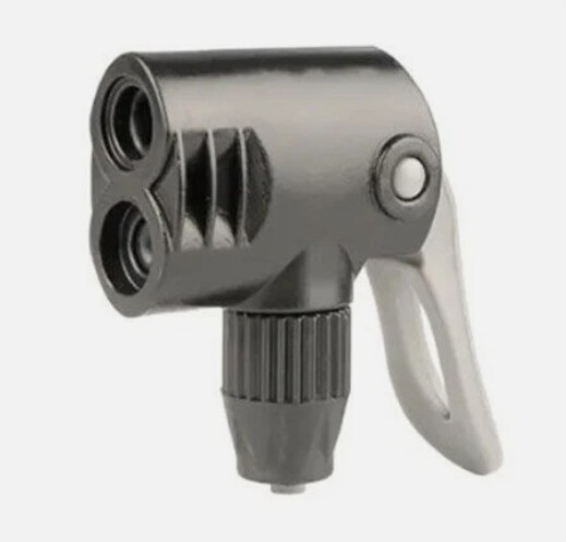

If it’s any use, I have put one of these Schrader and presta double heads on my electric inflator (big ryobi unit, not a fumpa style one) and the Clik adapter is permanently in the Schrader hole so it can do both clik and presta without any changes. Been using that for a month or so and works very nicely
Can you still use the presta connection with the clik adapter in the schrader hole? I’d have thought they were too close together?

it does work, there’s enough room between them. If you had short presta stems it would be a problem but not an issue for my stems

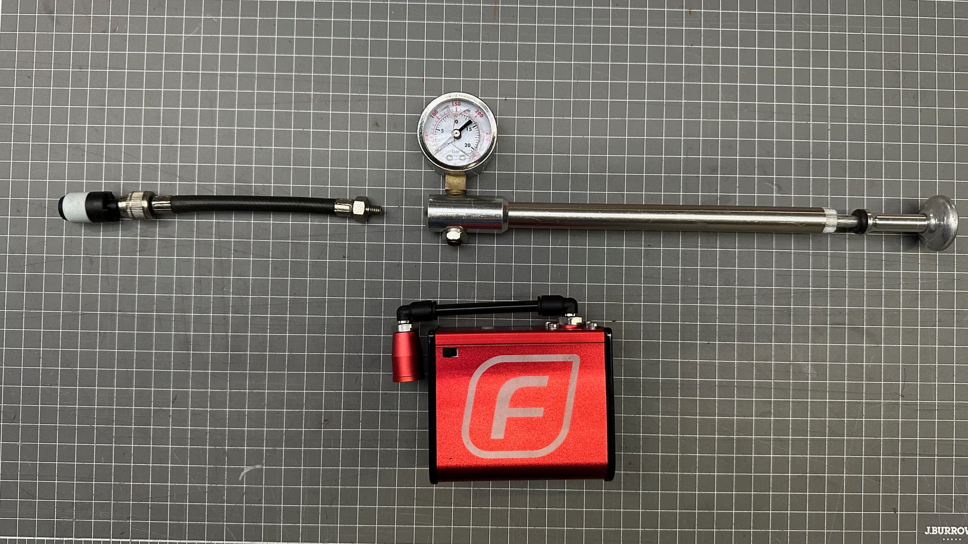

Having scoured the internet for a hose to connect a presta pump to schrader valves, and visiting the four local bike shops to no avail, I found the perfect hose on one of our generic shock pumps. A total fluke, since it’s the only shock pump we have that the hose can be removed, and the pump is unbranded so I have no idea if I could get another one if I wanted to. Luckily we have several other better shock pumps.
This hose works with the Fumpa presta head and also screws into our Topeak pressure gauge so that can read the correct pressure via the clik adapter

This is actually fairly simple to hack - I just took the tube out of our Fumpa pump and that pushes into the mouth of the clik pump head and seems to seal ok. So that would work with the Fumpa presta head on the other end, or with another slightly larger tube to go over the presta valve if you didn’t want to carry the fumpa head.

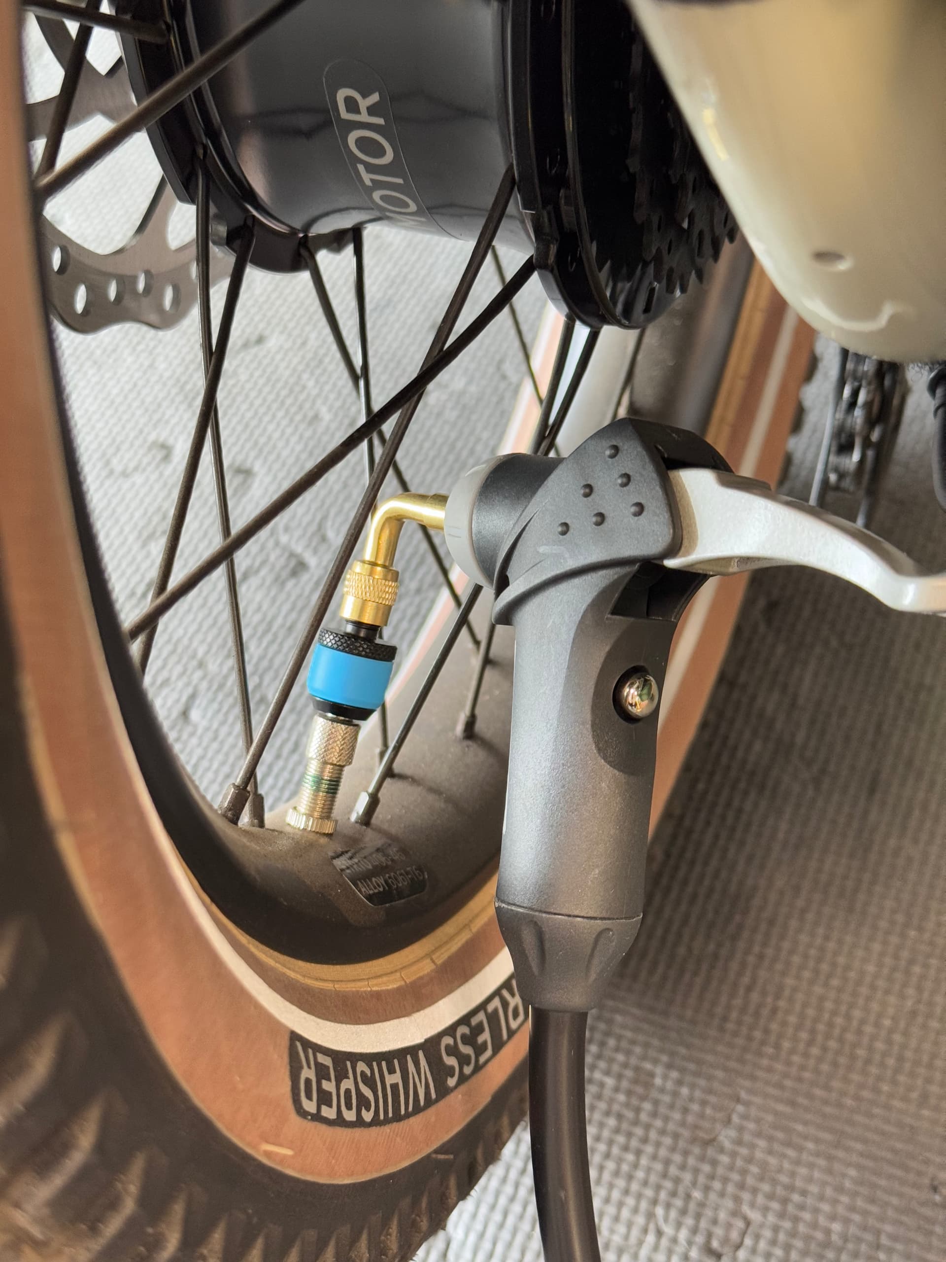

Schrader to Clik valve adapter (works like a valve cap) + Clik adapter for Schrader pump head + 90° Schrader adapter :smiling_face_with_sunglasses:
