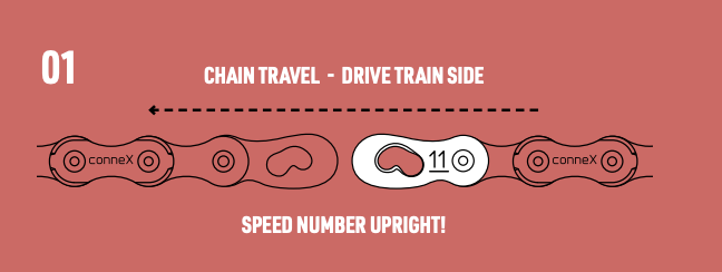

Plus 1 for Connex, those are great!
Remeber they are directional though. They work fine for the most part backwards but will skip like crazy in 11t of the cassette.
I’d like to hope I’d remember but that note has probably saved me some hassle if I’m honest :slight_smile:

For the Connex link, which works great for 12s Shimano, I’m always forgetting the link direction. Install with the speed number upright as you install at the bottom of the chain. Also the pointy part always points inward
I try to picture the slight curve of the link should follow the round shape of the cassette as it goes around.
