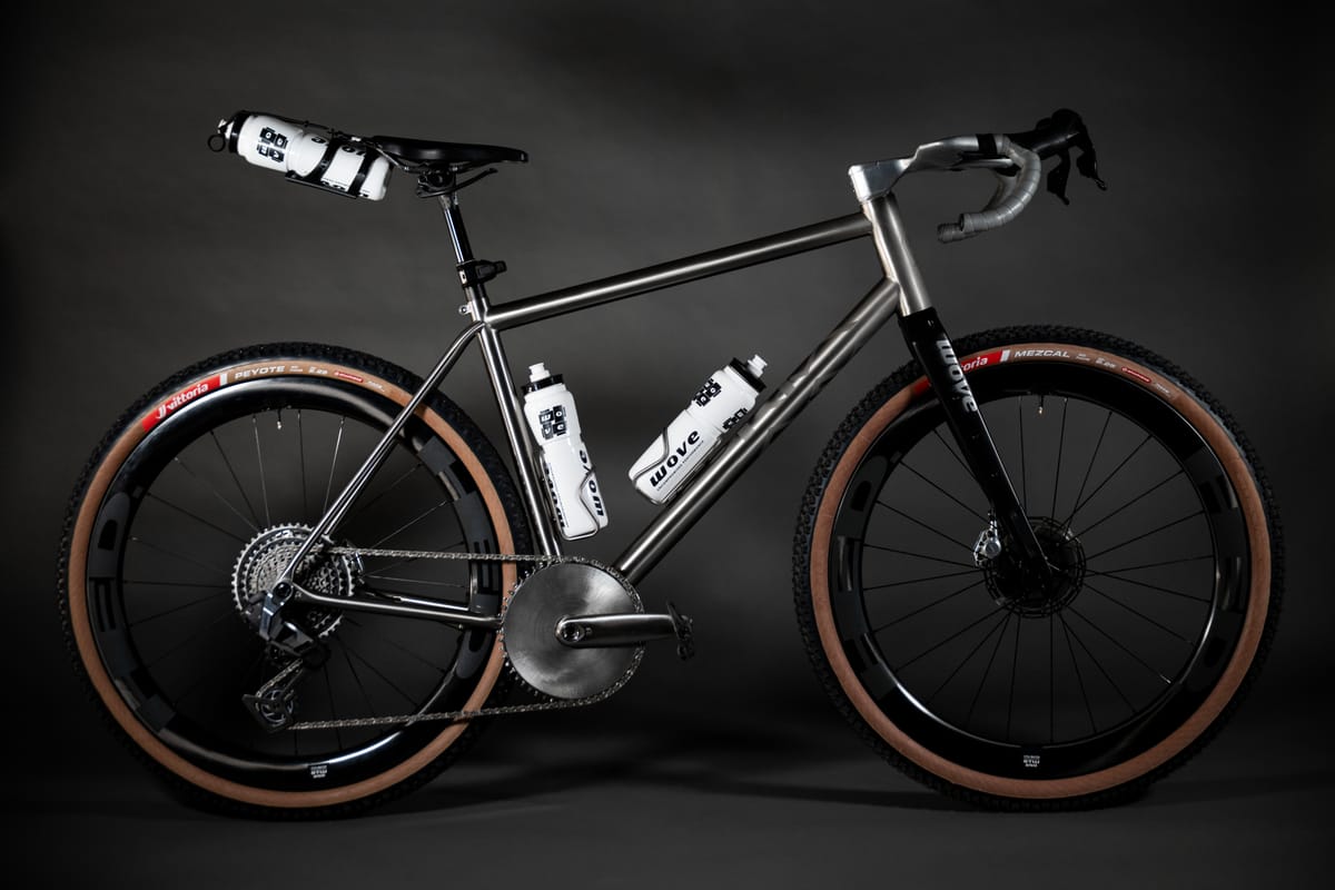

I’m currently trying to figure out what progressive gravel geometry should look like so the bike will handle okay everywhere, maybe a lost cause. My guess is it needs to be somewhere between progressive road and MTB geometries, but just where is a can of worms.
