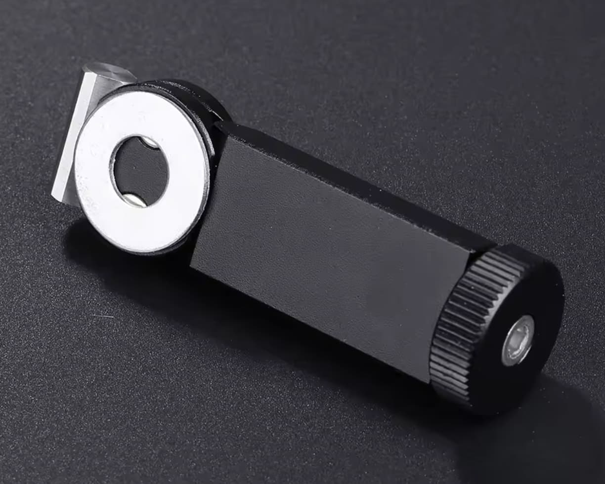

I have the second one in use (the one with the round washers), mostly with Shimano Road brakes, and I am quite happy with it. I have seen that they also make a version with more squared surfaces for MTB (?), but no first-hand experience there.

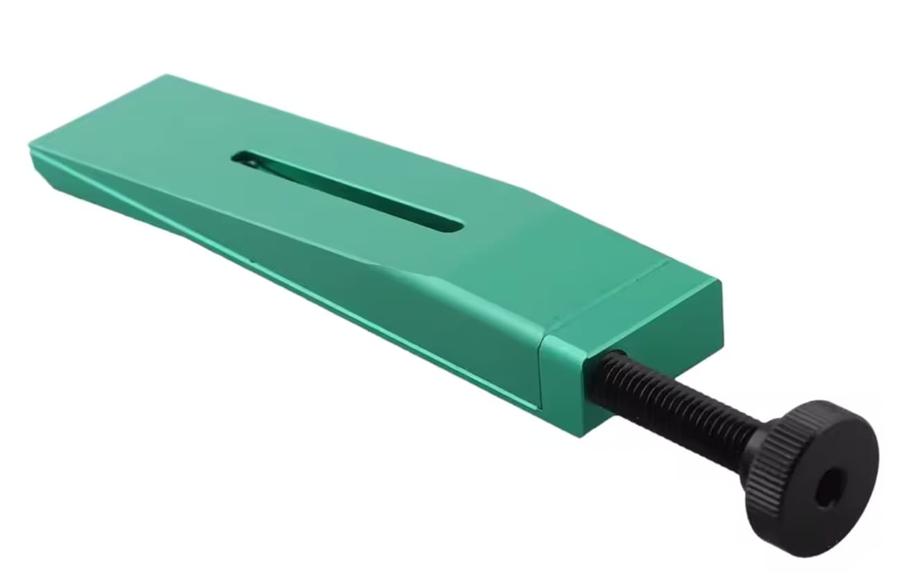

I’ve got that green one - which I got for a substantial cost savings over the SRAM original. It was a debate for me as well, between both options up there. I went for the green one, because the black one relies on magnets to hold both opposing pieces (where the washers are) together. The rationale being that once the pads have been spread, there’s really only minimal tension holding the opposing pieces in place, which would likely fall right off. That, and the fact that the device is a little shorter, which might make usage a little less convenient.
The green one, is a little longer and I’ve found that the knob at the end is more easily accessible, and made largely of aluminium bits that would be less prone to rusting. The downside, is that the sliding piece can be wholly unscrewed/detached from the black knob at the end of its travel, but shouldn’t pose any problems in normal usage, since you’d rarely need the slider to be in that position anyway.

I had the green one, it’s fine though unfortunately broke on some particularly stiff pistons! I would say it’s ok if you are careful in those circumstances. There is also a narrower blue one that’s more suited Shimano. I have that also and it’s still working.

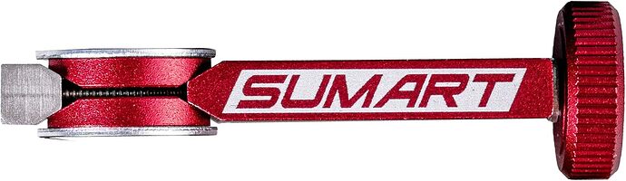

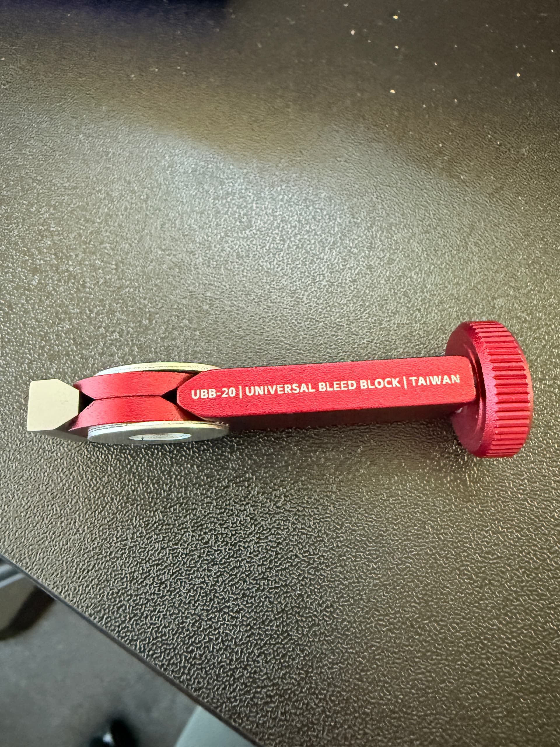

I have the bottom one made by Sumart after seeing it mentioned by @Dave_Rome.

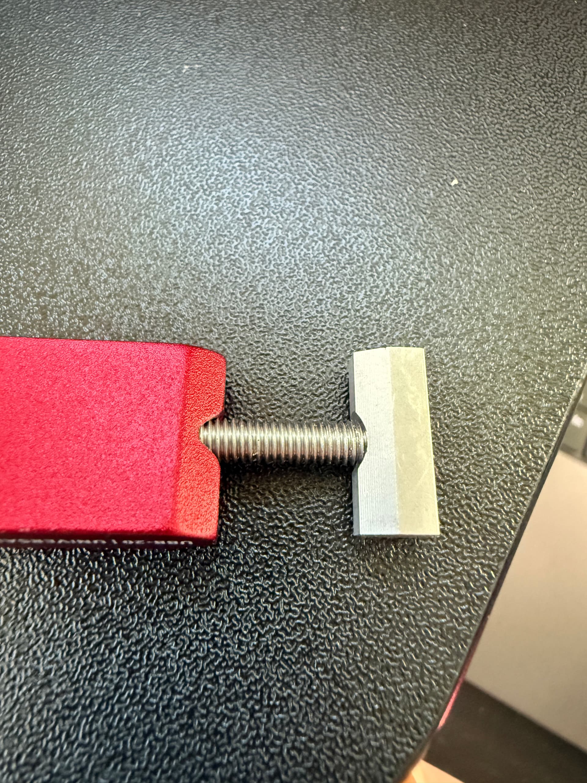

I don’t know if Sumart version is the original. In general, it works really well on my Shimano and SRAM road brake calipers. The only issue I encountered was on my second use, the dial got stuck and forcing it to rotate stripped bits of the bolt. It’s still usable though.
I have the green one with a different handle. It’s great! The only downside is it doesn’t necessarily fit all brakes (although most if not all two piston brakes will be ok), therefore usage on some four piston brakes is not ideal (pushing apart two pistons fully and two pistons partially at a time) or straight impossible.

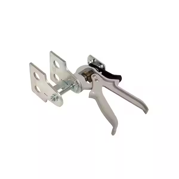

I’ve never quite understood why noone makes a pliers-type retractor tool, I remember seeing them on the race car scene years ago. Something like this (but the race car ones had much longer lever arms). Basically a reverse-knipex plier.
