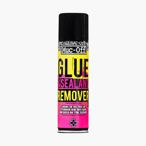

Doesn’t Muc Off only make products that clean other Muc Off products?
It does! It’s listed as out of stock on its UK site and it’s not available at all on its US site.
