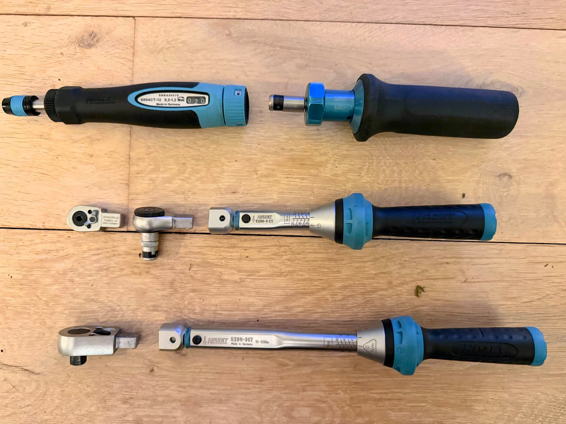

I like the Hazet torque wrenches (own four of them for a complete range), this is the 10-60 Nm version which fits insert tools, so also suited for left and right handed thread fasteners:

No, it does not. I use a Hazet 3/8” ratchet insert
Einsteck-Hebelumschaltknarre 3/8" 9x12mm HAZET
Not the cheapest solution in combination but very nice. Cheaper solutions/brands can be good enough too though. The Hazet one is still relatively compact and just the right range for me.

As per purpose of the tool inserts, you can insert various tools :wink: Mostly for direct use with a spanner wrench insert in the required size (not as I use it on the bike, but it could be), but also useful for reversing a ratchet insert so it can be used for left and right handed thread (how I use it).
Note that if you use an insert, you have to watch out for the “working length” of said insert. The torque wrench is calibrated with a certain length. When using “longer” or “shorter” inserts than this, it requires some calculations to maintain proper torque (it then differs from the set torque). All this need not apply if you use a ratchet insert with the proper length, as is the one I mentioned in a previous post for the Hazet 10-60 Nm wrench.
Here a full range for bike use can be seen:
0,2 - 1,2 Nm (RHT only)
1 - 6 Nm (RHT only)
2,5 - 25 Nm (insert, RHT+LHT)
10 - 60 Nm (insert, RHT+LHT)
For the 2,5 - 25 Hazet wrench I also have a Stahlwille insert that accepts 1/4” bits directly and is very thin, so it can be used in tight spots.

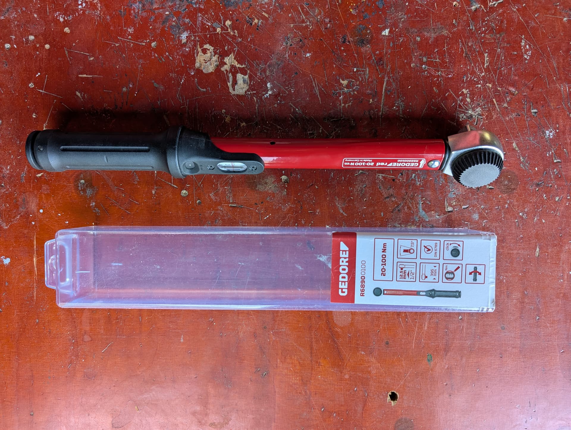

For bottom bracket-ish torque levels I use this Gedore 20-100Nm. It’s a ratchet style wrench with flippable head so you can use it both clockwise and counterclockwise. Solid tool - 1/2” though.
