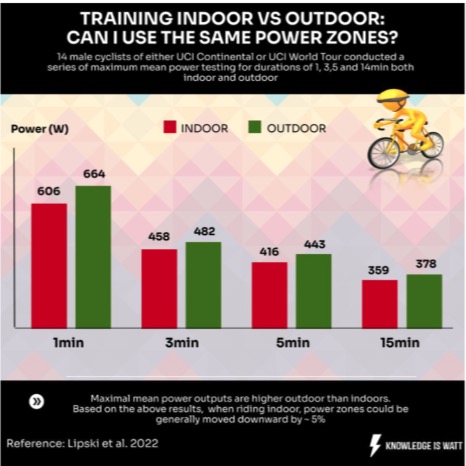

Why is indoor training harder than outdoor?
I came across this infographic that illustrates a small study that confirms what many of us perceive: Indoor training is harder than outdoor training.
I’m curious of anyone can comment on why this is (I personally don’t think it’s a mental thing, but could be wrong). Do you have experience with this topic Jonathan_Baker or anyone else here?

Just putting my scientist hat on, the first thing I thought of was “where are the error bars and were these differences statistically significant?”.
The absence of such data makes me think the differences are not “significant” and so my response is, there’s nothing to discuss apart from sloppy data gathering.
EDIT: Found the original article. Paper is behind a pay wall, so hard to tell but the abstract states:
Across all maximum mean power test durations, the trimmed mean power was higher outdoors compared with indoor testing (P < .05).
So we can say results were statistically significant.
