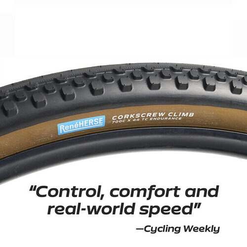

Easy. Rene Herse Corkscrew climb semi-slick. I’ve ridden every G-One offering and they ride well, but not as smooth and fast as the Herse. Maybe it’s the casing…. Also the G-Ones wear out so, so quickly. for an $85 tire I would expect more life.
The semi-slick is a perfect option. Great rolling on the road. Also enough bite on the gravel. I’ve ridden A LOT of tires – maxis ramblers (great for the $), G-Ones, specialized pathfinders, other Rene Herse options – and the Corkscrew Climb semi-slicks take the cake.

Just for interesting reading, you might want to take a look at the Rene Herse guide to choosing gravel tires. They just published the 2026 edition. Not an ad for them, although I do enjoy their tires.
Great tires, terrible company. Buyer beware. They will not stand behind their product if you have an issue or encounter a manufacturing defect.
Huh. They’ve replaced stuff for me, so I don’t have any way to know why our experiences differed. Sorry you had a bad one.
