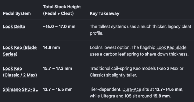

Less difference than I expected. Based on a quick Google AI query, Look Delta system’s stack height is barely more than SPD-SL (non-Dura-Ace tier) and Look Keo (non-Blade series). I’m skeptical that stack height has significant pedaling-efficiency gains, and the differences here are small enough that I’d be surprised if there’s a measurable effect on biomechanical tracking from stack height itself.
Significant stack height gains can have aero impact by lowering the rider, but I’m not very aero on the bike anyway. Maybe there’s more to gain by cornering clearance, but I’m mostly riding the frames (and BB heights) that I already have, usually with wider tires, albeit wider-stance with pedal washers and also 180mm cranks. But I’m not maxing my pedaling-through-corners anyway.

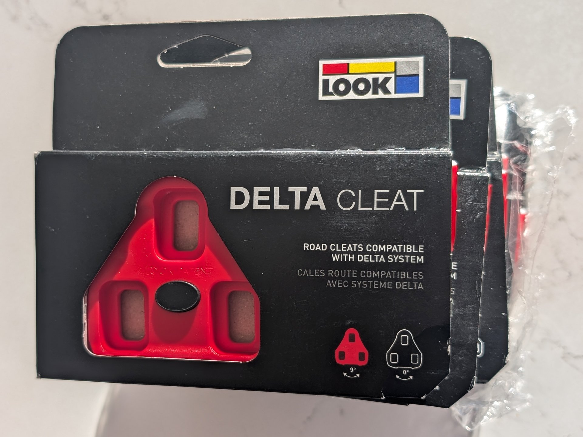

SPD-SL cleats are designed to be more durable (and less slippy) while walking than the only-plastic red Look cleats I use. I’ve always carried cleat covers on rides for my safety and cleat durability when walking around. A bit more pfaff, but my cleats are plenty durable.

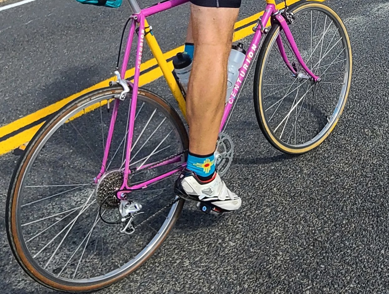

Adding the best pic I have of Look pedals + visible cleats. This is the build that snuck through two Eroica events by looking mostly-properly-vintage. The frame is has somewhat more modern components now.
